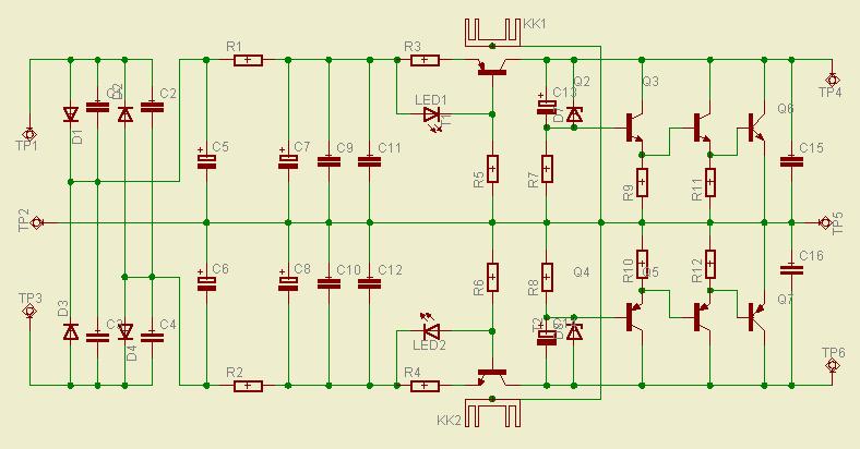

john curl said:I don't like high feedback regulators applied DIRECTLY to amplifier stages. I always use an open loop cap multiplier equivalent buffer between the IC power reg and the amp stage. I didn't know this 35 years ago, when I designed the JC-2, I just 'lucked' into it, when buffering studio board stages from each other. That is how the Wilson Audio master tape recorder electronics were designed, and the Crystal Clear studio board, among other projects. Please consider that I use vinyl records made from these companies among my reference sources, just to have a more complete chain of high quality electronics from source to speaker.
These 'suggestions' much like: "Eat an apple a day, and keep the doctor away" are learned by experience and often by accident, and are often scoffed at by the 'typical scientists' of the time period. In this case, some engineers on this thread.
Hi John,
For all we know, you might be right. But the interesting question would then be why? I think it is a fascinating question, but I don't think I have heard an answer to the "why" that makes sense.
Bob
Bob Cordell said:Obviously, it is possible for someone to screw up the design of a high-feedback regulator, but I am assuming that we are talking about competently well-engineered examples of both here.
This is an interesting point. My view of what might be going on is mostly speculation, but here goes anyway...
Some regulators such as Walt's "super reg" topology are more difficult to get right than a simple EF/capacitance multiplier. Depending on the op-amp used, their unity loop gain freq might be 3-10 MHz. So they can easily oscillate with a load capacitor having a very low ESR. Suppose somebody builds one and determines that it oscillates with a 0.1uF cap directly at the output. They remove the cap and all is well. Is this the end of the story? No, because they or someone else may hook up this reg with very short leads or traces to a bunch of op-amps or discrete circuits, each having, say, a 0.1uF cap for bypassing. Is the lead length or trace length enough to keep the reg not only stable, but also maintain good transient response of the reg (as John mentioned above)? Maybe yes, maybe no. One way out of this it to put something like 0.22 Ohm resistors in series with the bypass caps, but how many people do this?

john curl said:Transient response?
Yes, in a poorly-designed NFB regulator.
But you would expect to see the results of bad transient response of the regulator on the regulated lines. For example, bad regulator transient response might cause certain HF voltage changes on the input side to fly through to the output side. One would expect to see that on the regulated rails. Moreover, one can test that in the lab by deliberately putting disturbances on the input side and seeing what happens to the output side.
Similarly, bad transient response in reaction to sudden changes in the load current would be expected to be seen as a voltage change on the load side rails. And of course that could be demonstrated in the lab by deliberately applying current deviations to the load line.
If you are saying that there are NFB regulators out there that are inadequately performing in this regard, then I probably agree with you.
If, on the other hand, you are saying that NFB regulators fundamentally cannot perform well in this regard because they use NFB, then I would disagree with you.
Bob

john curl said:I agree, PMA, but you are still 30 years away from what I am doing today. Keep working on it.
Pavel, John
I agree that a high feedback regulator can destroy the sound.
I use this with very good results for frontend in my power amp.
Mihai
