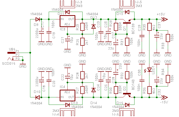

I don't like high feedback regulators applied DIRECTLY to amplifier stages. I always use an open loop cap multiplier equivalent buffer between the IC power reg and the amp stage. I didn't know this 35 years ago, when I designed the JC-2, I just 'lucked' into it, when buffering studio board stages from each other. That is how the Wilson Audio master tape recorder electronics were designed, and the Crystal Clear studio board, among other projects. Please consider that I use vinyl records made from these companies among my reference sources, just to have a more complete chain of high quality electronics from source to speaker.
These 'suggestions' much like: "Eat an apple a day, and keep the doctor away" are learned by experience and often by accident, and are often scoffed at by the 'typical scientists' of the time period. In this case, some engineers on this thread.

SY said:[snip]And, of course, a wise tube designer will (IMO) make his circuits non-critical regarding the fine points of regulation. If I hear an improvement using a better regulator, I'm likely to rip my circuit apart to figure out what I screwed up so badly in the design that a couple of microvolts on the rails would be audible.
[snip]
Exactly my thoughts.
Jan Didden
PMA, you are using almost exactly the power supply with buffer that I have used for the last 30 years. I now use slightly better parts, however, as I found that it really makes a difference.
John, there is only one physics in this small world, so I do not wonder that our circuits are similar 😉
There's no excuse anymore for that preamp to take off. 🙂
