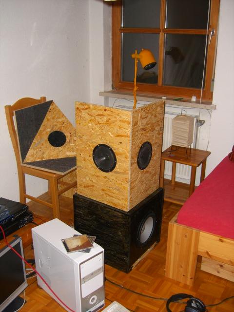

I just did an experiment with two crossed dipoles, like Blumlein´s stereo microphone. My beloved binaural recordings that contain a wealth of spacial information are completely spoiled. Just diffuse, no left, no right, no distance, nothing. Other true stereo recordings have a somewhat narrow soundstage, similar as the put-together Carlssons described avove, but with higher distance to the performers and some added "airiness". Recordings with synthetic reverb have a wide soundstage and good depth, but it´s a synthetic kind of spaceousness, probably as intended by those who build/use those reverb devices. Strangely this only works in a certain listening distance to the speaker. I didn´t test whether it is also dependent on the distance of the speaker to the wall. Personally for those "hate discs" I still prefer the CFS, that adds some "acousticness" that is not there in the recording, but as already said, letting it sound acoustic is probably not the intention of the producers of those discs.
Hello,
Your dipole crossing is having some heavy 'non idealities'. There is no way crossed patterns can sum up correctly if you block the wave with closed corner like in the pic you have.
- Elias
el`Ol said:I just did an experiment with two crossed dipoles

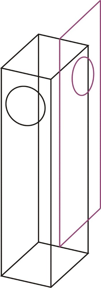

I have a hunch a monopole/dipole could work as well: A M/S mic in reverse.
A quick and dirty sketch attached.
It would be very important to have the dipole element produce a laterally symetric sound field. A MTM would lend itself to that with the woofers mounted back to back and a dipole tweeter.
NOW thats a much better proposition(as well as being tried and tested) maybe even better if the drivers are employed isobarically(not sure if thats the plan or not simon)
though personally id only go this route if i had a huge room so the rear facing drivers were at least 6 ft away from walls, and give me a steroe image that doesnt sound like its coming midway in the wall
