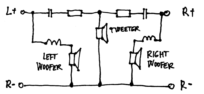

I wonder how could the Stereolith crossover look like - the only way I could find out was a resistive mixer behind a highpass from both channells. And that means connecting grounds of both amp channells - and that cannot be done with all amps, especially not with T-amps. Or is there any other way?
I can think only of one way of doing it. There is a drawing below. I have selected 1st order for simplicity.
The resistors in the tweeter line are there to match the sensitivity and drop 3 dB from the L+R signal. Higher order XO could be used for the tweeter. And if a well behaved woofer is used, there is no need for a lowpass filter on it.

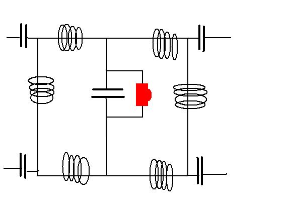

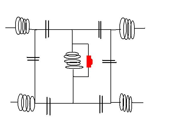

Can it be a bandpass, like this
My memory is not what it used to be🙂
Your idea seems interesting - how flat would the speaker be, if you have toput the speakers to the sides? Or you would use slant sides at say 45 degrees? Or just use very small speakers?
Now I see I must get some cheap speakers and start experimenting. I am afraid the soundbar would not work with my TV placement, as there is a large open door on the left side and that means no refective wall. But it could work if I used ceiling for the reflections instead, kind of mix between Carlsson, CFS and SFS style front tweeter.
