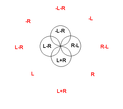

Hello,
Stereo signal from one loudspeaker is an interesting idea.
I would like to keep it dipole to avoid the problems associated to the box.
How about something like this. Two dipoles cross each others. The other is fed R+L signal and the other R-L signal.
Red indicates the radiated signal at the given direction. Here we can have L+R directly towards the listener. R and L signals are pointing 45 degreed sideways which means they can be reflected from side walls to the listener. 'Surround' signal L-R generates 'ambience'.
Any experience of this, anyone?
- Elias

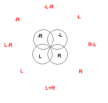

A variation. Cross at different angle and feed R and L signals. This will produce same radiated signals.
I think in practise the first version might be better because direct signal comes from one speaker (L+R), but in theory they are the same.
- Elias

Very interesting Elias: M+S Stereo! ( Mid and Side) I had this thought too.
I used to work in broadcast sound in the BBC in the 90s where we used to use this system for originating sound for TV. The great advantage with it is you can vary the image width to suit by altering the gain of the S signal. This would surely be a worthwile experiment. I don't have any dipoles to try it though.

Hello,
Very interesting. I suppose it was studio environment you used to listen? How about in normal reverberant living rooms?
There must have been good reason for BBC to use this system, can you reveal what was it? Anything related to perception of image or similar reasons?
You can do a dipole by placing two monopoles back to back and driving in opposite phase. For the system I draw, you need then four small boxes. Like a cube, speaker element on each horisontal side.
Tell more of your listening experience on this! 🙂
- Elias

Sorry Elias, I should have explained more clearly. My experience with M/S Stereo was a coding technique as applied to microphones and post production, not reproduction through speakers, monitoring was always matrixed back to conventional L-R stereo.
Link
Making a loudspeaker to work in a suitable room using M/S is not something I've seen done before, but as suggested by you, it makes perfect sense to me.
The mono component would be reproduced by the dipole facing the listener free from typical stereo phase confusion. The difference component by the other dipole exciting the room boundaries. The percieved image width could be manipulated very easily by altering the gain of the S component to match the room.
