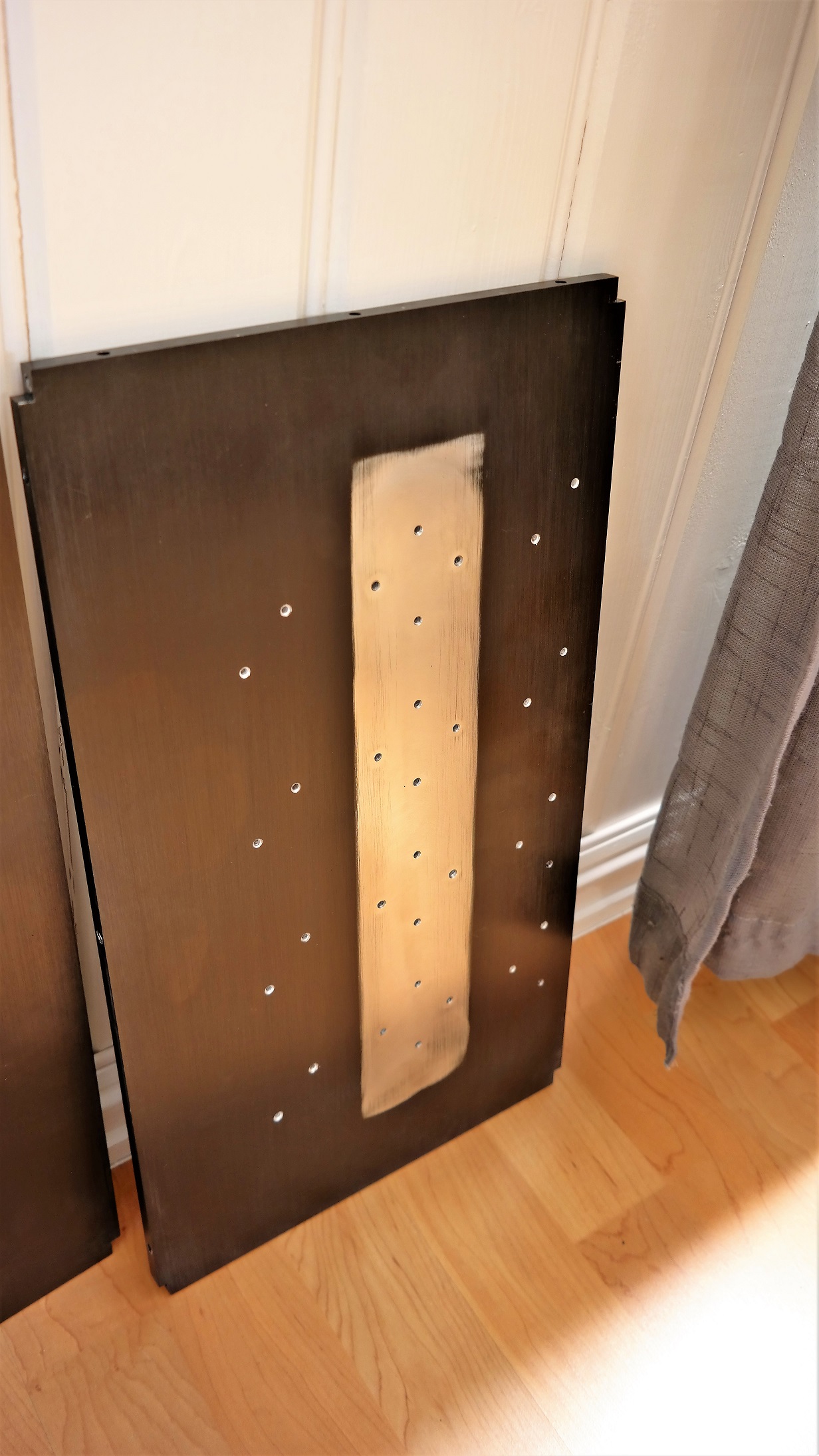

Sanded the area where the outputs are mounted for better heat transfer.

Will polishing to a mirror like finish help??
Assuming you don't need electrical isolation netween the plate and the heatsink, normal goop may not be the best choice. I have no clue what is but I have a hunch there's something better out there.
Yes polishing to a mirror finish will help but it also needs to be flat. This is bloody hard work to achieve if using equipment found at home.

But only the area under the mosfets need to be polished, and they don't need to be coplanar.. seems like a worthwhile effort, seeing this project is a (glorious, in a mad positive way) effort in extremes. Truly crazy would be polishing the mosfets..

Yes very true, and if you're prepared to go to the effort then it is definitely worthwhile, but to get all the scratches out it can be a bastard.

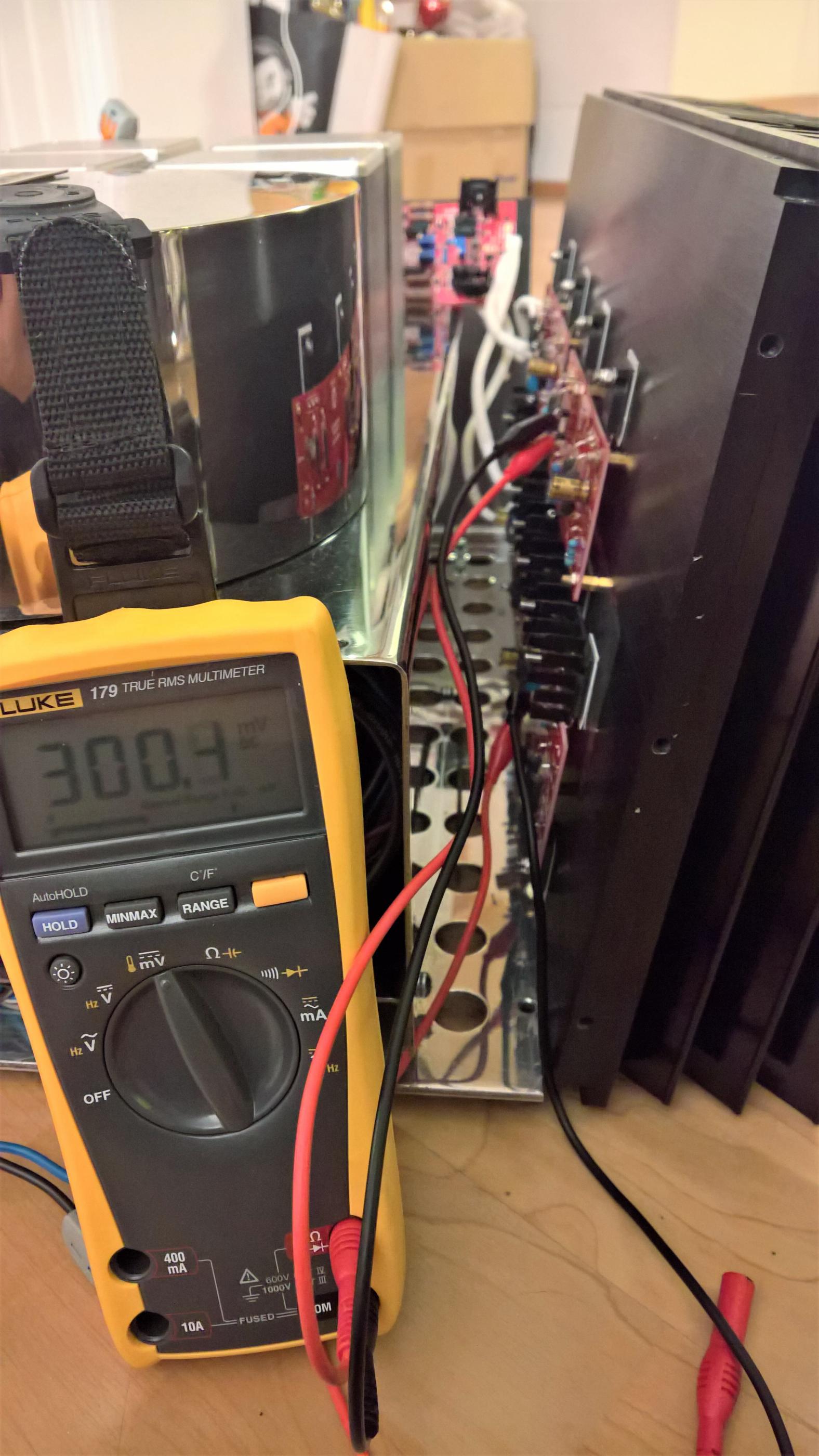

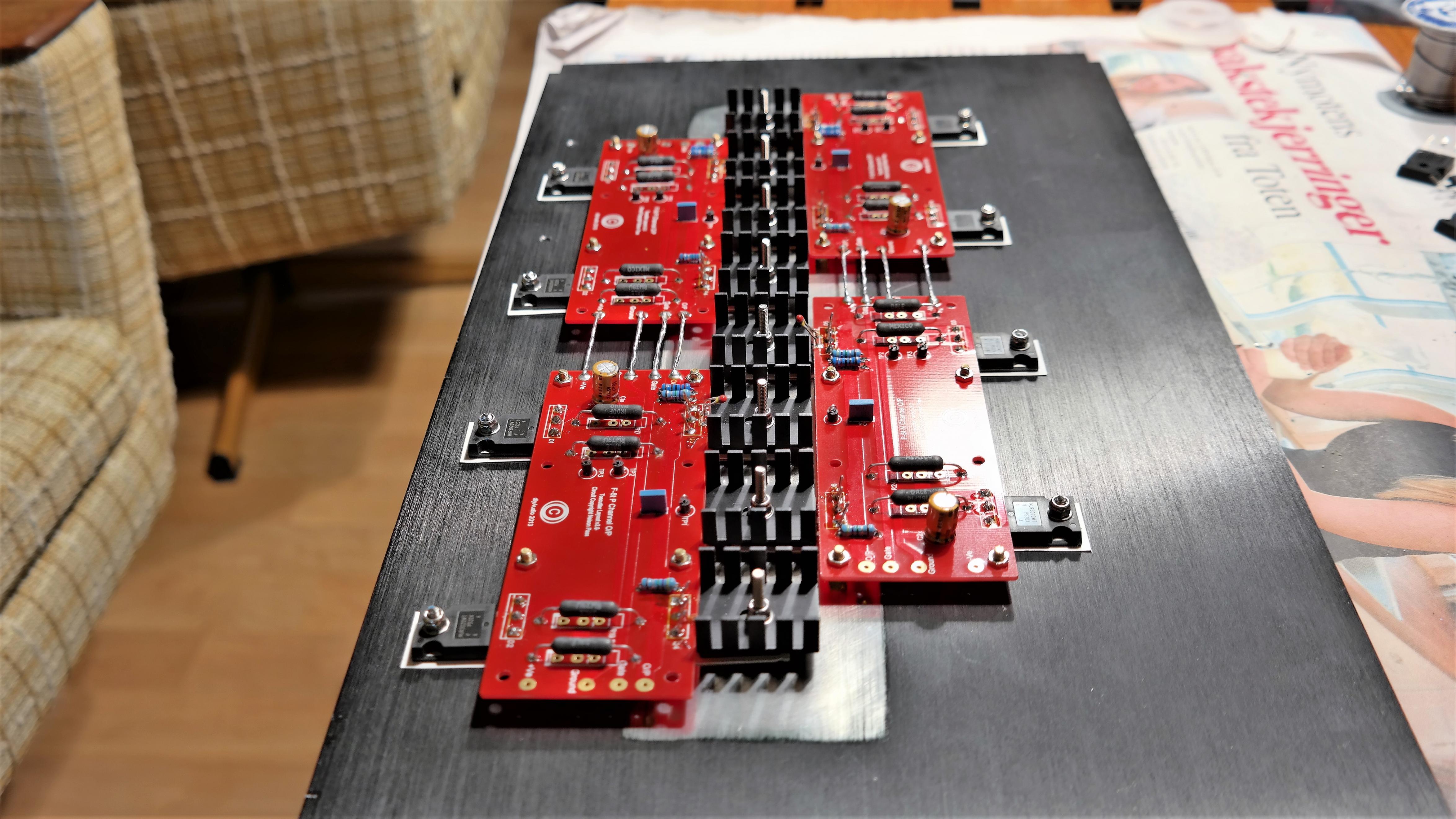

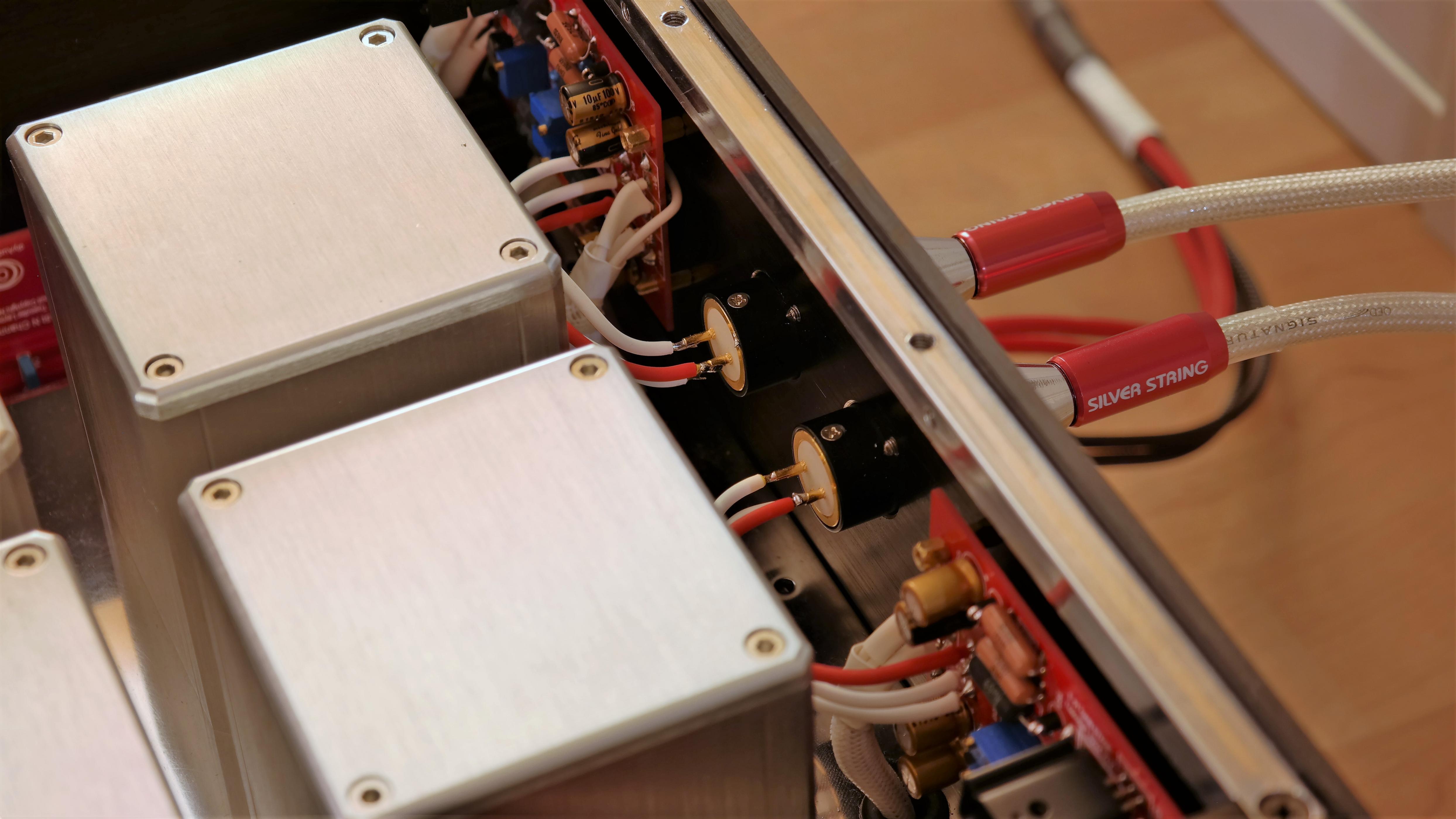

Sadly one ot the jfets where dead to, so I could not balance the bias/offset. I did not have any spare with hig enough idss, so I run two in parallel connection just to get the amp up and running. I have orderd more jfets so I can replace it.
attachment.php
Yes, now its working!
attachment.php
Everything connected.
attachment.php
Now, testing!
attachment.php

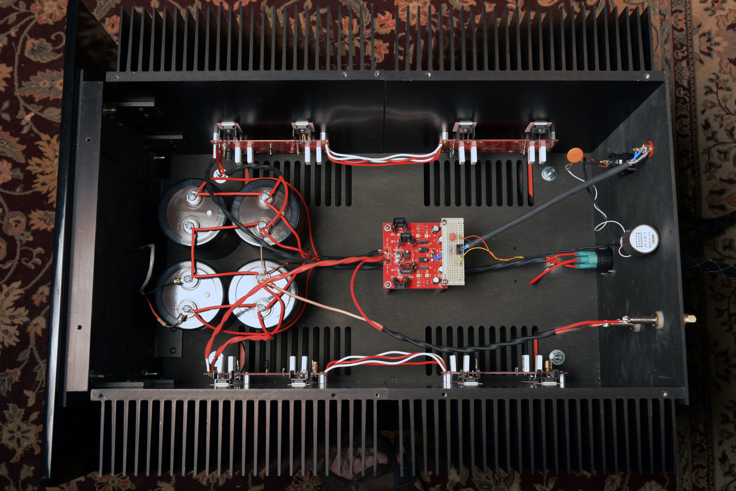

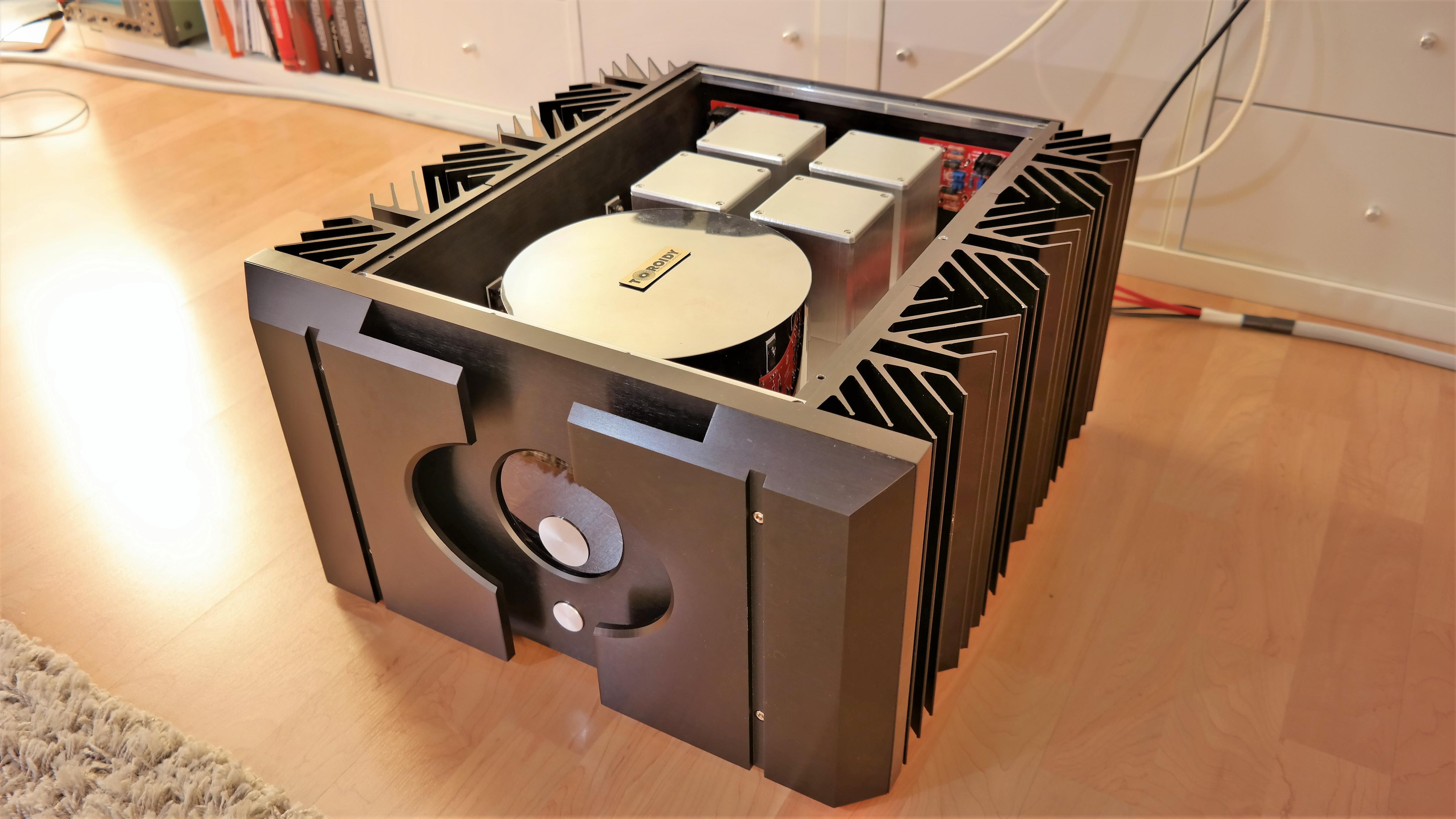

Wow, very very nice build!
Thank you Walter. I am quite pleased myself, but if I would do it again there would be some small changes here and there. 🙂 Im maybe thinking about a bigger and more powerful F5 Turbo, but not decided whats next yet.

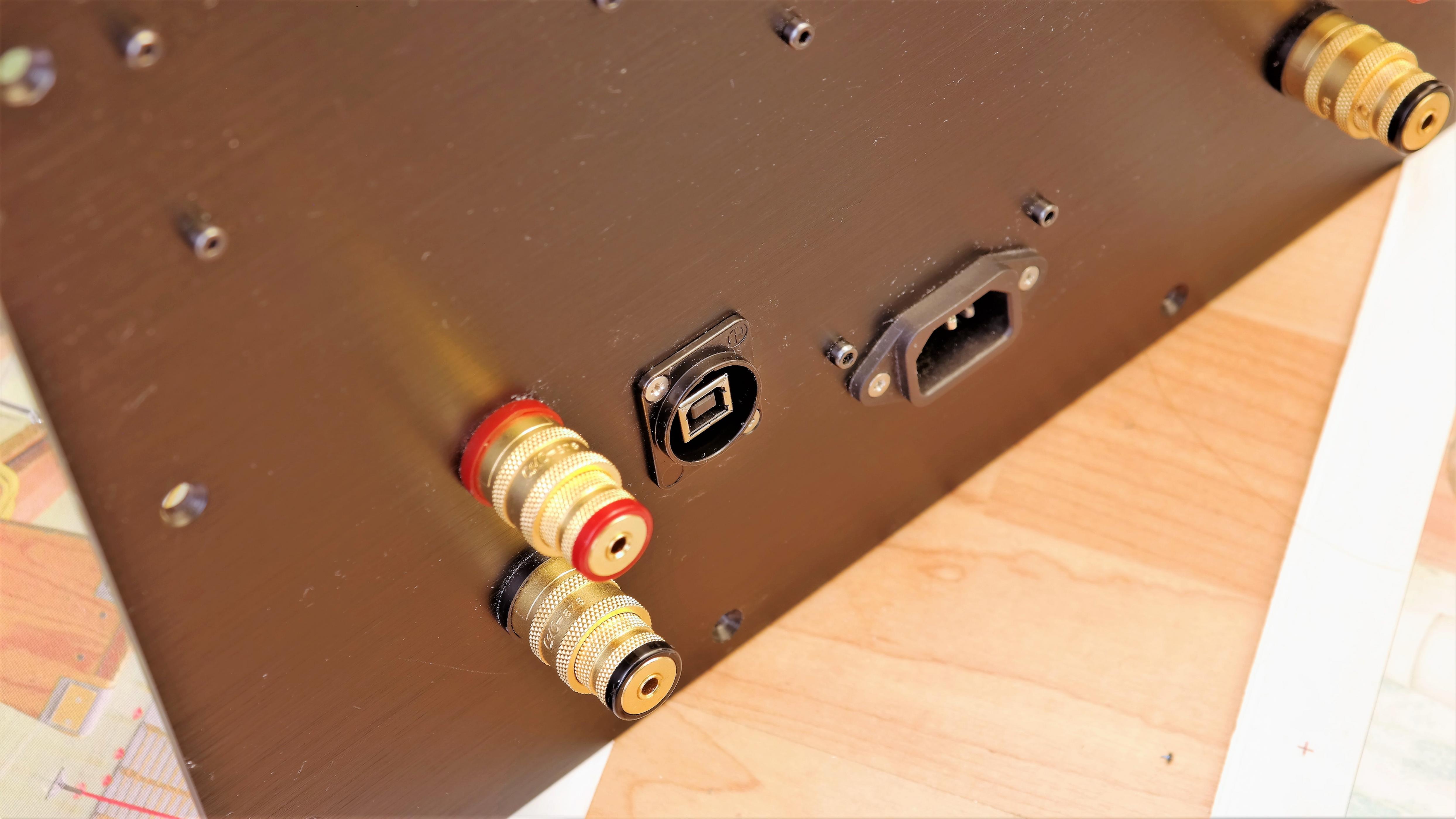

This one is still not finished. I have some plan for the round window in front, and it has to do with the USB connector in the back.

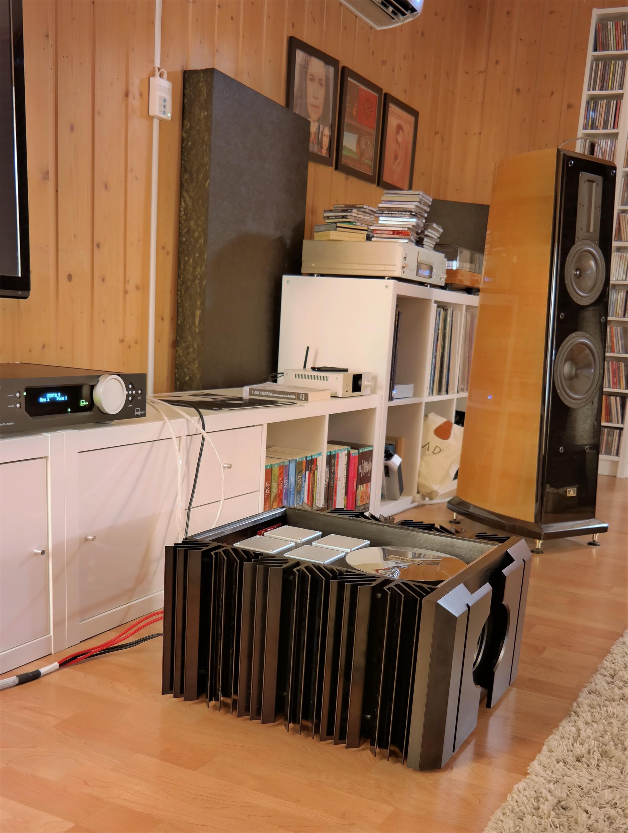

attachment.php

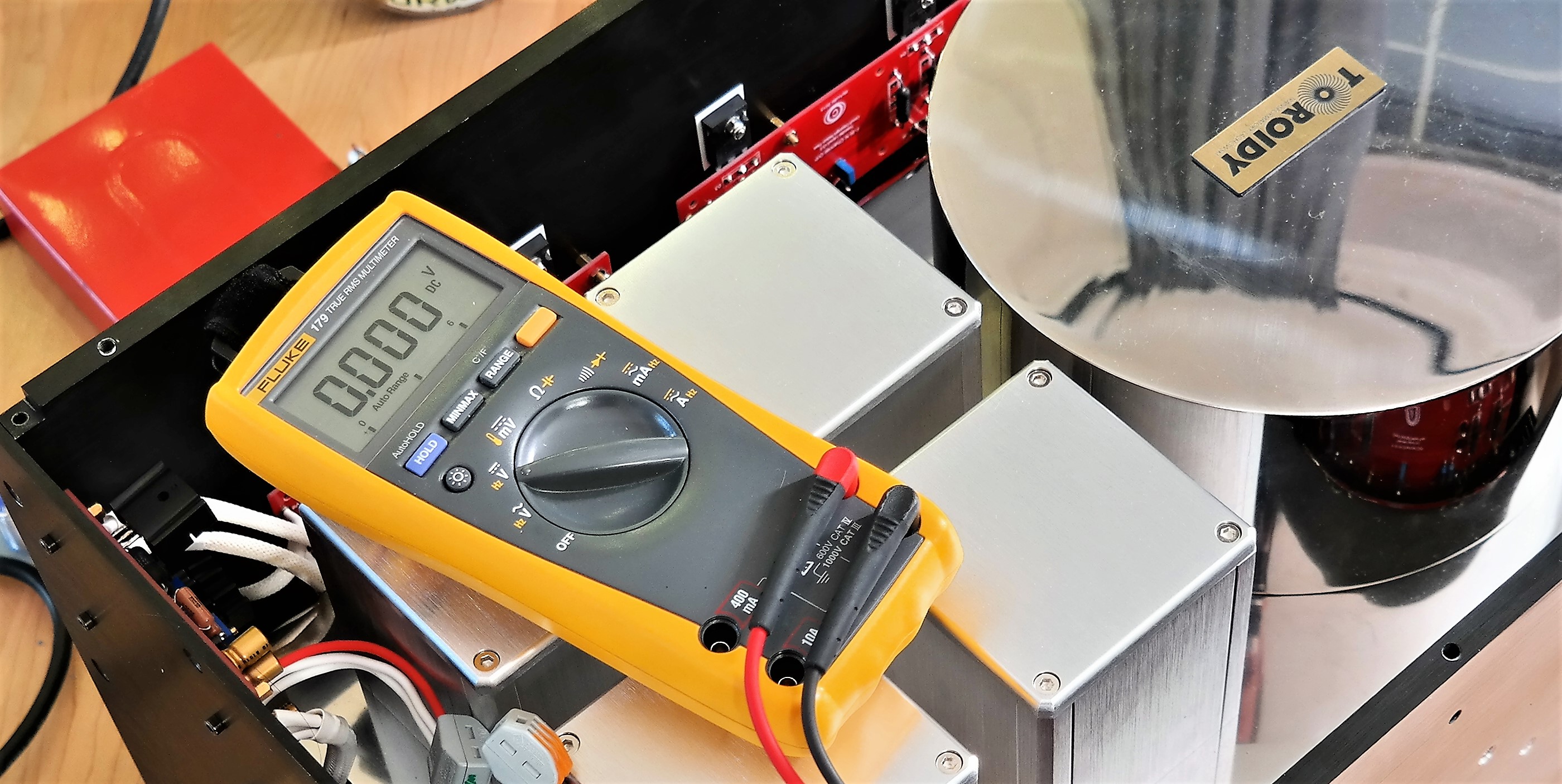

There is also another problem. I did a misstake when measuring, and I accidentally shorted something with my Fluke probes. Dont drink and measure!:drink:🙄 Well, the result is one fried channel. Even one of the rectifiers is smoked. I dont think I will repair it since the damage is extensive. Thinking it is better to build a completely new channel.

Very nice build! Thats a lot of detail and hard work on the interior !
You want more power?! how many watts are you pushing now with this build?
Thanks dazed2, it was a lot of work indeed. The SS surface was a pain in the xxx.

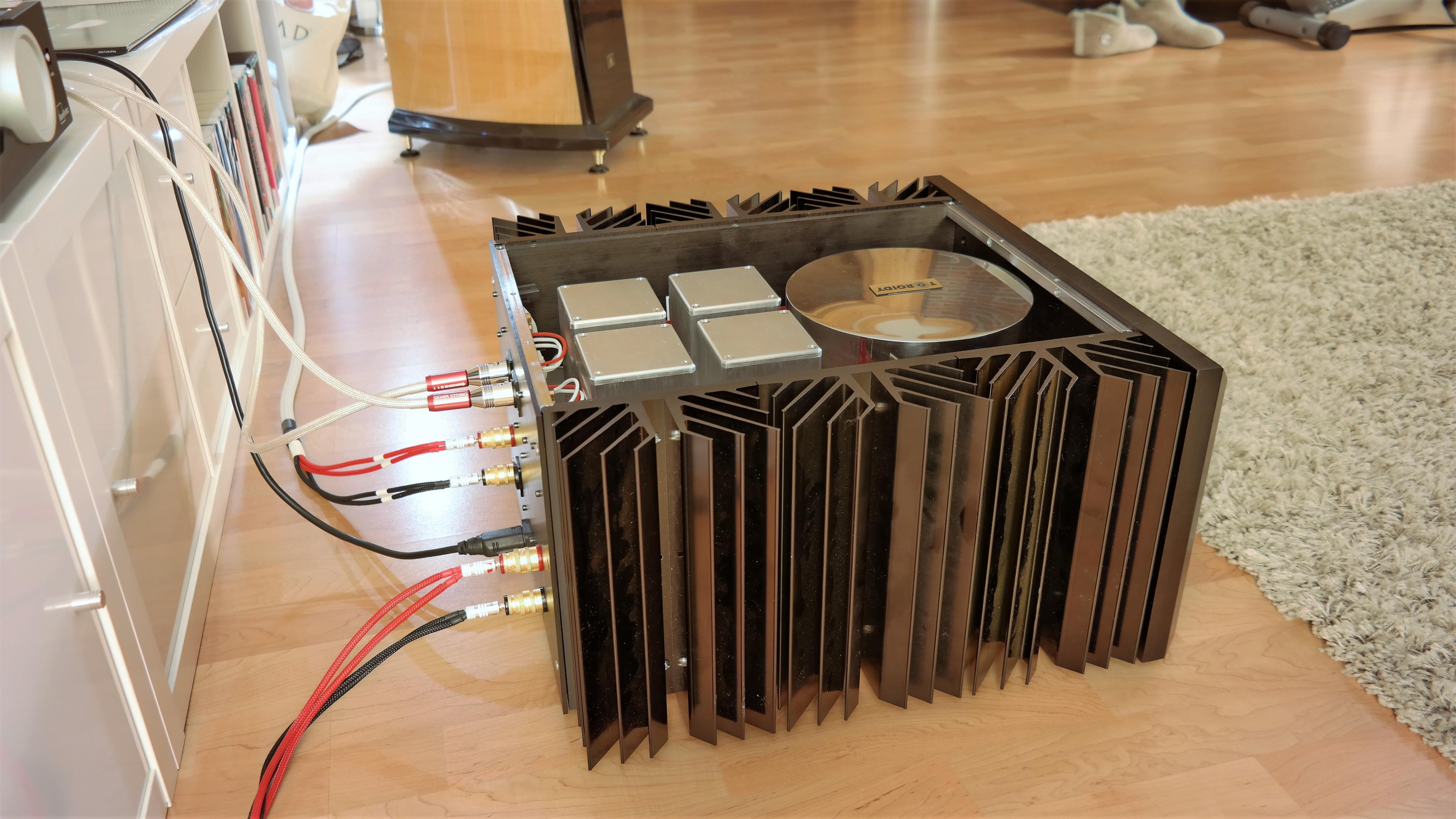

Last time this build was up an running it was running 110W class A. The heatsinks got 60 degree celsius, so its little to much. I think it will run stable and safe at 2x100W class A. The weight of the amp ended at 67kg.
Yes makes sense, I think a single chassis F5T3 generally tops out at about 100W classA due to heat issues.
When I built mine they were mono blocks with separate PSU, and I'm able to crank it to about 160W class A with only a 19C above ambient temp rise. I guess I can go more, but never really bothered 🙂
Funny thing though I never found 160W lacking in any way, even with really hard to drive speakers in super large rooms.

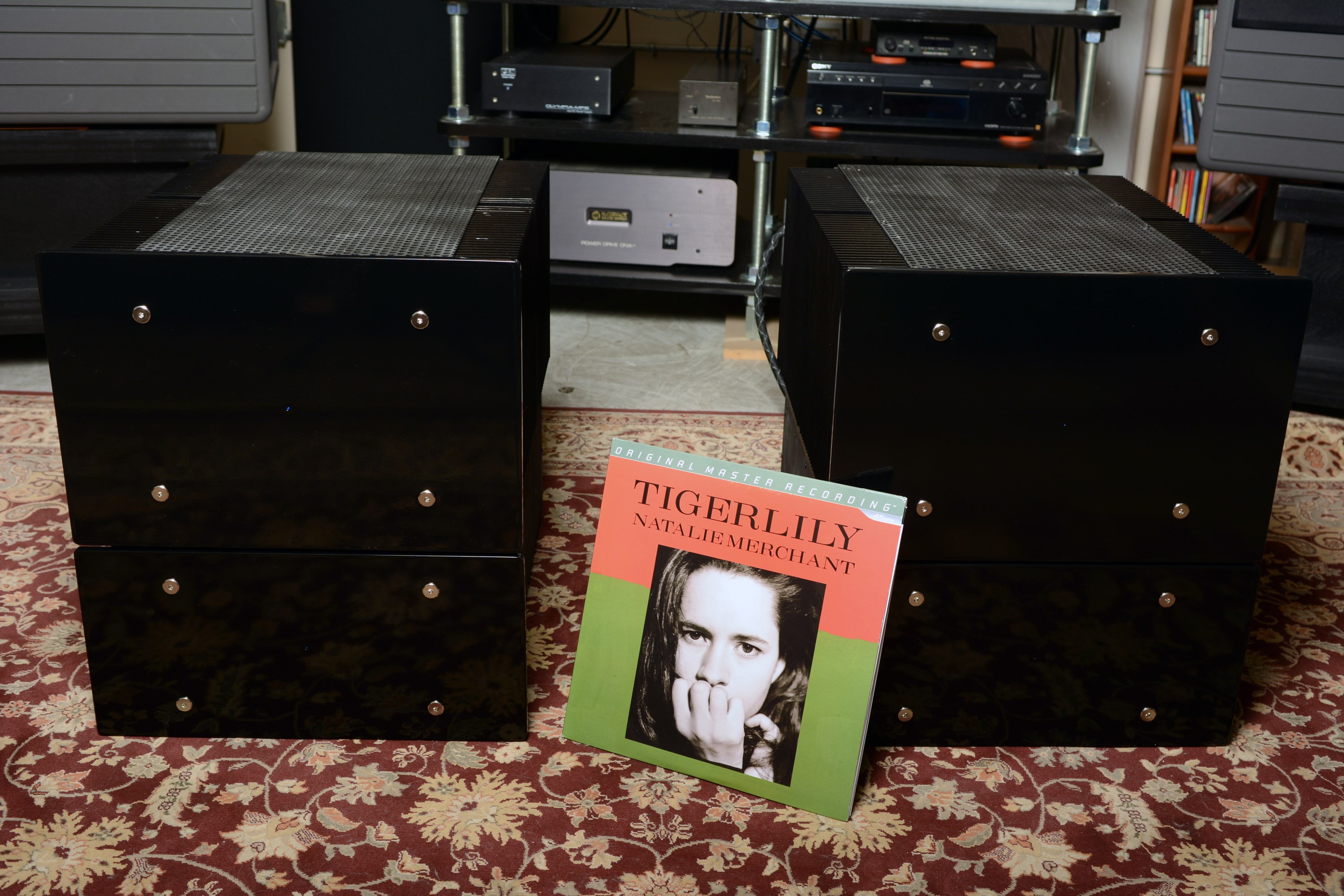

they're resembling DMT series , but with one bar too much
oops , DMT 15 is having 5 bars
which hard to drive ones ?
Wow you're good! Yes the ones behind the amp in that pic are DMT 215's but those aren't hard to drive. I had those amps hooked up to Watson Lab 10's, they seem to eat amps when driven loud. I think impedance swings down to 2Ohm does it 🙂
