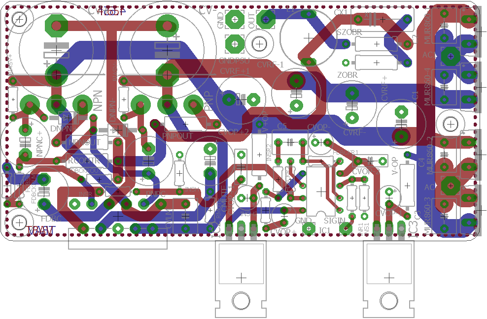

What good does the output stage do really? The LM3886 can deliver 11 amps by itself. What kind of improvements do you get with this extra external output stage?
i almost always use 4r speakers ,and have cheap transformers available local, but 28+28 or 30+30vac . i dont even aim for more than 5 amps out actualy
if this crap board up measures good,i will order few of boards on picture down and that should measure/work better
i expect better or same distortion, 100w output, 24/7 operation,all loads,4r work on relative high +-40v dc. oh yes and if needed only lm can be used with only place wire on place of resistor,so no need of different board and always can have components on stock.
sort of all i could/will need in one board and parts can be left out.
do i ask too much?
do i ask too much?
The LM3886 is capably of 0.005% distortion, pretty low.
The PSRR is excellent but you output stage has almost zero rejection meaning ripple will mix with the sound and create distortion. Your best move is to make a perfect pcb for the chip itself and to have proper decoupling and ground planes on the pcb. A critical spot when you have a pcb and power signals is the grounding scheme. A small mistake in the pcb can change the distortion from 0.005% to 0.1%.

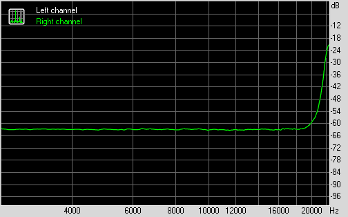

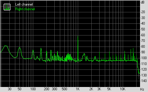

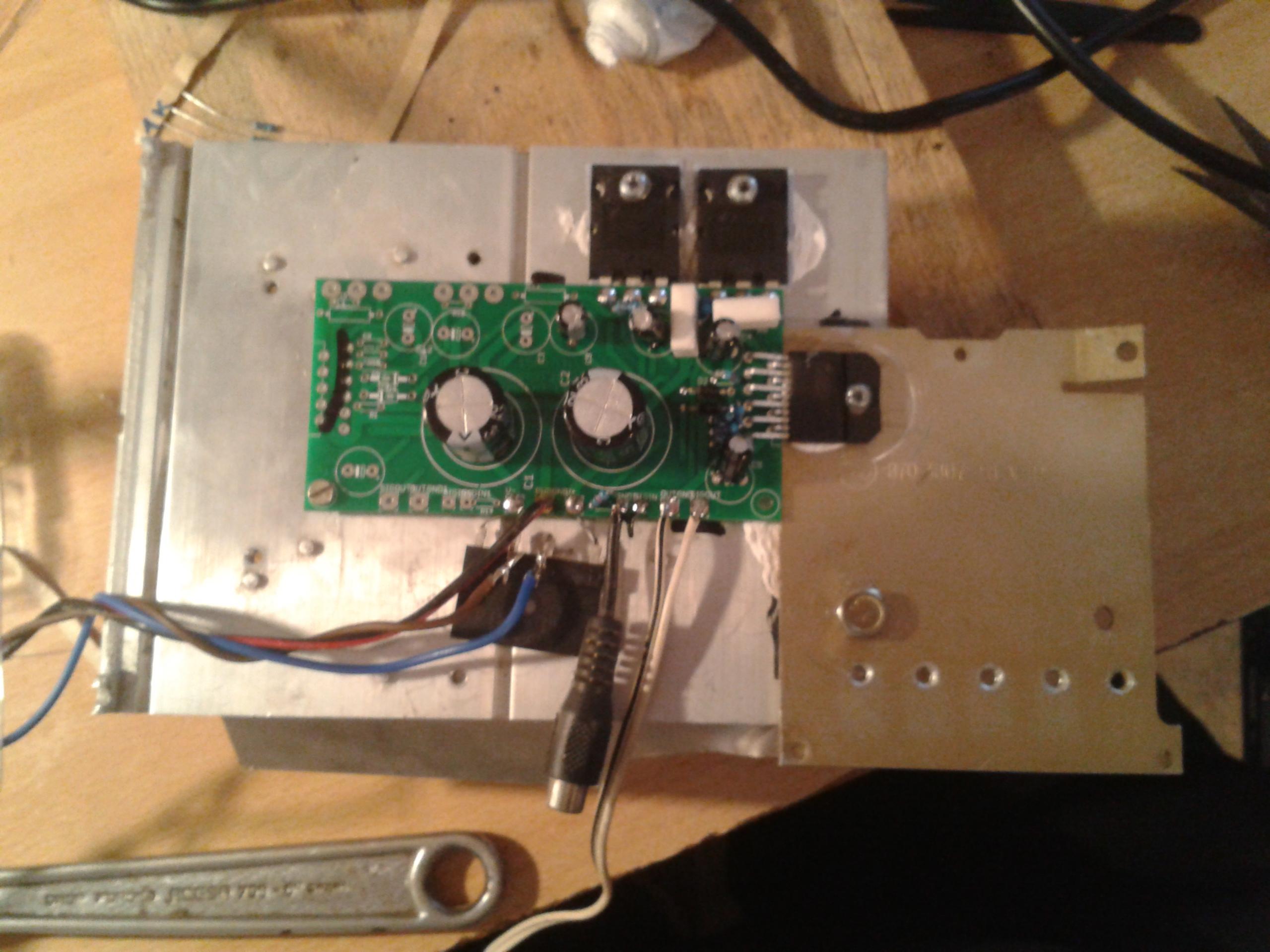

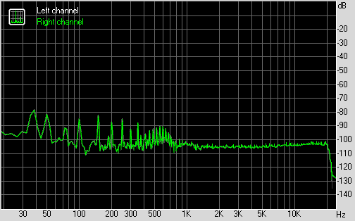

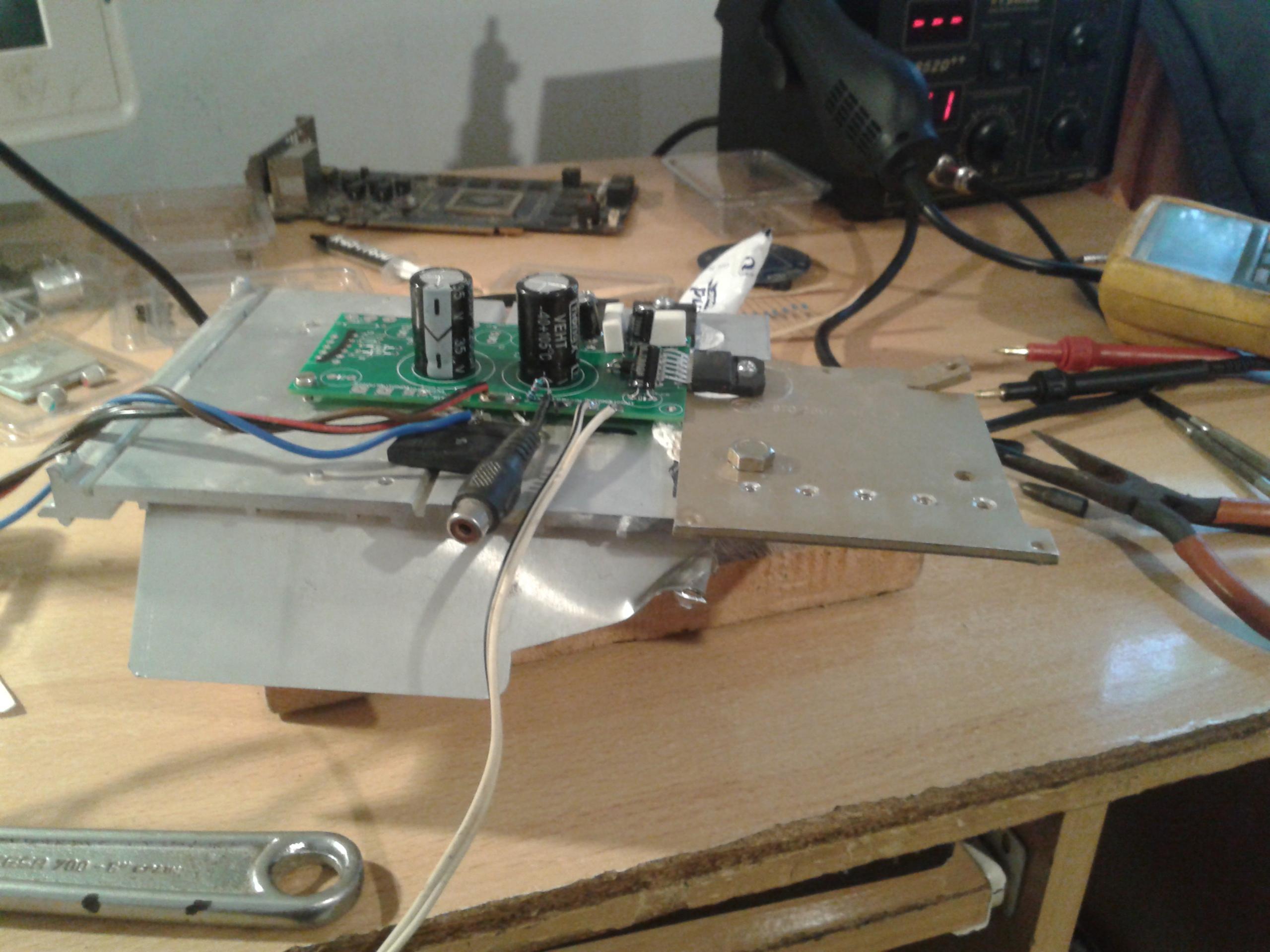

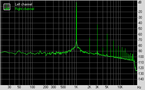

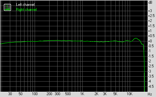

here are measurments, i tested it with 4r speaker and machine headphones as i dont have big enough resistor for this
You have > 0.1% distortion at unknown power = 20 times worse than the chip alone
At 10 kHz ?? Horrible I should think.
If your diodes are plain diodes (not LED's) you will end up with a class B stage which by nature is bad sounding, especially at high frequencies.
the plot shows third harmonic @ -40dB relative to signal, that's 1% 3rd
the 2nd is at -64dB and 5th is at -56dB
Those three harmonics add up to 1.22% distortion.
That is worse than attrocious.
i think i need to order proper boards,proper high power resistor and proper measuring gear.
measurment was on max out, need resistor to check how much wats exacly but probably little over 100. i am concerned only about that peak in fr
