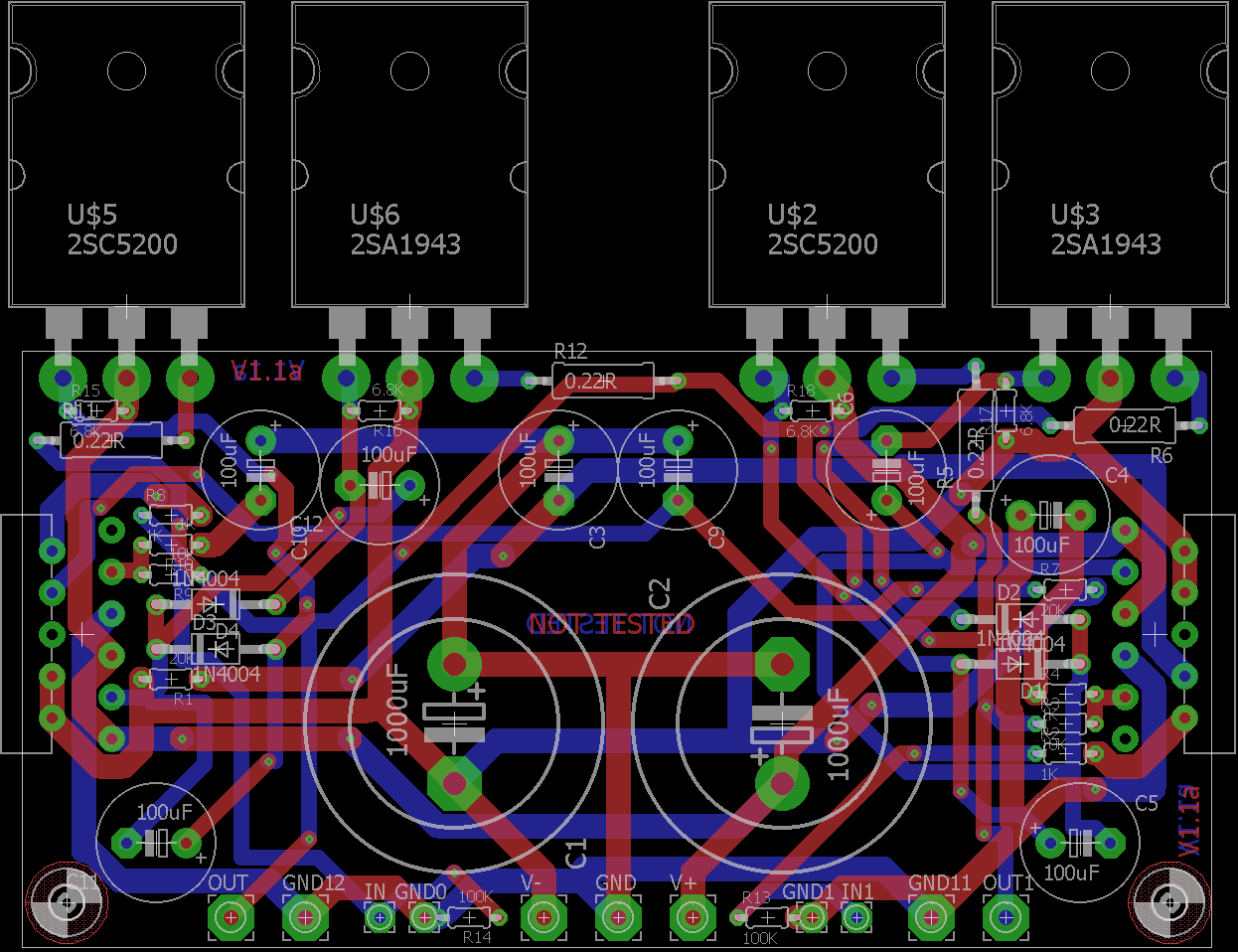

I don't know what I saw really but you are right Andrew, we talk about distortion levels of approx. 1%. The reason for this is the output stage but also a poor layout. I don't want to be negative but it's crucial to get the pcb layout right because you will have substantial voltage drops if we want to pick up uV in error voltages. 0.005% distortion requires a pcb layout in Spitzenklasse.
i belive second posted pcb would work much better as i try to make all traces as short,all traces are higher width , there is ground plane on both top and bottom layer and there is no vias, while there is lot of vias on original pcb i am measuring now,and also not thickest copper my board house allows.

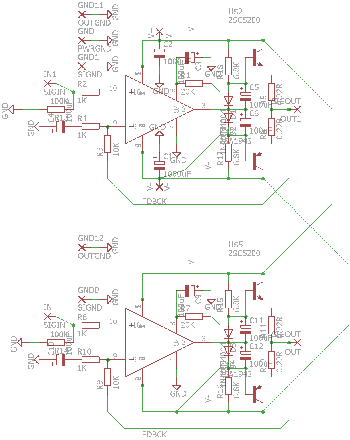

i dont understand why you say this work in class b when there are bias diodes and resistors and this should work class ab with 6k8

there is little current it is litle bit conservative and as low as possible,but there was overlap in simulator. only i am not sure how good output models for spice from internet are.
can you suggest ,do i put multiturn pot in final board for easy adjustment and adjust by hand or simply put little lower value resistor?
