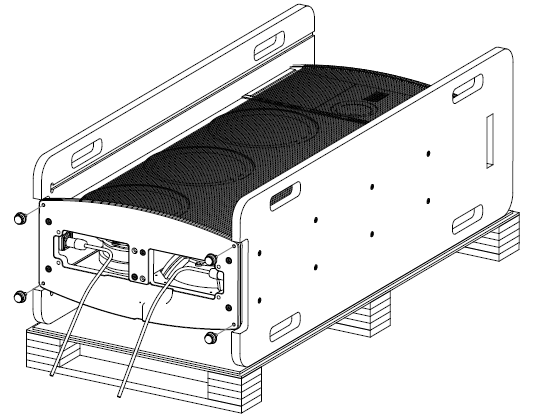

I think the shape is more like this:
(apologies for the poor quality sketch!)
I do find the claim of 7 dB boost from the 'squeeze' surprising, to say the least.
... or are the sides open?
I'm pretty sure the sides are solid all the way up. There are more pictures here which show this: https://steinwaylyngdorf.com/steinway-sons-model-b/
Don't think the woofers are baffled in the center, do not see any such element in the assembly photos. Also, the sides look to be closed. AND the mid diver is a 5 1/4" diameter - not quite large enough to go fairly flat OB down to 350Hz as Linkwitz stated. This implies the designer(s) are correcting all response issues with DSP, and the mid and high frequencies will definitely have issues. The drivers are centered for one, the baffle is wide and lots of diffraction from the sides. Finally, the little 5 1/4' will probably exhibit higher distortion to really handle down to 300Hz. Maybe not a big deal but still...
I'm not absolutely sure what you mean by "baffled in the centre", but I'm pretty sure the Model B woofer baffle looks like the little sketch I put in post #61 above. If you watch the video in post #2, Peter Lyngdorf says the model B has "a zigzag baffle". Watch his hands as he says this. Also he then talks about how this pressure loads the woofers.
The diameter of the mid isn't going to determine how low it can go 'fairly flat' (though it may limit the max SPL). The baffle size will have more influence than the driver diameter, and it's a big baffle.
Anyway SL used an 8" driver down to about 120 Hz in the Orion and the LX521 - with minimal baffle in the latter. Since going an octave lower requires roughly four times the driver displacement, I can't see that 350 Hz with a 5 inch is a huge problem.
But I do agree that the wide baffle looks problematic for mid and high dispersion.
I am not seeing the zig zag piece that you describe, rather looks like the 3 woofers are mounted to L shaped brackets - nothing in between the two sets. I have measured about 10 different 5 1/4" drivers for an OB application, and none will respond flat to 300Hz without a cabinet or response correction. Alternatively the 6 1/2" ones do easily. However, the larger mids start to get directional at 2-3Khz or so, and the 5 1/4 will definitely go higher and disperse well. I heard Linkwitz's comments, so it is interesting, wish I could see one in person.

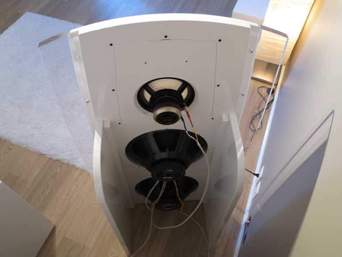

I saw the video now and it’s definitely an open baffle and not two separate chambers. Since Peter Lyngdorf explain the reduction of 2 harmonic distortion and that the separat 3 pairs have reversed polarity the sound wave comes from all 6 woofers. Maybe the 4 channel amp altså fine tune the delay on one of the 3 pairs so all the 6 have equal start point. 6 x 12 inch long stroke dipole woofers is nice 😎 and 60 cm with plus wings give around 1 meter effective baffle. I think it will be no problem to adjust a nice crossover with dsp and Roomperfect with this even if the baffle around the midrange is very (too) wide.
I have made a lot of open baffle speakers and I must say I am very impressed and curious about Lyngdorf model B 👍

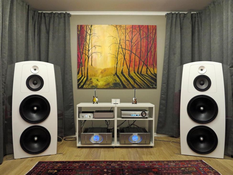

This is one of my dipole constructions:
