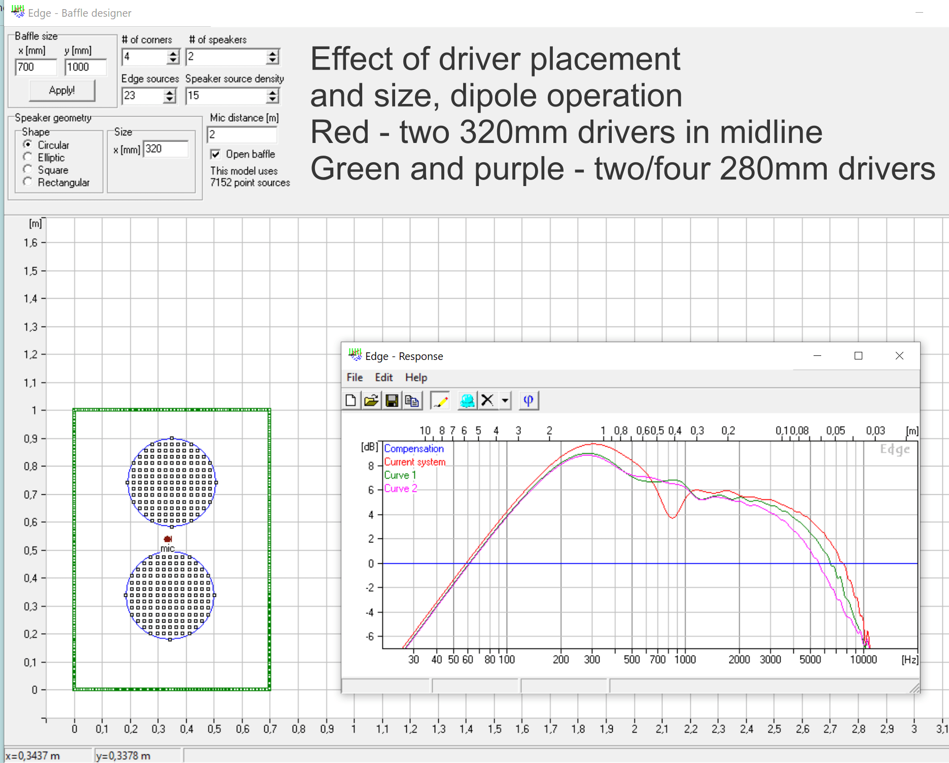

Six 12" drivers will have a radiation area of around 3000cm2, I guess. A single 18" would have around 1250cm2. More is better right? The use of front and rear facing drivers also has the potential for cancellation of even order distortion. I like the Lyngdorf solution.
(Also, the dipole radiation pattern will be maintained higher, because the proportion of radiation area to baffle size is higher.)
More drivers, Sd and motor force helps to reduce distortion - yes
Using opposed motion direction with multiple drivers reduces distortion - yes but only microscopically compared to previous
Area proportion shifts dipole null - no
Baffle width determines dipole range. Location and size of drivers has some effect to dipole peak and null sharpness.

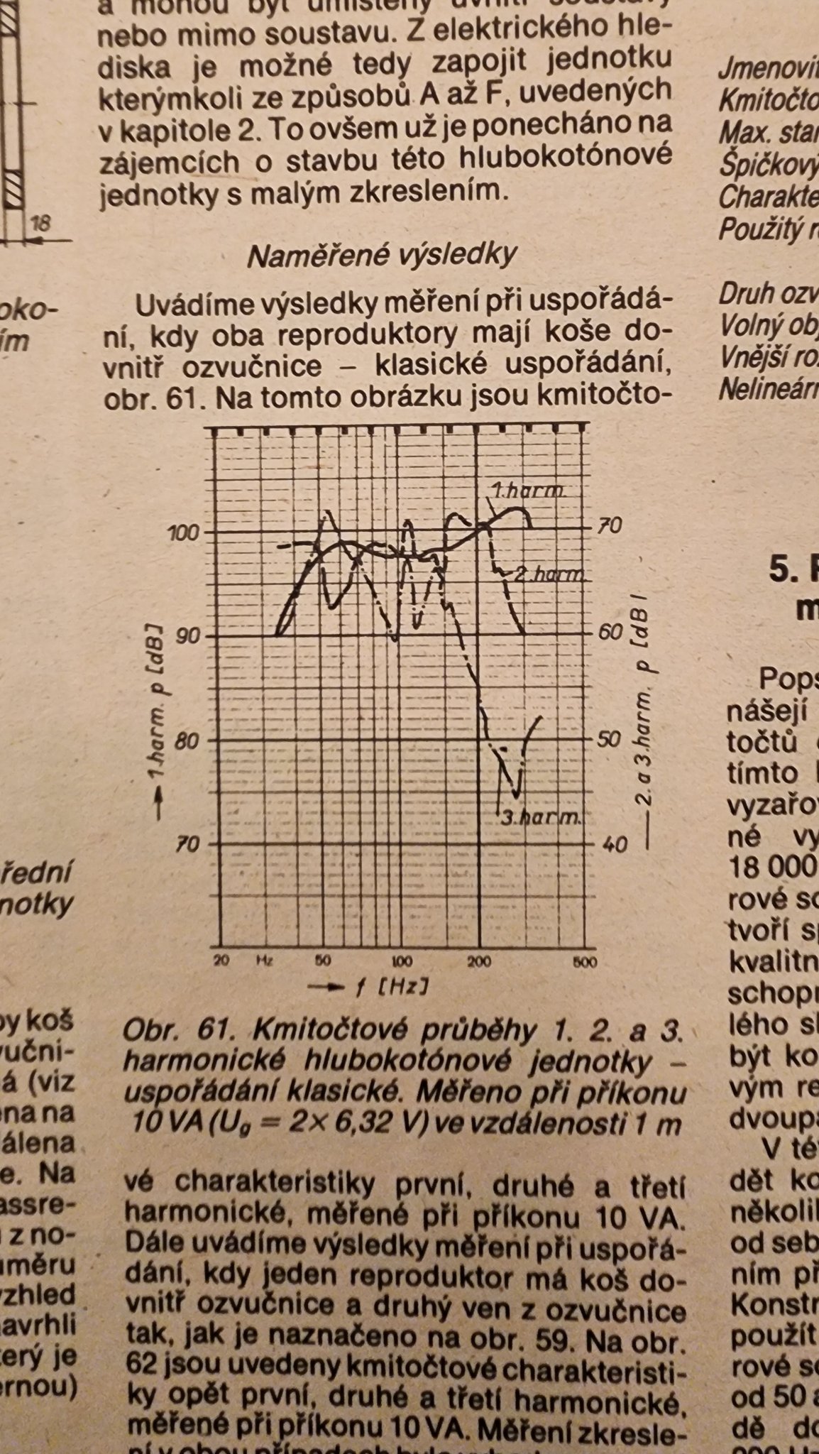

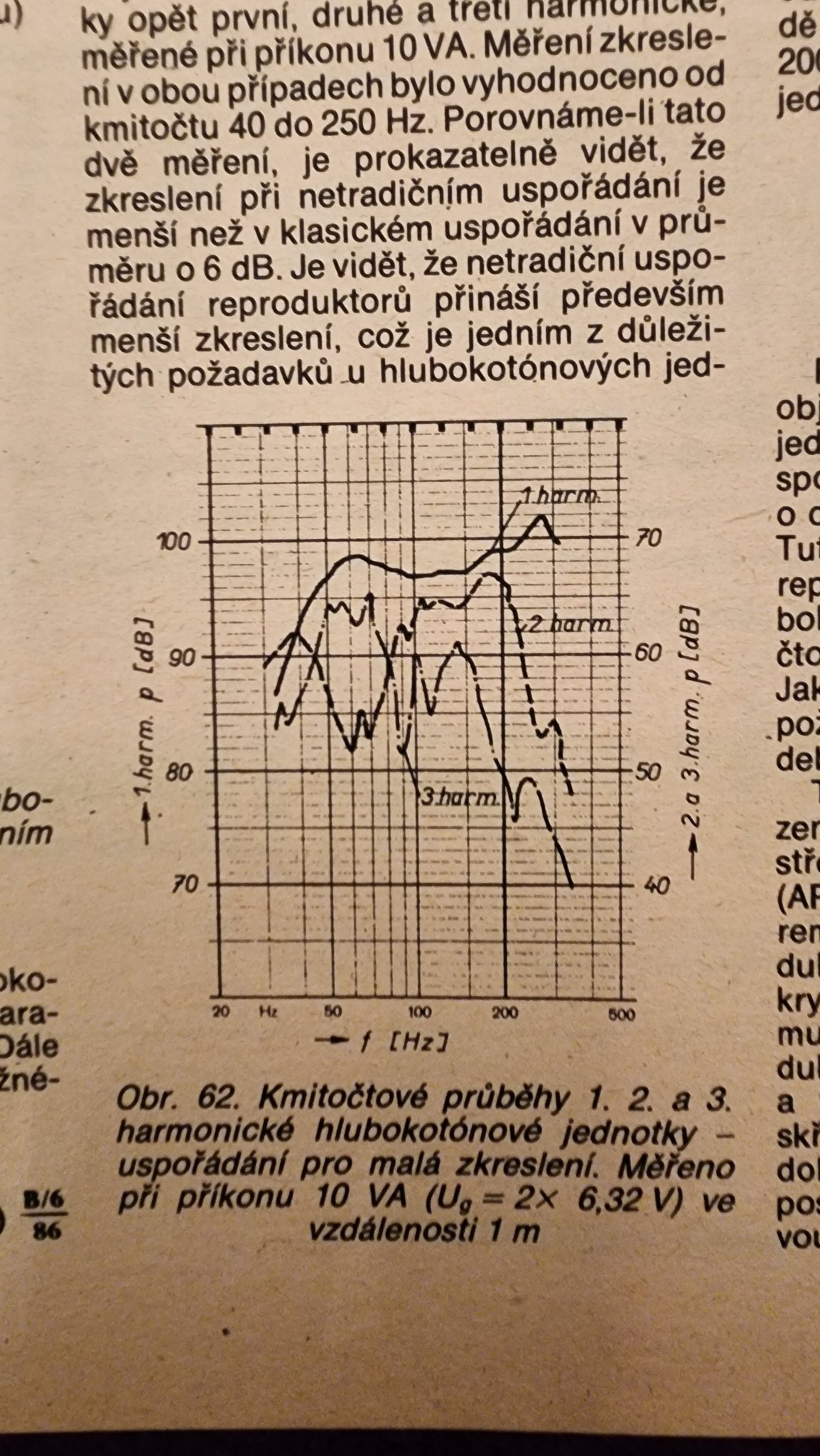

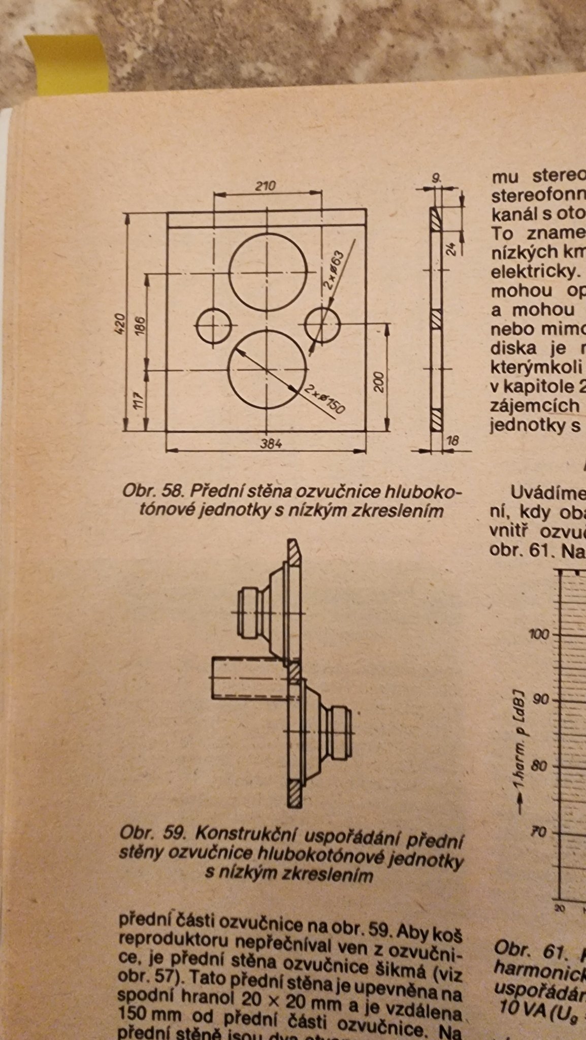

Here are actual data measured at 10 watts. Please look at 50 Hz. With woofer facing same direction, 2nd harmonic is over 60 dB, 3rd over 70dB (not the same scale as fundamental).
In oposing direction, second graf, 2nd harmonic dropped from 60 to over 50 dB, thats ~10 dB reduction in 2nd harmonic distortion. 3rd dropped from 70 dB to 60 dB.
I would not call 10-20 dB distortion reduction microscopic.
Sorry about the slovak language there, but the picture is the story.
I am sure Dave will disagree, he always says 2nd harmonic reduction is not always a good thing. But to me 10-20 dB reduction in 2nd and 3rd harmonic distortion is a good thing...
