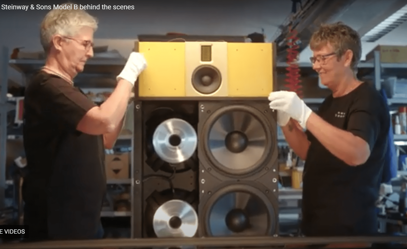

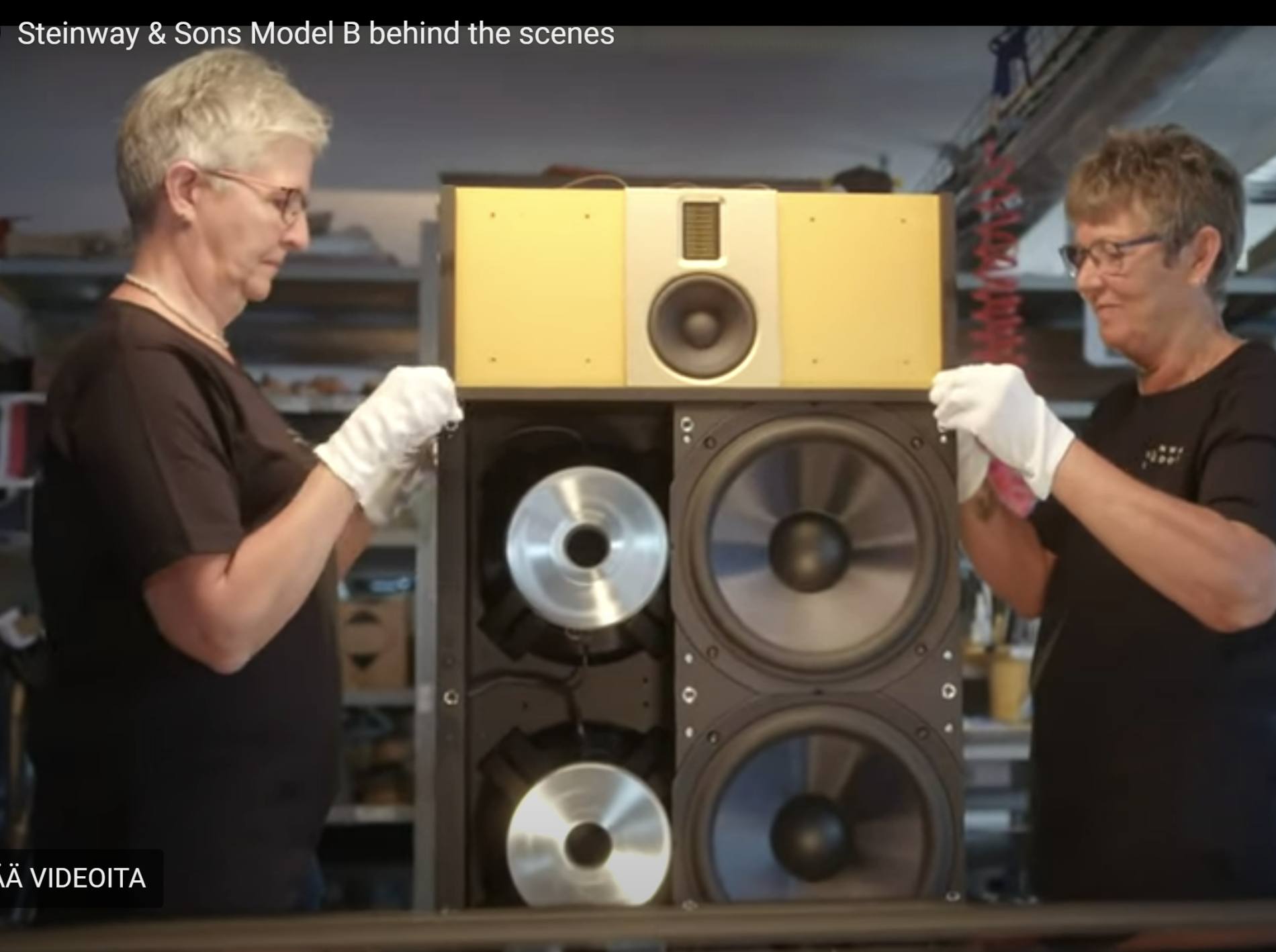

If you see the video, the bass module consists of two narrow open baffle connected mechanically with each other only at the edge of the baffle. The remaing of the baffle is just protective grill for cosmetic reason.
By connecting all the driver in phase, both open bass baffles will be in push-push configuration mechanically. It will reduce vibration greatly.

In case the video goes away in the future, this picture in particular is useful.

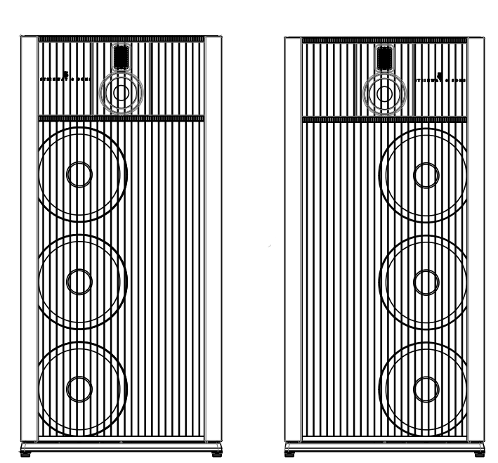

They have done a very good job hiding the backsides... even the graph drawing hides the backsides!

Now looking at the pic I ask myself if the "box" is open at both sides? That would make acoustic behaviour really mysterious even if woofers are push-push. Nelson Pass's SLOB is not better at all basically. Four lobes, quadripole? Total elimination of room modes 😎

I took clips from the factory video. That must be old version, different from the present version at homepage. The video shows that the woofer system is sort of H-frame. Mid.tweeter is wide U-frame or are the sides open?
