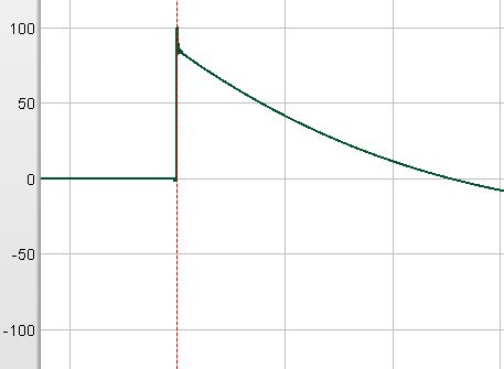

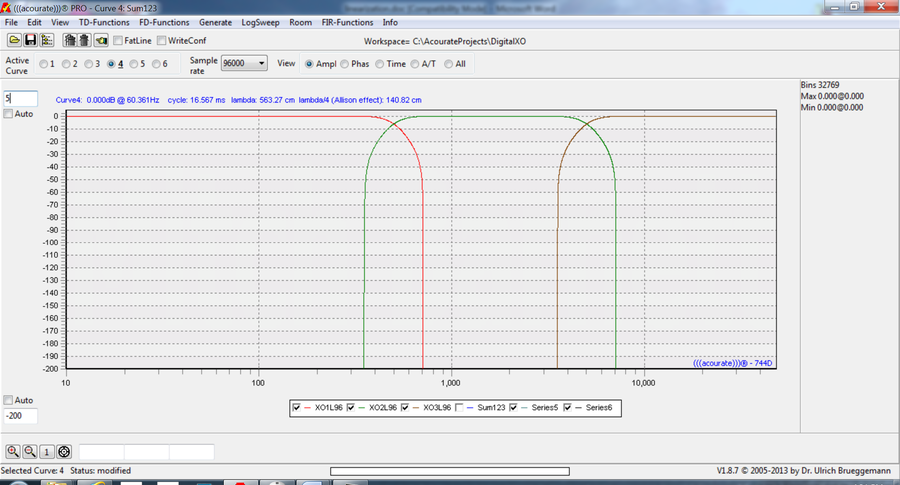

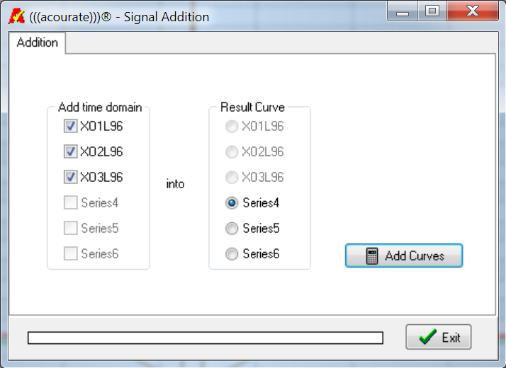

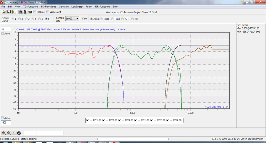

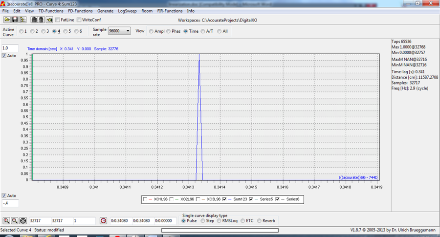

Here is a 3 way linear phase digital XO with steep slopes:
Adding the time domains together:

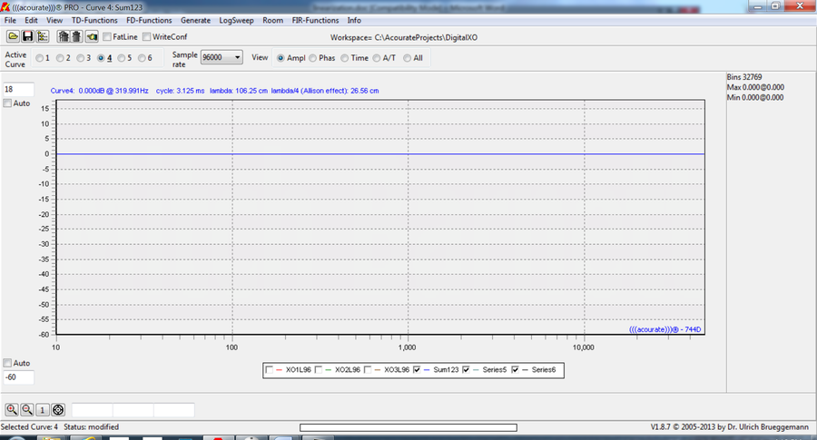

Yields:
Perfect Dirac pulse. Amplitude?

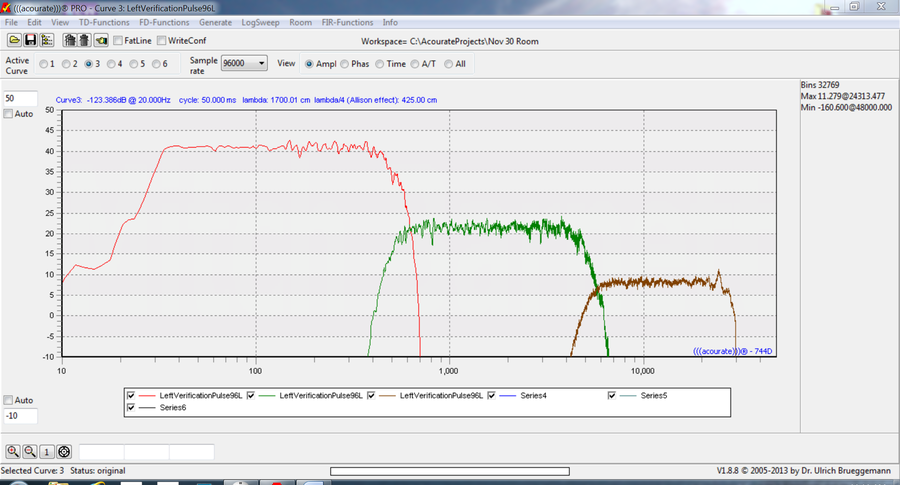

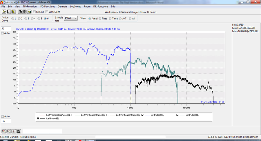

Perfectly flat. Next step is to linearize and time align the drivers. I am going to leave out the time alignment, but here are the 3 drivers raw responses:
And linearized:

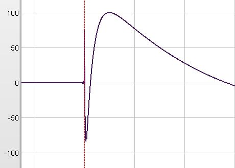

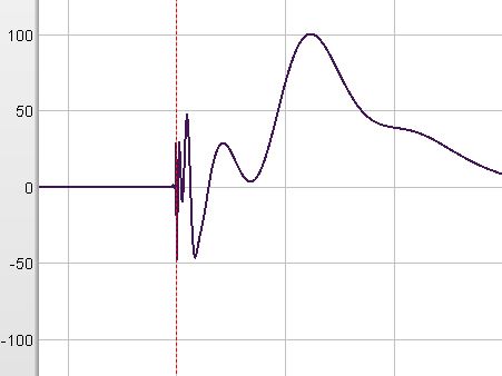

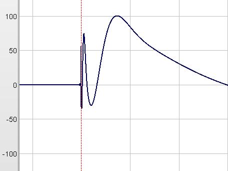

As been said a number of times, you linearize the driver within its operational range and then you convolve the drivers linearization into the digital XO which is within the bounds of the driver linearization. So when you sum the digital XO's they sum perfectly in the time and amplitude domain, just as demonstrated above, except they now contain the driver linearization:
One can see the original XO's and then the convolved XO's with both the driver time alignment and linearization.

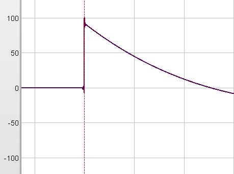

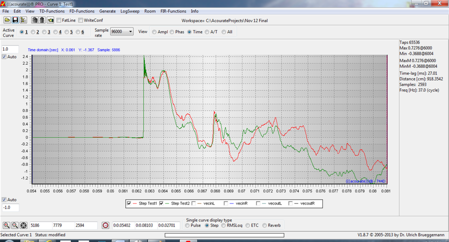

Finally, the measured step response of the 3 way steep digital XO system at the listening position:
Notice no preringing. Also note this not for one position. I took 14 measures around a 6' x 2' grid area at the LP that represents my couch and the time alignment is prefect at each spot with a very small variation in frequency response.
These images are pulled from an article I wrote in 2013, Advanced Acourate Digital XO Time Alignment Driver Linearization Walkthrough.
Since then I have done this on dozens of systems, each with progressively better results. This is the frequency and timing response of my current system using the same techniques Official Rythmik Audio Subwoofer thread - Page 1223 - AVS Forum | Home Theater Discussions And Reviews

My point is that the pre-ringing will affect the whole response regardless of angle as it is inherent to the impulse response of the crossover filter.
This is the problem...
Neither pre-ringing or post-ringing will be audible where the crossover is behaving in a complementary manner - that is at the ideal listening point. The pre- and post- responses of the crossover sections will sum to give an overall all-pass response (that for the linear phase case will be a pure delay).
It is therefore fundamentally different to applying a linear phase for an EQ effect where the pre- (and post-) responses will be left in the filtered output because there is no complementary filter to cancel them out.
The issue with linear phase crossovers therefore is restricted entirely to considerations of the audible consequences of the off-axis residue where the complementary action no longer works.
Hence rules of thumb for linear phase EQ and listening to pre-responses from inline simulations is of limited relevance to crossovers.
Interesting I see your point now. If that holds true over over a large enough area it would make complementary linear phase crossovers very close to ideal if the latency was low enough for the application.
In many applications, it is ideal. But there are instances where it is not so and where audible consequences can arise that are made worse because of the exposed pre-response artefacts and because of their prolongation in (negative) time.
Group delay, so long as it is not excessive, is not audible. LR4 has never been a problem. By the 8th order I am not so sure - maybe that starts to become detrimental. I do not know anything on the FIR side to comment.
