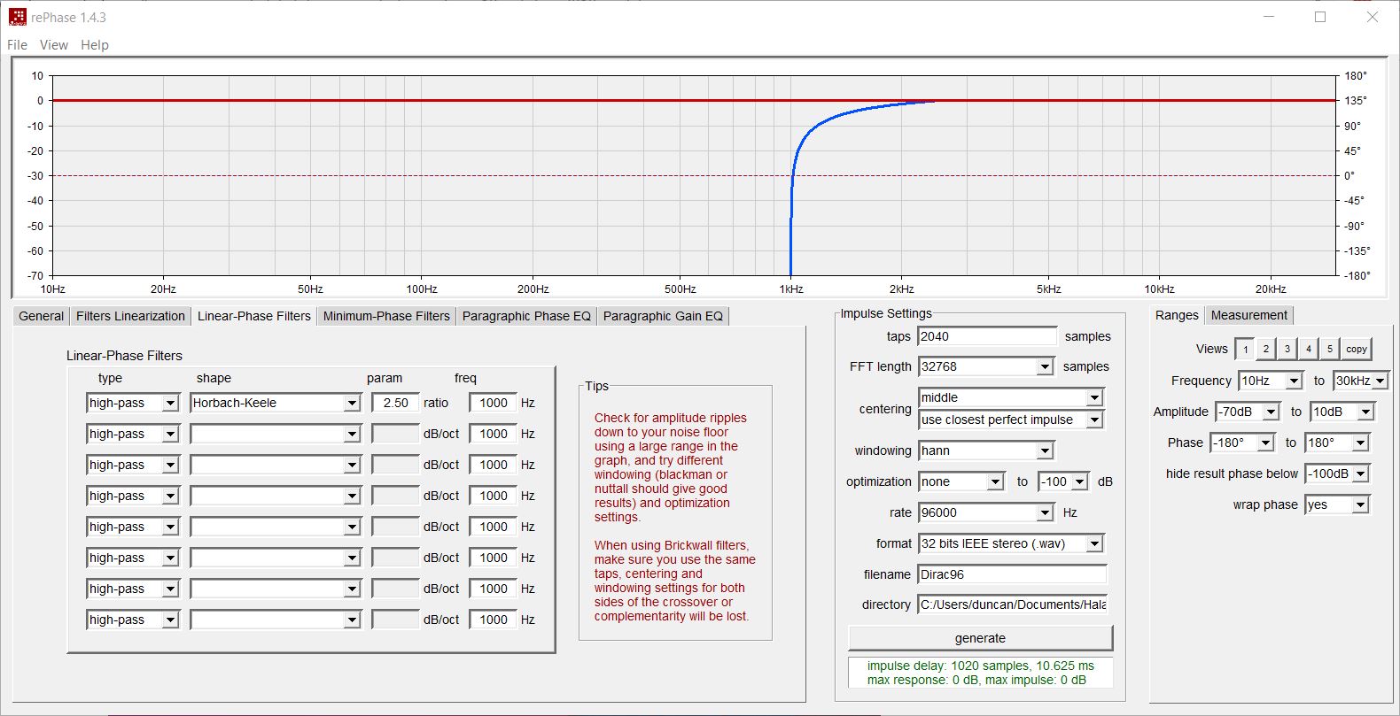

JRiver is available for Linux, but the Convolver is not, I am afraid. How do I get the IRs for convolution? I still imagine interface like with "normal" crossovers - select frequency, order and that is it. I guess it is not that easy with FIR.

It's exactly that easy to generate the crossover slope using rephase. Screenshot attached below choose linear phase or minimum phase choose frequency type and any other parameter associated with it, choose the number of taps you want, type of output file you need and hit generate. Rephase shows you what it generated compared to the theoretical ideal and you can decide to change parameters to make a better match if it isn't good enough.
BruteFIR works with Linux but that is not as simple to operate as Jriver. For cheap hardware look for Chinese DSP boards using Analog Devices SHARC processors. They can use Sigma Studio which is difficult to learn but very flexible. MiniDSP uses .bin files which rephase can create directly.

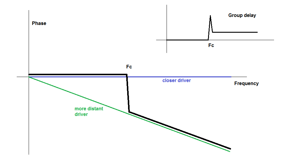

OK, this is the concern I mentioned in another thread -
How could you avoid this happening off-axis, where the distances to the individual drivers vary in general? Did you ever actually measure phase response off axis for steep slope crossover? Or am I missing something?
Well, would it look that much different for a less steep crossover ? The only difference would be that the step is less steep. You can always have some "unnatural" group-delay performance off-axis with any crossover topology.
Keep in mind that constant group-delay has the biggest relevance on the design axis anyway.
Regards
Charles
Sure, the less overlap/the steeper slopes, the higher the group delay. It may well be the case that it is not an issue in practice - and I'm curious about that as I have never tried myself - i.e. with crossover like 96 dB/octave. Is that still not an issue? Because, especially with horns, the delay between drivers may change even along horizontal axis quite easily and one don't want to be limited to one axis only.
