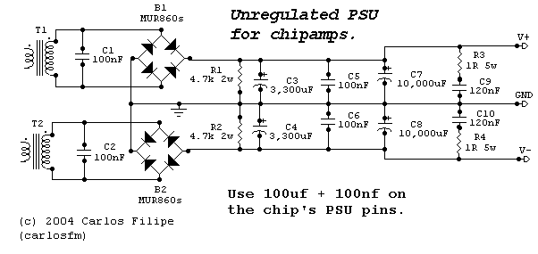

Unless I listed the wrong cap, 3x2200=6600. Three parallel caps per each rail. Calculations of voltage handling is from V+ to V- "as if" the caps are in series, which is how the tolerances are calculated in commercial power supplies. For example: The 43vac gets split in two, now two rails of 21.5v each, increased by 1.4 by the rectifier, thus exposing each cap to 30v.error401 said:6 of those in series pairs is only 3300uF.
theAnonymous1 said:I have 2200uF 50v Nichicons and 820uF 63v Panasonic FC that I can give a good deal on.
The 2200uF 50v caps would be safer than the 2200uF 35v caps and higher voltage tolerance allows a wider choice of transformer.
However, the approximately 34mm to 38mm tall 50v caps do take more clearance than the 31mm tall 35v caps.
Suggestion, get a larger case and use the more-durable 50v caps.
Caps in series divide. Two 2200uF caps in series gets you one 1100uF cap with double the working voltage. Put three of those in parallel and you get 3300uF.
error401 said:Caps in series divide. Two 2200uF caps in series gets you one 1100uF cap with double the working voltage. Put three of those in parallel and you get 3300uF.
Yes, and no. The 0v line is connecting at the centrepoint of the series caps, as is seen in the majority of power supplies, including this one:
EDIT: You do have an excellent point in that the chipamp sees only the difference between V+ and V-, therefore the typical power supplies may have greater working voltage tolerances and less capacitance than we would assume--like the Carlos FM supply below would max at 100v, but is actual 6,650uF. Even so, it seems sufficient.
Ah, I was thinking you were talking about per rail capacitance, as you normally see it discussed. I guess if I thought it through I'd have realized the voltage concern wouldn't have made sense then. Sorry for the confusion.
error401 said:Ah, I was thinking you were talking about per rail capacitance, as you normally see it discussed. I guess if I thought it through I'd have realized the voltage concern wouldn't have made sense then. Sorry for the confusion.
I thought you were talking about a comparison of single rails versus dual rails. In that context, it made good sense.
EDIT: I was trying to illustrate how the tolerances are calculated on commercial amplifiers to have them as small as possible--because of the very small amplifier enclosure.
And, we did cover it!! 😉
EDIT2: This was a good example of how the tolerances of parts can be compromised due to lack of 3mm of extra space in the enclosure. I'd rather go with better parts and the needed space to fit them.
Thanks again!!

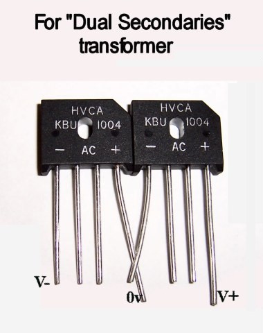

no, it doesn't.danielwritesbac said:
Detail:
Since the 4 amp rectifiers are in series, it makes one 8 amp rectifier.
Your arithmetic/advice stinks.
don't apologise.error401 said:Sorry for the confusion.
It's Daniel's use of very non standard electrical language that causes most of the confusion.
AndrewT said:
no, it doesn't.
Pardon me sir, but I'd like for you to look that one up.
Like this:
1 of 8 amper rectifier with a center transfomer
vs
2 of 4 amper rectifiers with a dual secondaries transformer.
It wasn't my opinion, but rather reference materials; however, I would like to know if a dual bridge is not actually twice as strong as a single bridge, and I would like to know, if not the 2x commonly referenced, then what figure is approximately comparable in practice? Thanks!

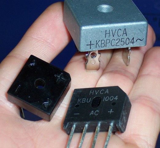

what was that about confusion due to non standard language?danielwritesbac said:if a dual bridge is not actually twice as strong as a single bridge
AndrewT said:what was that about confusion due to non standard language?
That was in reference to a 1 piece bridge rectifier unit, like these examples:
