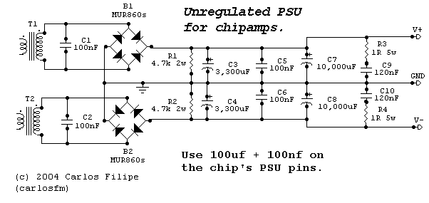

If you are using a computer sound card with 5.1 output then all you need are the amps- you are correct. No preamp, no decoder.
Most of the PC boards available are for one channel, which would allow people to buy as many as they needed for as many channels as they want. There is no problem. They probably only need to get a larger transformer and they could run them all off of one supply if desired- or as an extreme, each channel can have its own transformer and diodes.
OR a variation - the back channels sharing a power supply as they aren't as stressed usually.
If you are running them off of a soundcard probably ultimate sound quality isn't the goal so a single big supply would be most cost effective,

Oops! It seems that my suggestion was in error. Its not educational to use a 1 piece bridge (internally 4 diodes each).
Instead, its probably better to use discrete (individual) diodes so the class can learn the application.
Yet, you did mention using printed circuit board, so that does limit the educational value, either way.
EDIT: My suggestion was because 60 cents is better than the usual price. http://www.alliedelec.com/Search/Pr...N=KBU808&R=2660078&SEARCH=2660078&DESC=KBU808
Either if discrete or inside a plastic block, its still this thing (see photo):

I have a preliminary BOM written up. See attached. Shipping nearly doubles the cost of parts for a single amp order, so the more people you get in on the initial order the better.
The BOM includes the parts required to make a National reference circuit for the LM3886 (using the BOM from www.chipamp.com), plus power supply parts and terminal connections. It does not include the pc boards and associated costs.
There are several options in the power supply, depending on the desired power output and the nominal impedance of the user's speakers. For lower power applications, www.apexjr.com has a 80VA 42VCT toroid for $12.95. This should handle nearly anyones needs for 6-8 ohm nominal speakers. For higher power into 6-8 ohm loads, there is the 120VA dual 21.5V for $19.95. For full power into 8 ohms only, there is also a 100VA dual 25V toroid for $17.95. If someone is planning on trying to get full power out of the chips, you should advise them to run one transformer and power supply per chip (dual mono). If someone wants to power 4 ohm speakers, they will need to find a dual 18V or 36VCT (or lower) transformer.
