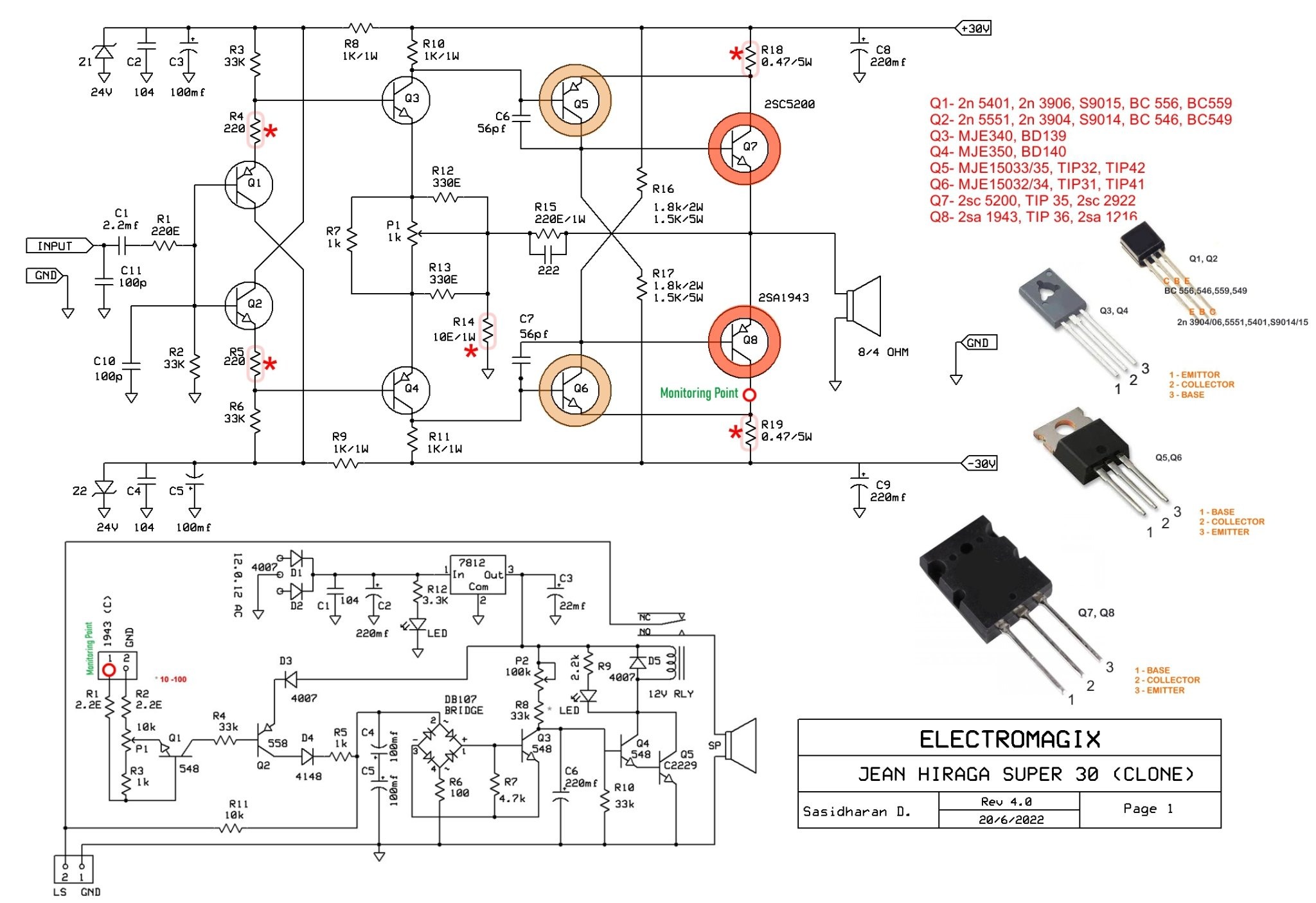

It would be much appreciated to show these circuits.overload, shortcircuit and Dc protection onboard

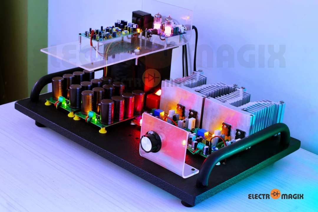

Sasidharananother version of my Hiraga !

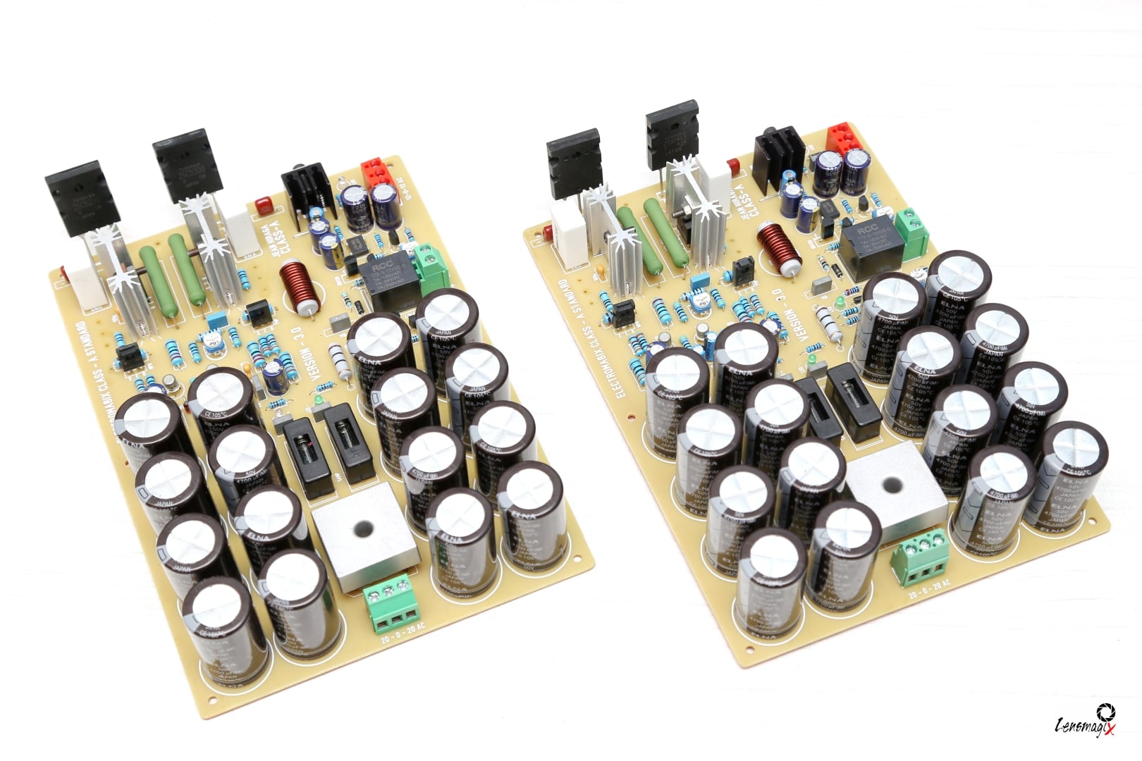

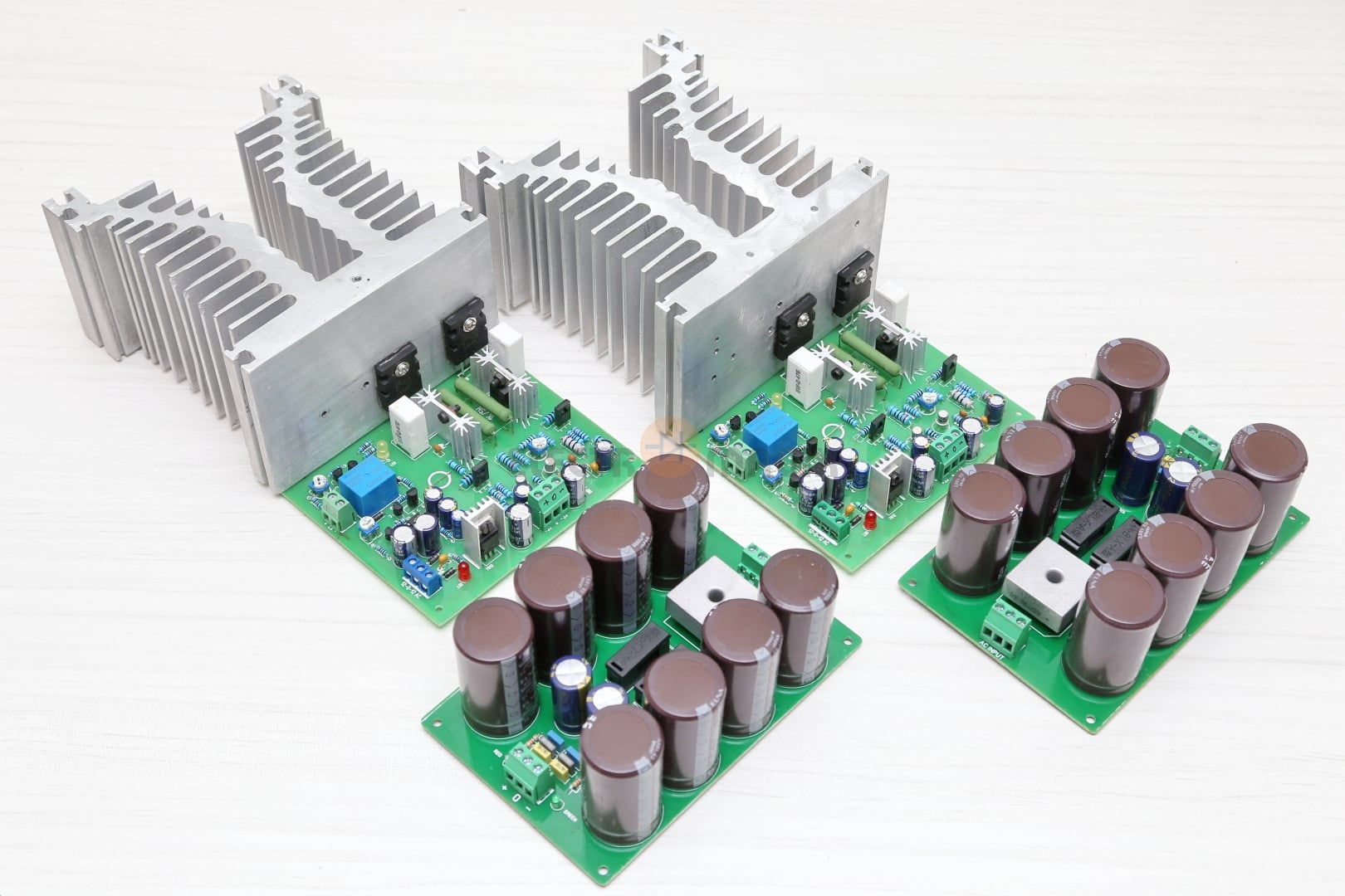

Compress your speaker protection section and spread your out put transistor so it doesn’t cluster out at one end of the heatsink. place the transistors at each spline, this will look adn do better for heat spread.

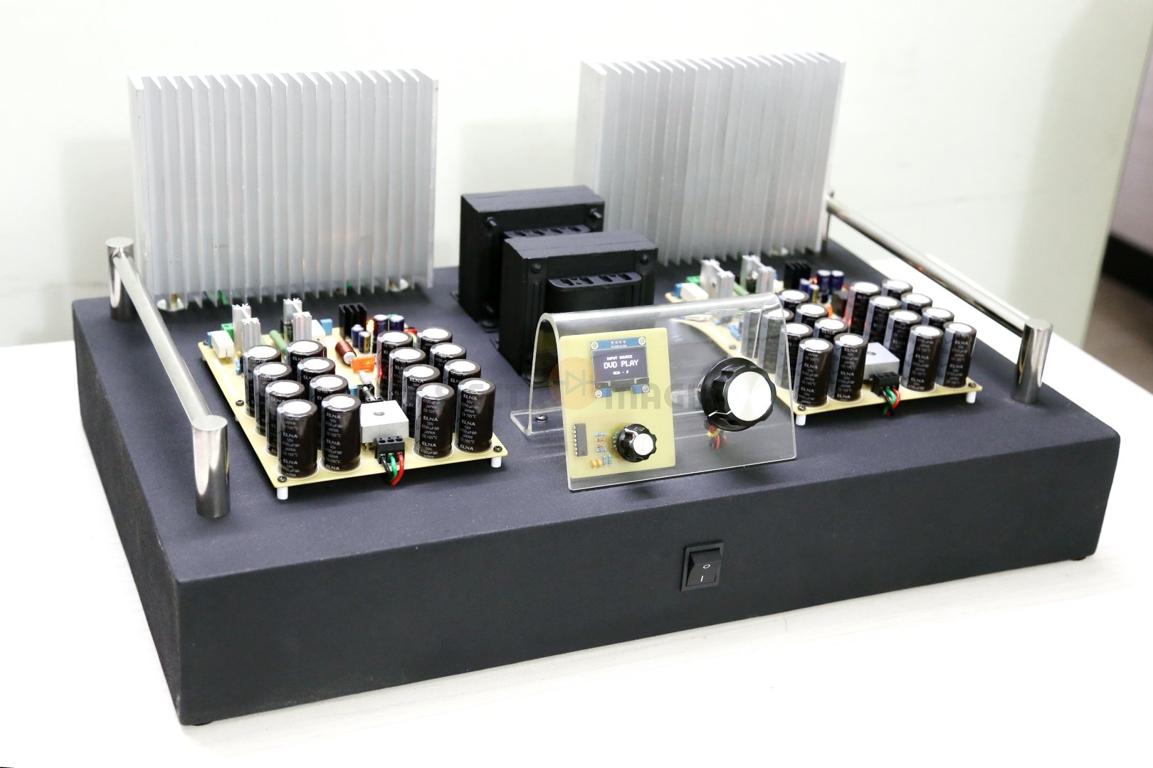

new Naked amp project ????
There's a Greatz involved!the circuit follows ! this will deliver upto 40watts/8E, 50watts /4 ohm load,
Hi Electromagix, Great diy building indeed, especially the "naked" version - never thought of doing that.

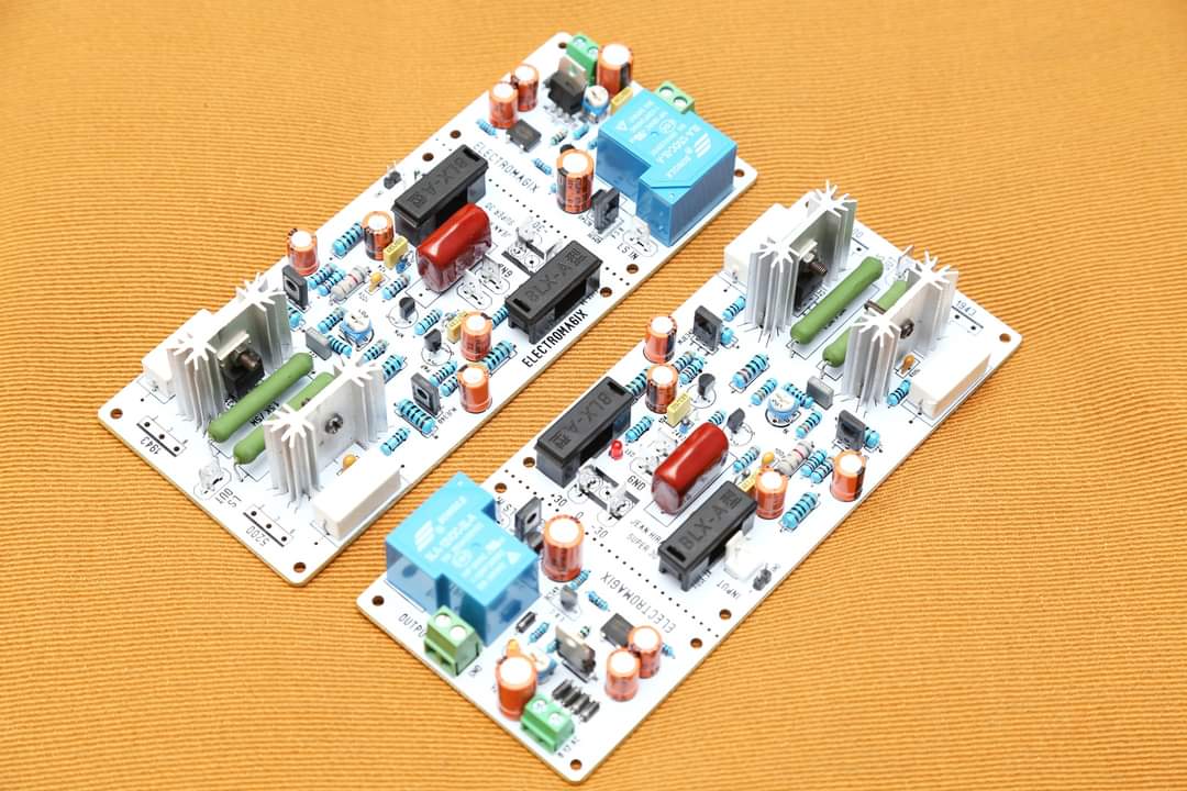

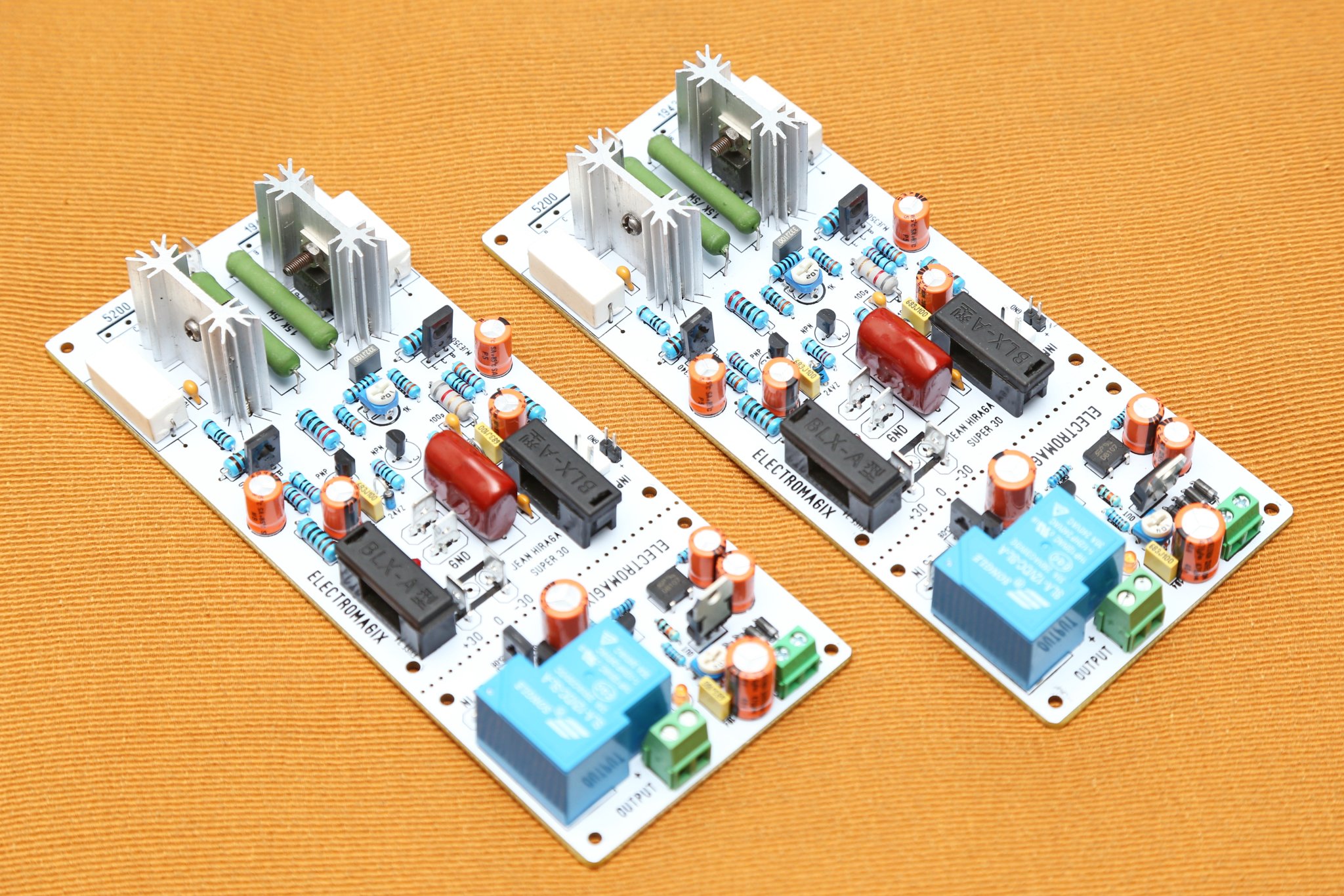

I'm a bit puzzled by the pcb design and perhaps you might enlighten me - the output transistors 1943/5200 are on one end of the pcb but the output terminals seems to provided via the delay relay (?) at the opposite end of the board, yes? Is there a purpose for this separation and longer tracking?
White board ? The pcb is breakable, some guys like to keep the relay section in the back panel, some on the side sink along with Amp. Spade terminal provided to interlink
Ah right, sorry - missed that

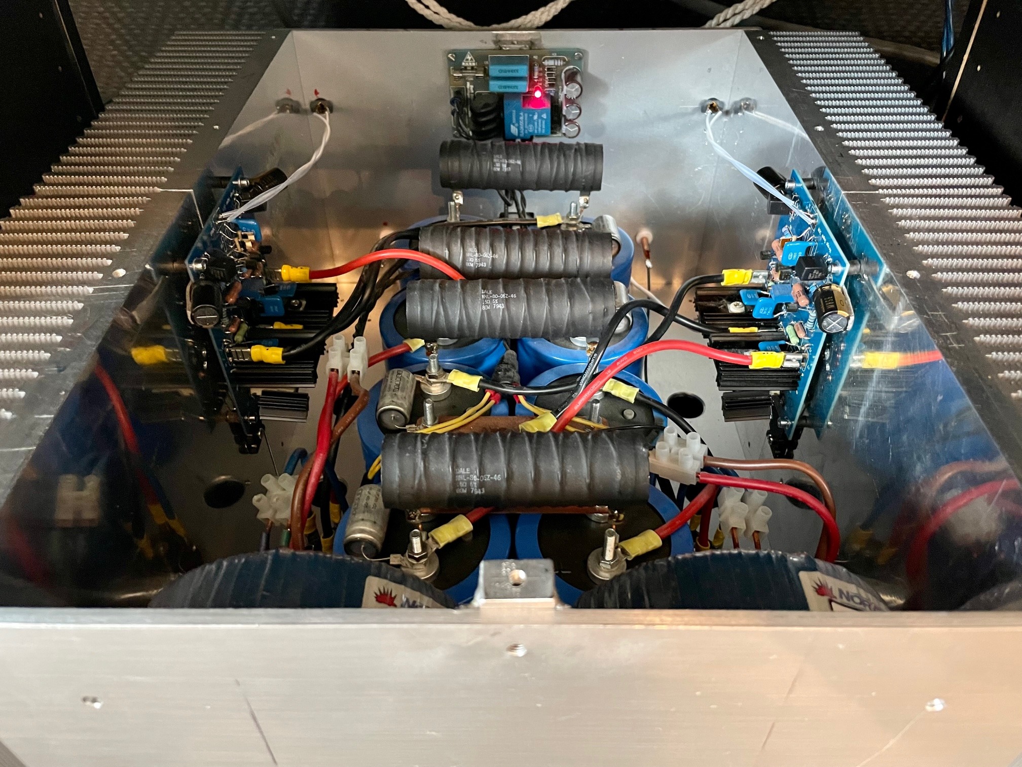

Hi, am back at my old loved Hiraga Class A after 101 days!!
So far there is who things I dont need in my hifi life, Nelson Pass B1 with Nutube and Hiraga with Kubota. Been there tryed that ( :

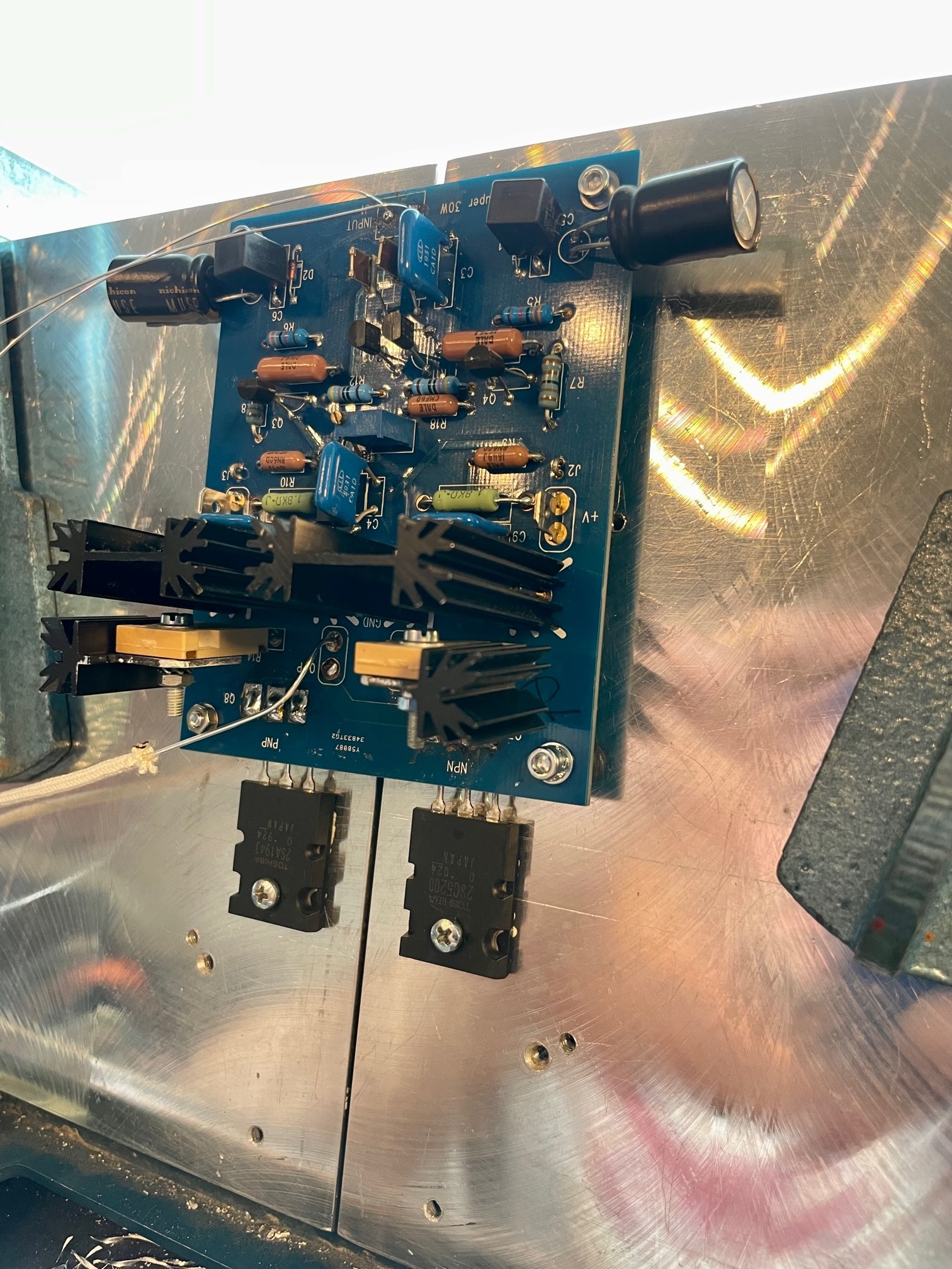

So I got 4 new transistors (1943 / 5200), change the 180 / 240 Ohm resistors ( Dale RN65 ) and the 300 Ohm resistor ( Amtrans AMRG ).
So now it plays again, lifted the pcb 5cm + so transistors no 1/3 up from bottom.

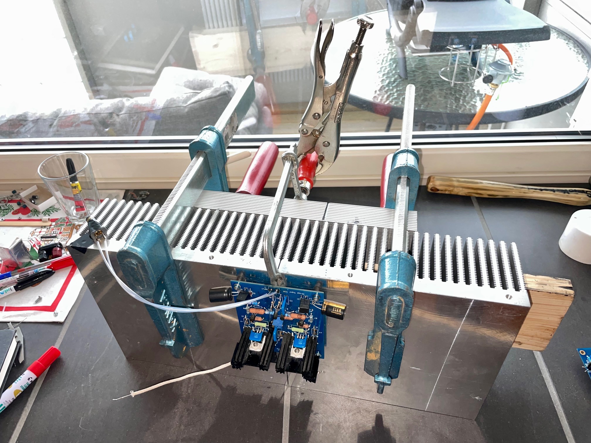

Not sure those split heatsinks are a great idea... a copper/alu plate underneath for heat distribution would help
- Start up Hiraga 30W w/Kobuta reg
