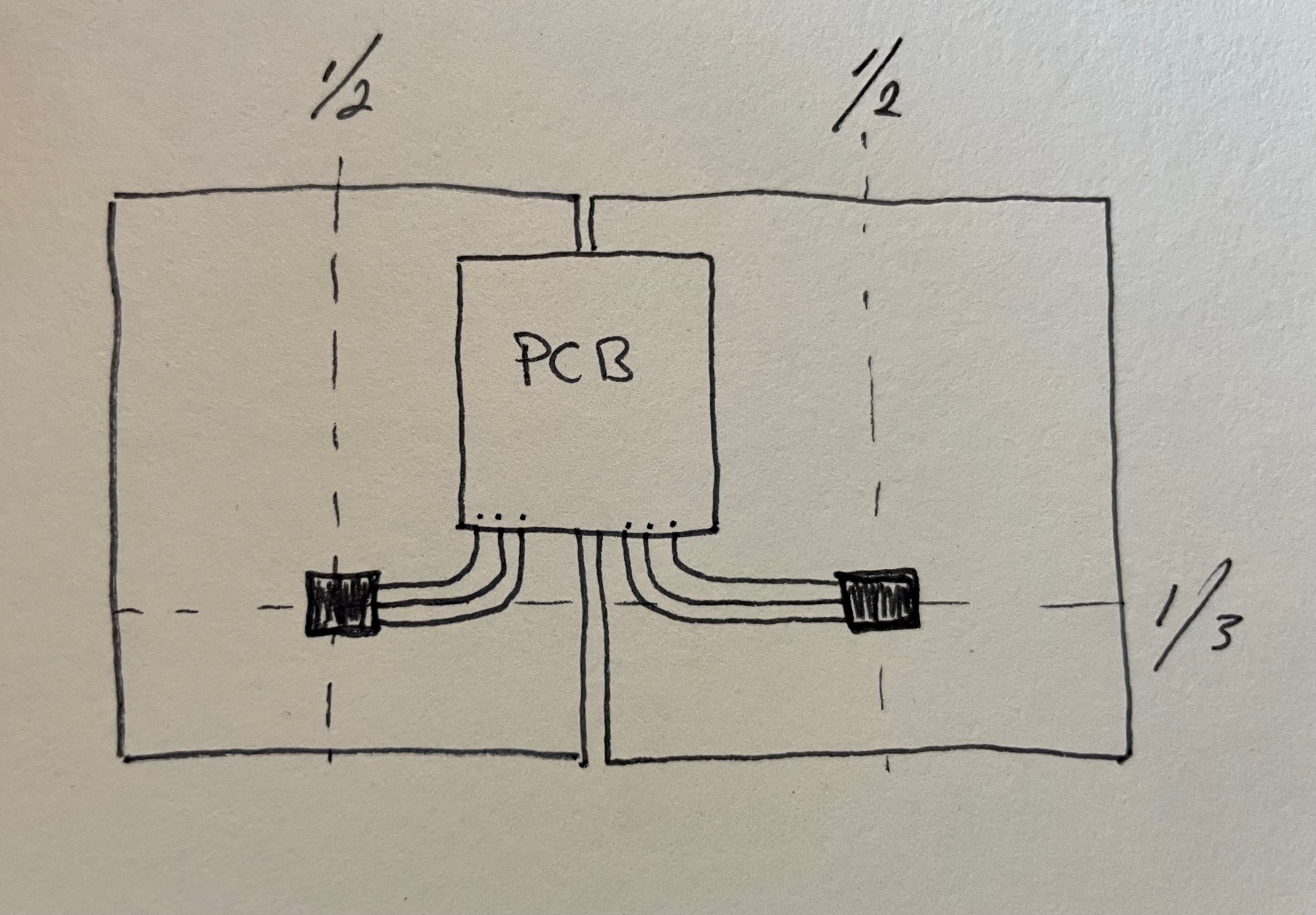

Mounting should be approx at 1/3 from bottom for most effective heat transport.
There is a marking line scratched already.
Use thermal paste as little as possible: it only has to fill in the (near atom size) gaps of the metal, or use silpads.
If applied as peanut butter, it forms a heat isolator instead.

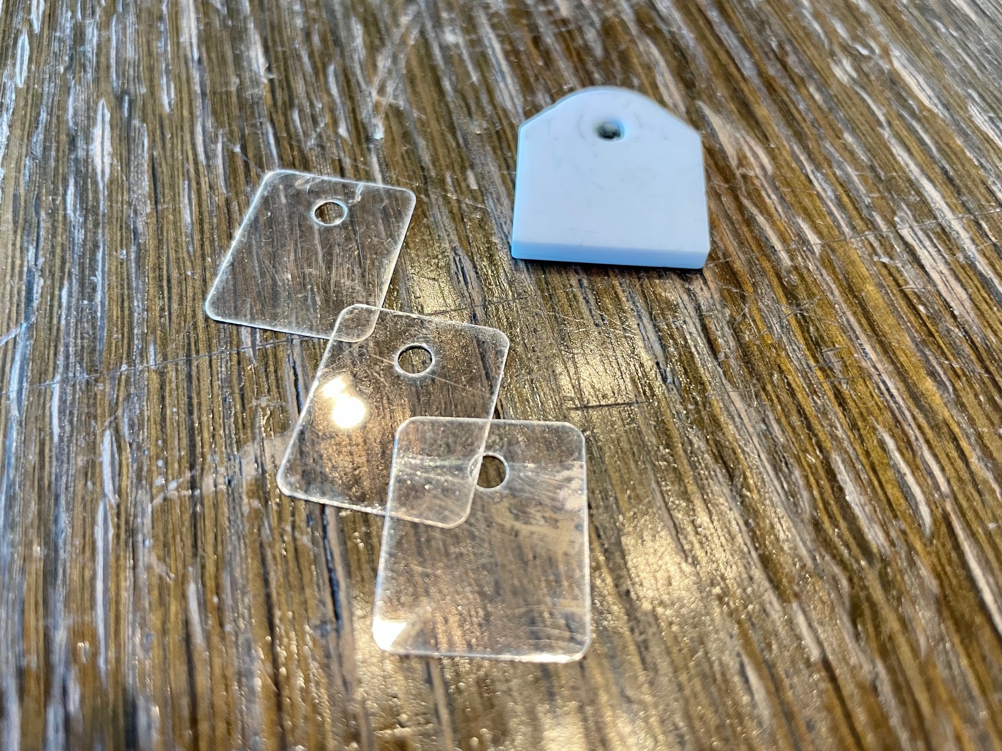

If I observe the pictures right, your thermal resistance between the transistor case and the heat sink is much too large. This may explain why your transistor case temperature is too high. Follow the advices from Citizen in the former post. It is not anything wrong with th transistor couple 2SC5200+2SA1943; I have used these excellent transistors for years without any issues.
knutn: You mean the ceramic isolators is to big or to thick? I have not taken temp on the 2s transistors ( I think ). But heatsink got 55 degrees ( with Hiraga 30w without Kubota ). Kubota version got only 35-37 degrees.

The mica's are ok, use very little thermal paste: the less the better, both sides.
I cannot imagine where the ceramic slab is used for. A tombstane for dead semi's?
Shrink tube is teflon, and perfect to withstand the heat.

Teflon heat shrinking tube over (tinned) copper wire. Bend first, then shrink.
Silpads does not annoy like the (breaking) mica's and polluting paste.
Even better thermal specs. Preferable.

Ceramic will be near glass and concrete.

I would use 1mmq tinned copper wire and suitable heat shrink tubing. That is also made of teflon, but it shrinks and I do not know if your teflon tube shrinks. I like it better that way. 1mmq can handle 10A (domestic safety rules), 16 for industrial. 0.75mmq is 6A domestic and 10A industrial.
But in general, as mentioned by AFC, the longer the wires, tho larger the antenna (transmitting and receiving.
Can you not just shove the pcb as is upwards? Point is the have the semi's at the right place (@ 1/3H), the pcb is of a minor issue.
Or with the semi's @ 1/2H, have the pcb's downwards, also a good option.
I'd prefer to consider the length of the legs of the semi's as a max stretch.

Good morning, I go for the no cable mount. Rise the pcb 50mm, then im spot on at the 1/3 H.

AFT: Thanks, they are contacted against same bottom and top plate. But I can take them to work and tig weld them together.
But maybe its ok as is?

Citizen124032: No, weld the two heatsink together. But thats maybe not importent, may just leave it as is.

When not weld together, the thermal separation is better. Unknown of this improves electronic stability.
Knowing that the MJE-drivers must be separated from the output semi's, my intuition says have them all separated.
If one component is thermally deviating, the local feedback (Sziklai) and overall feedback can act more 'direct'.
