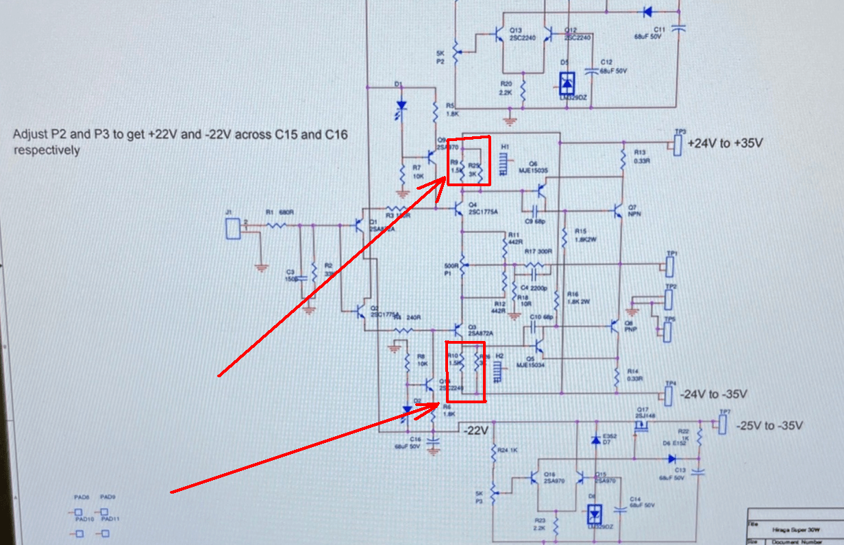

"As I remember I found the correct value by inserting trimmers, adjusted to correct, took trimmers out and substituted them with resistor."
You mentioned this, but are these resistors of the same value? In the circuit 1k5//3k0 are shown.

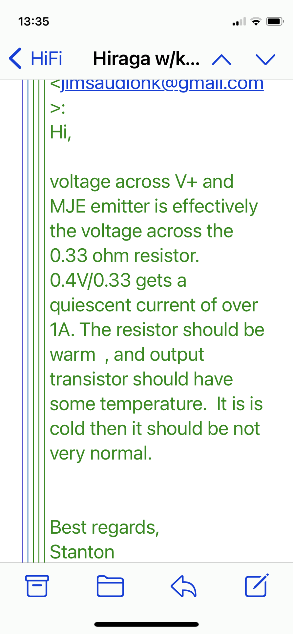

amplidude: I see you have the Kubota version, What do you messure over the 0.33Ohms?
I think I go back for the 30W without Kubota. It plays in class A that it suppose to do.

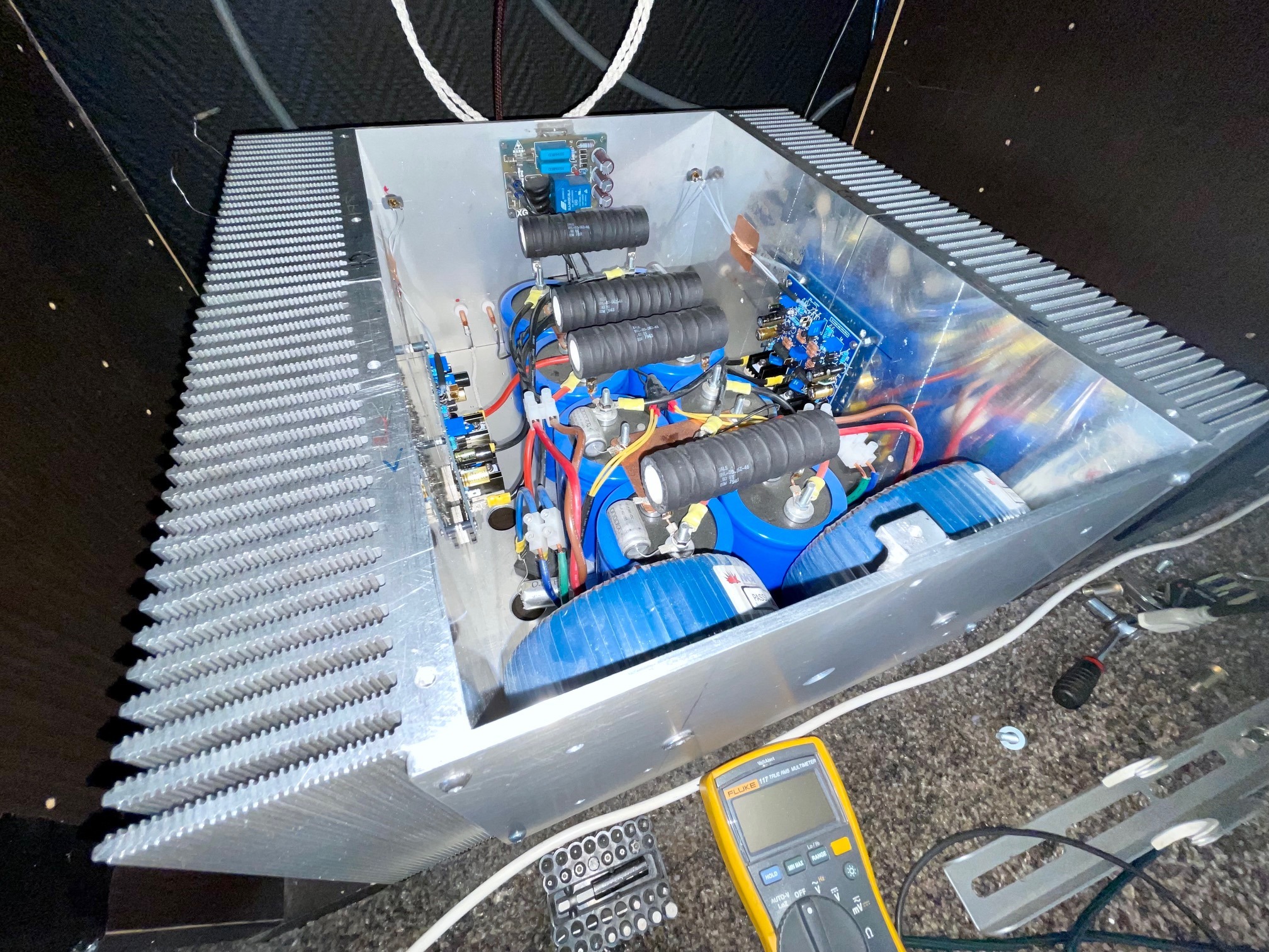

Hi, nothing realy. Sound good, dont get warm. All good ( : Its just that it bother me a tiny bit, sold as Hiraga 30W class A with Kubota regulation.
But, it dosent run much in class A. Dont run warm ( as real class A does, high bias ), dont consume any wattage at idle ( 29W compare to 300+W ).
I want my class A back !! As we know, thats the ting ( ;

Please take a look at the red arrows. Remove those resistors (4Pc), Use each side one 1K multi-turn (15 times) trimmer pots. The middle pin of the trimmer connect it together with one of the (bend and solder it) pin and adjust it to max (1K). Solder both trimmer the same way to your PCB at the place of the Resistor R9 and R10. Turn on the amp and start each side to reduce the trimmer by half turn until you get the required Bias. It is easy. After you set up you can replace those trimmers with resistor or you can leave it like that. That is how I set up my Le Monstre and some other similar amps.

It does not get warm, but I got big heatsinks.

632mV over R9, 402mV over R13. Leaves 230mV over Q6be. Same with Q5be.
Where's the idle current (1.2A!) through Q7/Q8 running from? Q5/Q6 twisted legs?
This kobuta and Q9/Q10 additions go nowhere. #20, last line.
If Q5/Q6 have only a Vbe of (approx) 0.23V, they not conducting.
If they're not conducting, Q7/Q8 should be closed too.
If you still measure 400mV over R13/R14, it means there is a current of 1.2A running through them.
But where does that current go to if Q7/Q8 are closed?
The only other way is through Q5/Q6... so they're broken or wrongly placed.

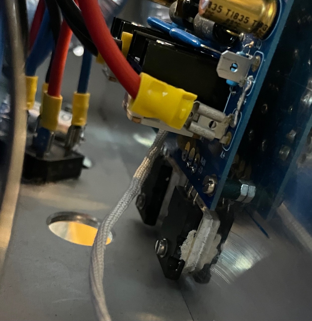

I check the MJEs, if Im lucky I can change and the amp is back up again.
What I think vent wrong was that I shorten leg 2 and 3 on the MJE.
Frank

Now to decode your "leg 2 and 3 on the MJE": that will be Q5/Q6 but check Q7/Q8 too!!!

Good morning, the MJEs and the 2sc5200 / 2sa1943 is broke.
Got constant bip ( diode reading with bip, FLUKE ) and reading 3mv on one of the 2s, and the adder no reading at all.
Tested with a good 2s and that give me a singel short bip and read 513mV
