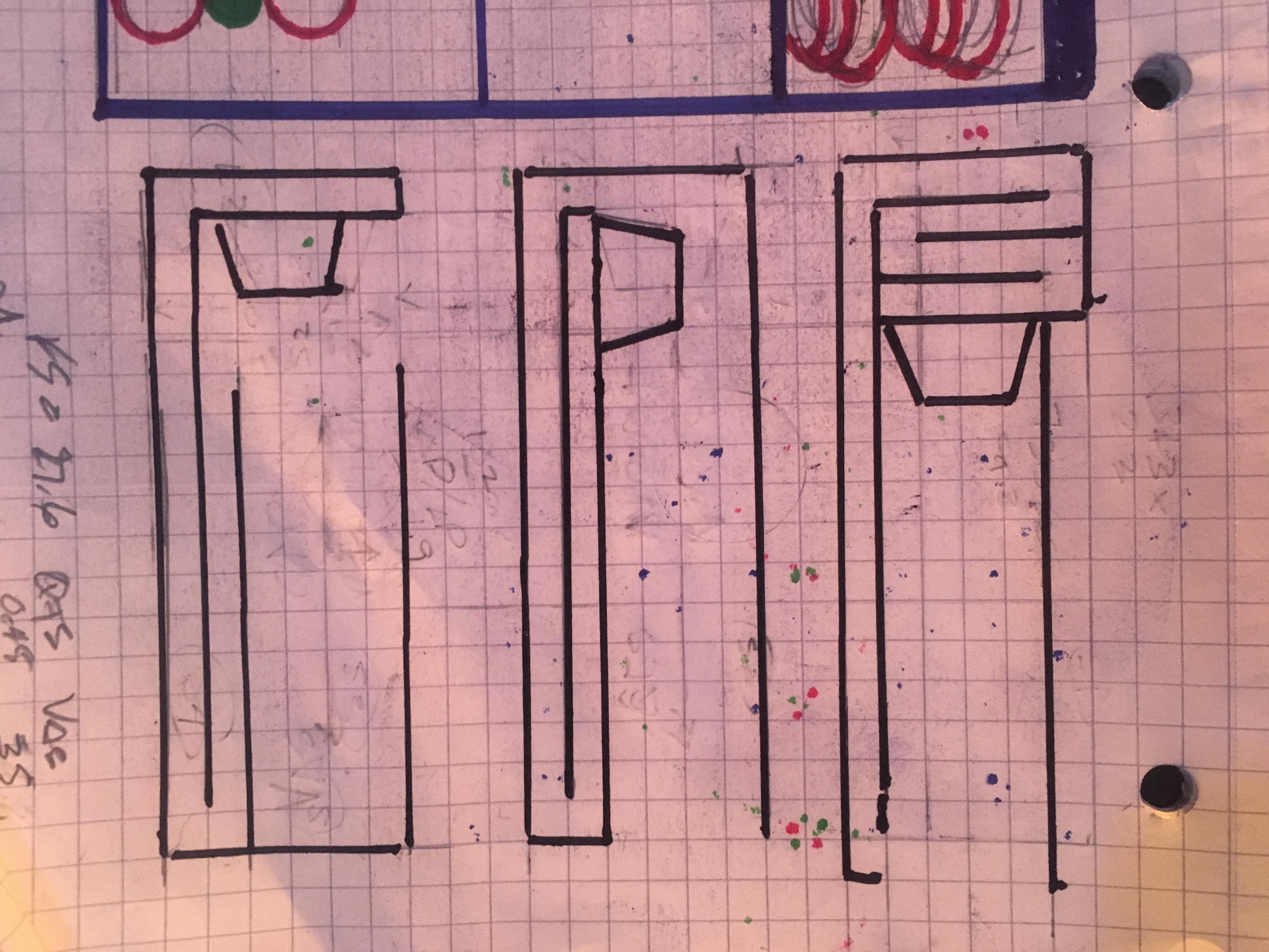

All of these(pic) have a unique sound to the upper subwoifer freqs. ive made a couple of each and various 4th order versions. I think if i had the ‘folded’ segments closer to making there own fundamentals as a integer of the longests Fb, then thats a lot of magic in certain areas of the bandwidth?
But ive missed the mark or ive skewed that alignment up over and over(some way widde than others) and taper/flare, or different lengths has always been uneven or an issue?
Can i still tap this fir the help in moving all this air in a series or similar manner? And if i keep it inside folded in a cabinet instead of ‘path’ seoerstiom
N of the Square antenna shape is the missing link to 3/6/9/12 gone?

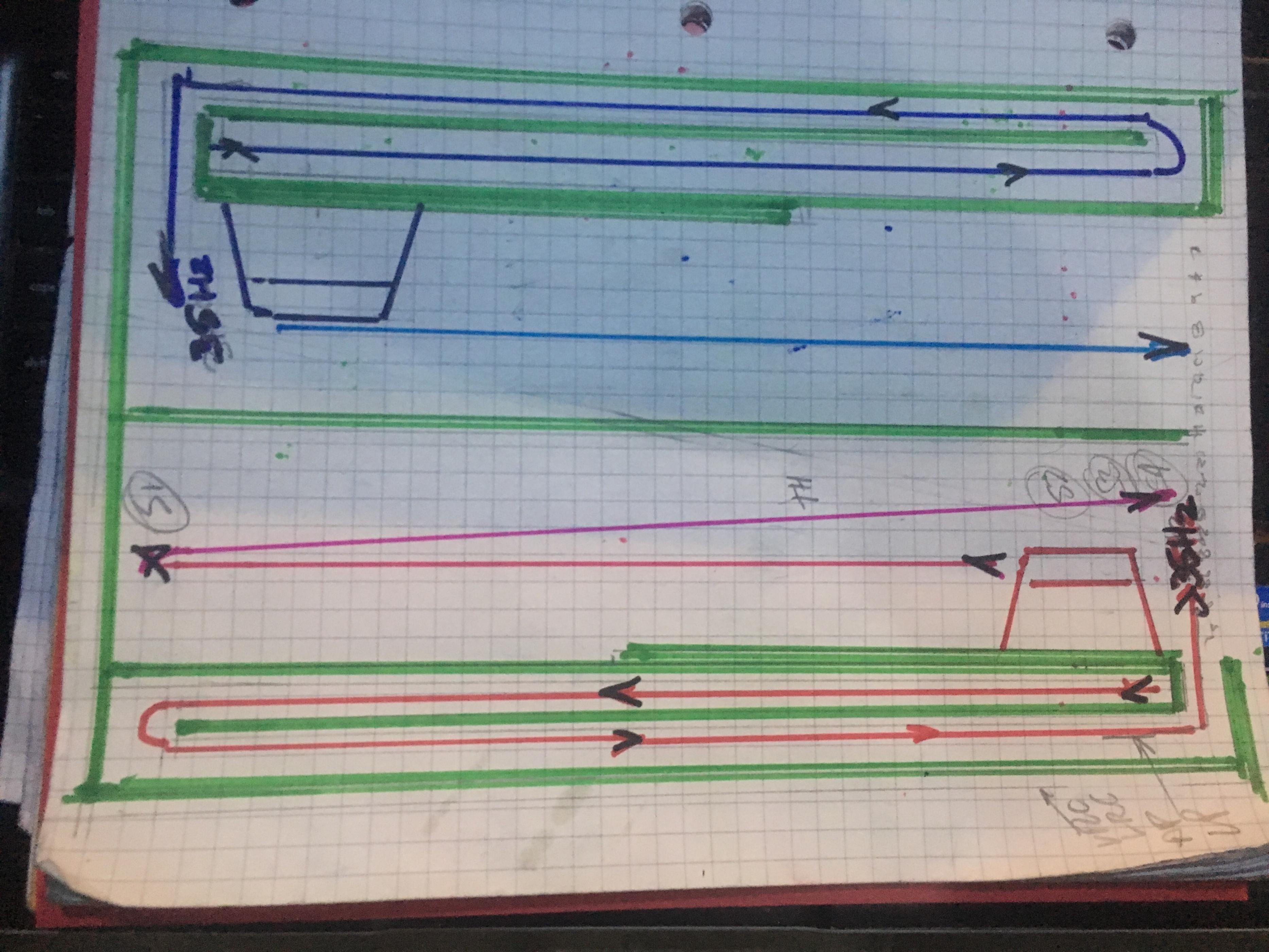

Yes! This very thing can be heard and shown. The top and bottom layouts are nearly identical if given the same lengths and csa dustributed. But the offset(bottom) is causing a out of pass band narrowing thats an obvious ad a phase shift occurs at the point of exit (and seen in sim).
I think ive repeated this in the middle example, but ive given the result already its now just propagating a wave thereafter(tapped) and i think its missing the high frequency (ghosts) i clearly hear in the bottom version as it disturbed things like no other around the room or anywhere i took it(which weren't such a issue with any others (higher frequnve tune in that shorter chamber has artifacts??)
I think i can improve upon the middle. Align the folding to intervals of the main Fb, but what to do? the results in sim say the same thing. These are all so very related. (Sim doesnt show that folding component and its interesting ‘advantage’ in science, nit necessarily ‘perfect monitor speakers’.

An intersting thing happens in these. And it was the reason i had ‘optional’ or ‘second’ drivers drawn on the opposite end of the larger segments. the high frequency bleeds out of those and isnt well represented in much of a sim as it seems to be in reality. after quite a few attempts to eliminate standing waves, i thought about ‘using’ them or the strategy of placement at useful intervals.
i think between myself and a few local diy guys weve tried (experimented) with nearly each offset driver, splayed driver, and stub. prettt much running into exactky what you pointed out in the partial cancelation and phase getting flipped and flopped band and forth (defeating itself along the way).

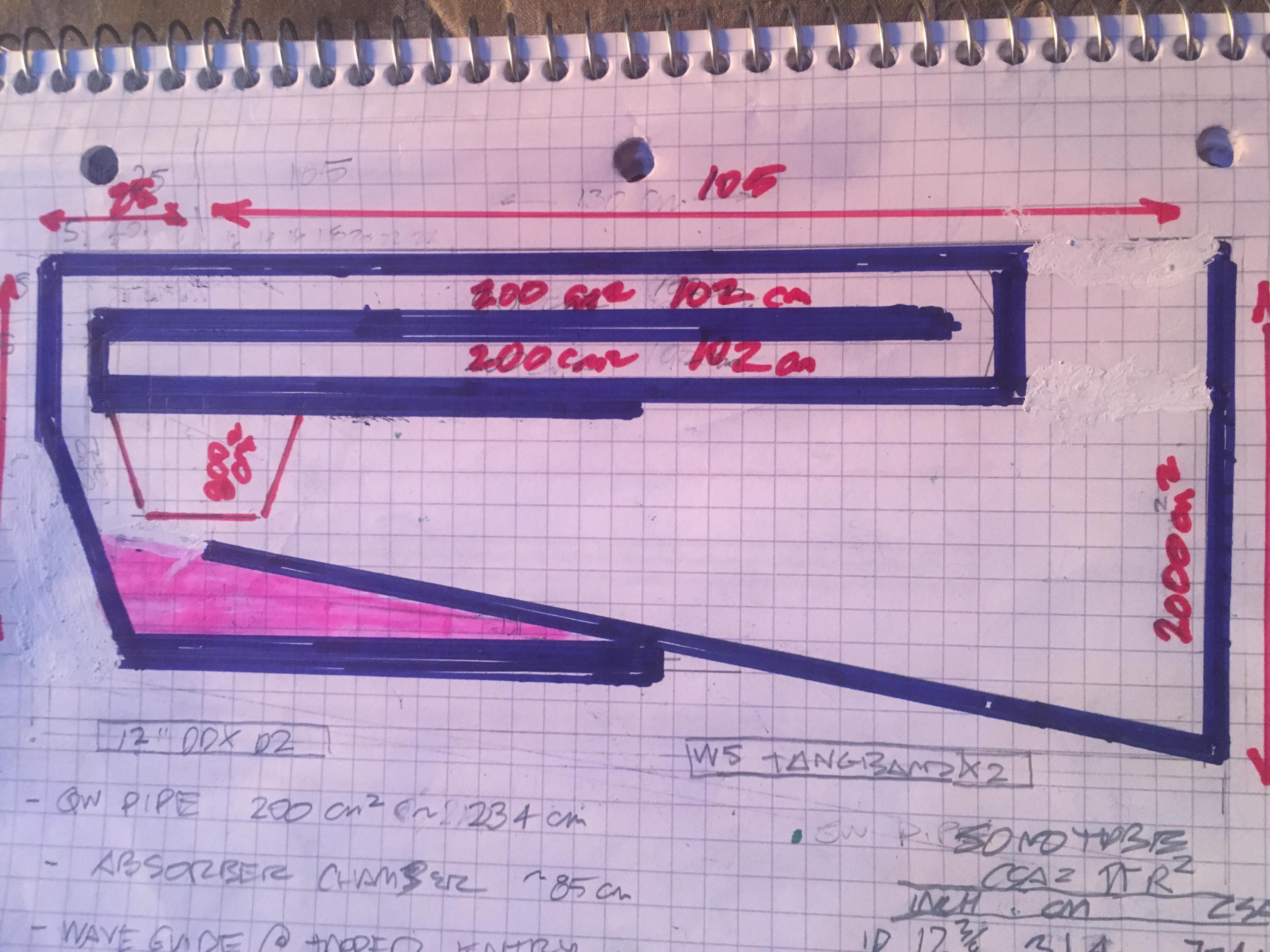

Hard to say if the pink area(polyfilled) is useful or wasted space in a sim but i was considering two of these (mirrored) with a shared exit at the very end. Whats hard to tell is if a flare rate keeps the upstream Fb or changes it and what to use for lengths if striving to keep the harmonic intervals as folding or segmebt/stub lengths for the system Fb

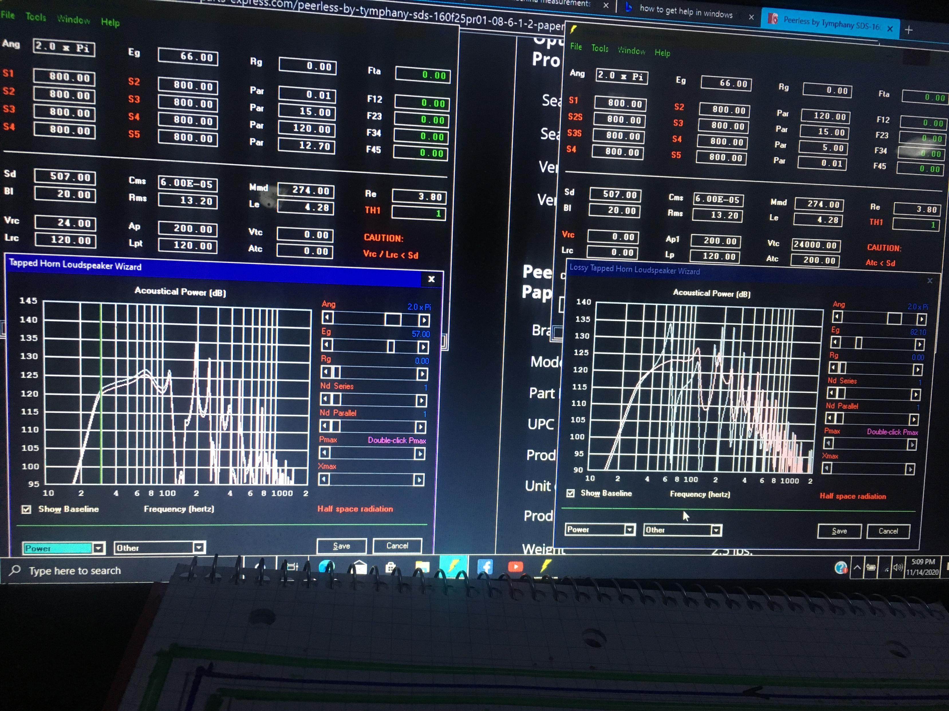

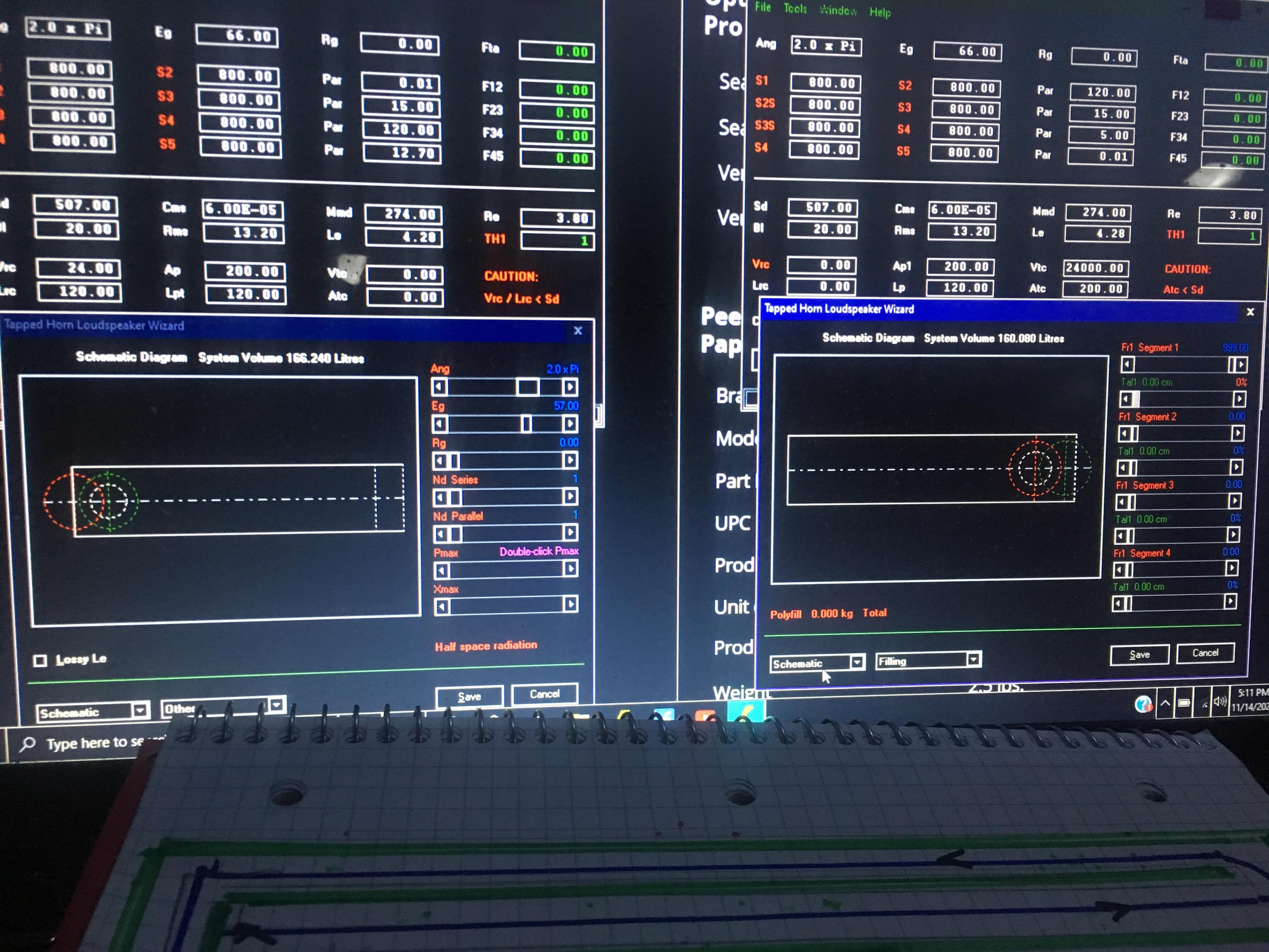

These are the sims from above. red is the right hand examples and the large chamber is stuffed. The blue isnt. i also need to determine if Fb requires a triple fold in the long skinny to suit the harmonic scenario based on Fb(the wave cannon thread you shared Greg).?

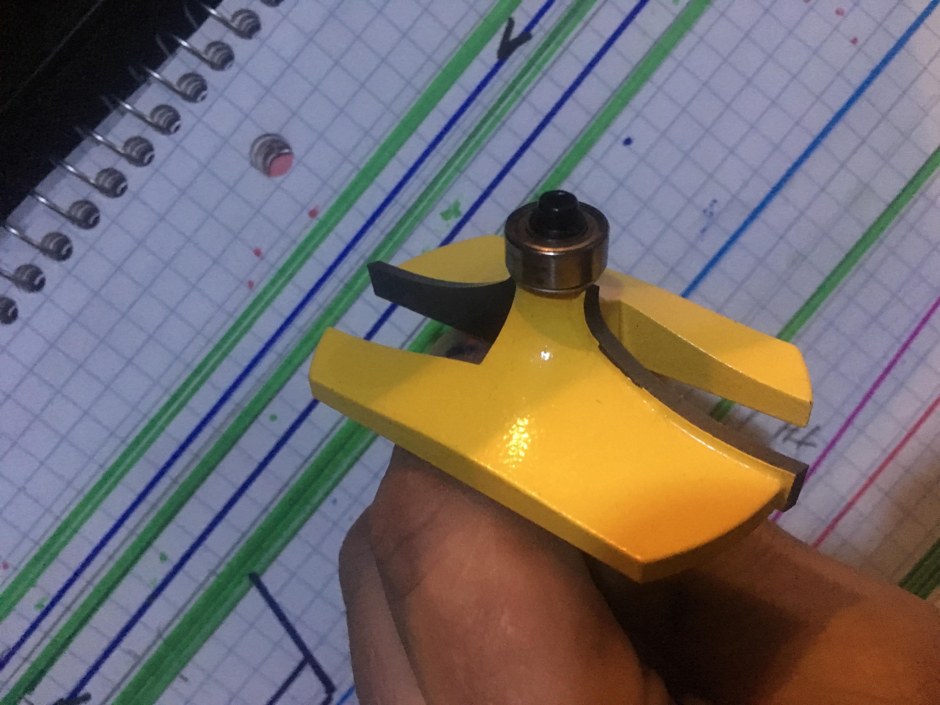

You can ignore the TH1. It was only there, as you said, for playing with a mass loaded end cap(a buddy wants to stick a couple of these into a coffee table and for HT. I tried it previously and ir was great. I used a huge thumbnail round over bit to smooth out the terminus as it otherwise was getting a bit noisy)#
