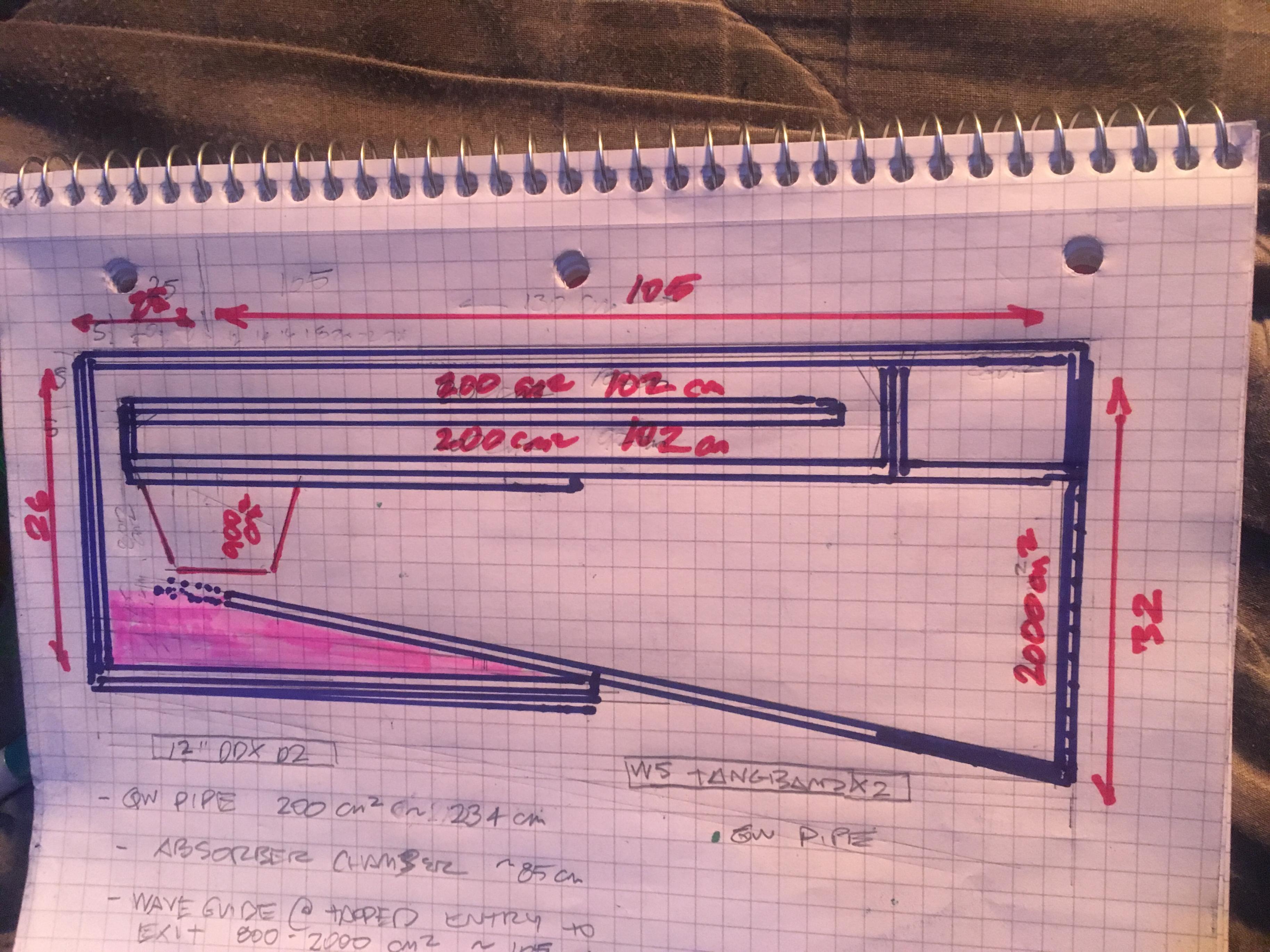

Somehow i wanna get this turn to float🙂 maybe leaving the damping up to the second driver area wasnt enough. but it was easy to stick a bunch of polyfil in a closed end pipe and shove it in the big mouth(especially if its length was at a harmonic integer.. but then the mouth (response) seems to be smoother again as a result you wanna make it even bigger and longer..as excursion allows more too! . lol!!! We will never beat the need to fuel the Addiction, all this ‘bass’ and mid bass or infra bass or anything bass is a drug. Its powerful!
This is why i cant use ‘path’, i want to use the tapped drivers polarity shift point as a potent tool / advantage. so i shorten the end legs and add that back as a chamber to which all harmonic intervals are being represented and in such a way that they SUM quite nicely, but also can be seen in Horn response all the way up and the scale clearly. Lined up colums between each with defined edges.
So if we make blue a small CSA and yellow a bigger CSA
See that ‘signal strenth’ on the far right? gets all skewed with a taper or a flare, becomes a CAM LOBE of sorts? Or a twisted/knuckled rocker ratio? I dunno, but it screws up the ease of aligning sections( as colors ) to certain lengths that add up to the fundamentals result. but i have seen the flicker of that being possible??? I think i (Heard it?? ) I must do better or im stuck being annoyed with the stalmate of ‘Covid’...and thinking and wasting too much wood or time on the computer avoiding the ‘thinking’..

Synergy. I guess thats kinda where this went. I had (as usual) no tight focus
Or specific plan, instead many.
Take the 4th order qw pipe response for the TS parameters and ‘exploit its art-tributes with minimal damage or unreasonable stress/strain.
pipe segments and those together being a variety of contributing standing waves (by design) , i suppose?. With some guideance, some luck and great links to much more than ‘luck’:cheers: you make it fun Greg, thanks so much. I will pay it forward, pictures, patents and pressure waves. and even a coffee table with dual opposing a friend seems to be shuffling around to fit into a ‘size’ of box

A very restricted to a location, another version, using horn response: offset driver, offset port to exit is two chambers at start and ‘finish’, a lot of ways in that sim to kill pipe resonances or promote them.. tapped horn, with Throat ported entry. Venting internally into the system to ‘infinite tapered’ dead ends, a very long, thin and stuffed qw or hw absorber version is that way too it seems.
For an Fb of 40hz i used a constant CSA and split the orange in half -‘as it lands as a 180 degree fold of that in distance. Yellow is offset driver position and green is the large chamber to exit after the driver.
In horn response the fold isnt implemented its the Vtc/ Ap1, change. or it would be. but its obviously spread harmonic intervals of 3n with out. its a not easy to ignore a basket diameter or variety of details can derail this phase aligned more and more... but the looking glsss isnt blurred with a taper or expansion rate...

The orange areas split as a CSA shift or not, at a fold will be how that gets dispersed. (0.46 Fb in Qw) at the CSA, plus the same, ran thru a dual spring rate calculation is roughly what i used. But it was easier to find a realistic value for S using Vas in the TS parameters and use it the entire length of the Fs(for Qts) with a single assumed fold. The driver was cooperative... Then you can size the other side to clear the pole vent and adjust for ‘realty’ in a sim or otherwise.
If i repeat the process in many variety of dual chamber or similar compound or series the same results from the same generic sizes in progressing air mass segments happens. (it seems) so far.
