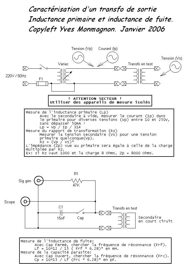

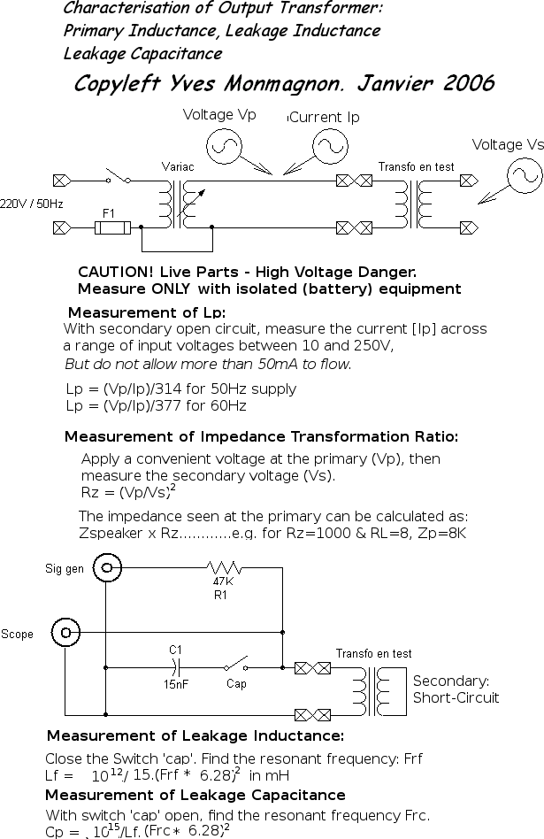

I do suspect some measurement error. But transformers with excessive leakage inductance do exist, and you could measure it (which is fun).
Use a resonance search with a handy cap value (10-68n), and do as our Forum colleague Yves would do: (thank you Yves, for the copyleft!):
You can blame me for any errors in the translation.

Why the 50mAac current limit for the test of Lp?
In tests 3 & 4 for Lf and Cp,
what do we look for on the scope to confirm peak of the resonant frequency?
Minimum height of signal, or maximum height of the signal?
It's connected as an L-C parallel tank. So at resonance, the impedance is very high, and the 47K series resistor drops little voltage.
Therefore, seek the largest amplitude.

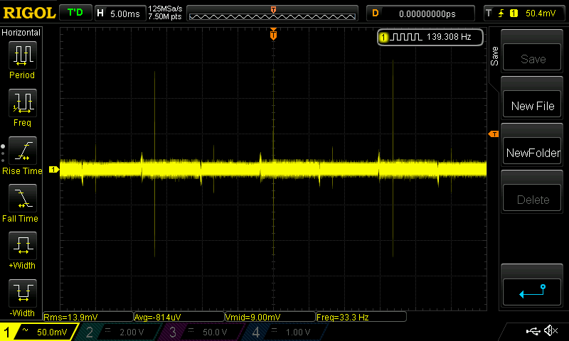

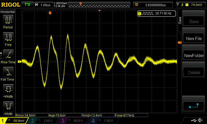

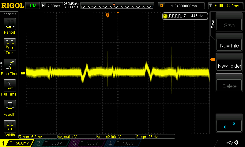

Tried adding R1, C4, and C1 and got unexpected results. I used a current transformer (B64290P37X830 EPCOS (TDK) | 495-3874-ND | DigiKey) to get oscillograms below. The first image is without any R,C,L between PT, rectifier and choke. The second image is an impulse from the first image in all its glory. The third image is with R1 (100Ohm) and C4 (50n). The fourth image is with the R1, C4, and C1 (1uF), and L4. Is it possible that C1 and choke L3 resonate?
I used stealth Fairchild diodes, C1 BFC233810105 Vishay BC Components | BC1576-ND | DigiKey, tried various caps for C4.

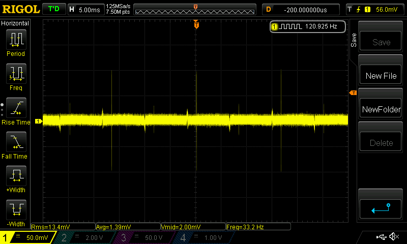

Diodes are ISL9R8120P2. PT is custom made Heyboer with 440VCT @0.1A and 440V @0.2A secondaries and +/-10% adjustment on primary. At the moment its running 2x6E5P @ 13mA each plus 13mA resistive shunt on 440V secondary (40mA total) and about 17mA total on 440VCT (10mA OA2 tube load and 7mA shunt). The transformer does get a little bit worm after 2-3hrs.
I put 12 turns of 40AWG on the current transformer.
I tried 0.1uF and 22nF for C4 with 100Ohm and 200Ohm with the same result. I will try larger values and I will post results later today.
I see two types of impulses on the scope:
- one is very short with about 200mV amplitude on image 1 (also image 2). this one gets stronger to 400mV with introducing C4, R1.
- another one is with much smaller amplitude. This one gets really bad with introducing C1 (last image).
PS: some or all of the results may be just user error.

Yes, the first pulse in image-4 is expected - adding C1 (1uF after rectifier) will cause some turn-ON forward current to flow (the traces are measuring current, rather than voltage).
The optimised snubber can be tuned until the ringing after this first pulse is damped out as best as possible. I would certainly expect to improve on image-4.
I suspect that the Fairchild Stealth diode may be a little over-large. The capacitance increases in bigger diodes, and tuning the snubber may well be easier with UF4007 diodes (very cheap). These are my usual choice for B+ rectifiers, and the Trr of 75ns is OK.

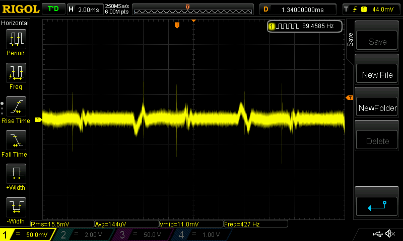

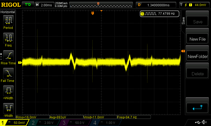

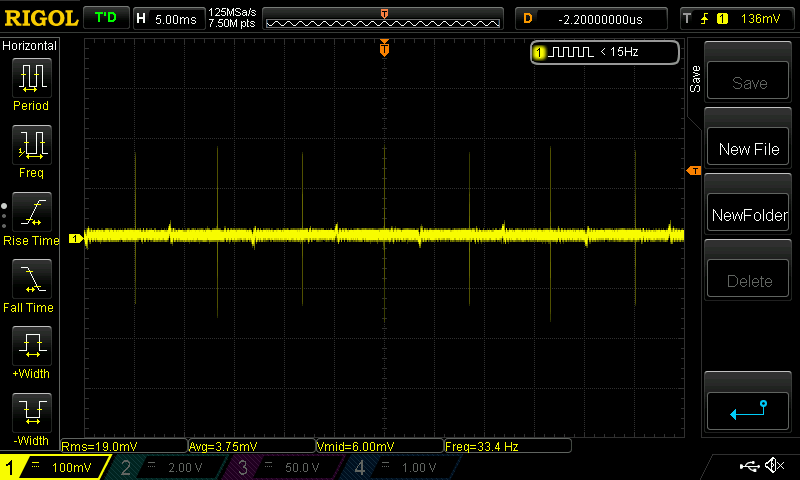

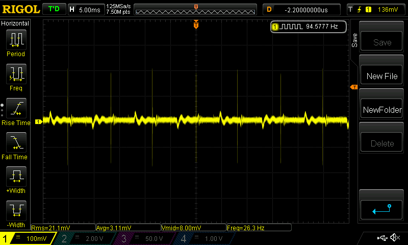

Received UF4007. Pretty much same result. The first image is with ISL9R8120P2 the second is with UF4007. Both with no RC added. My filter is LCRC.
I tried with various caps from 10nF to 0.1uF and various resistors from 100Ohm to 2kOhm. The first image is no RC, the second is 100Ohm 68nF and the third 100Ohm 22nF. C1=1uF. The first image looks cleaner and not much difference between 22n and 68n.
Is it expected? What can I try?
