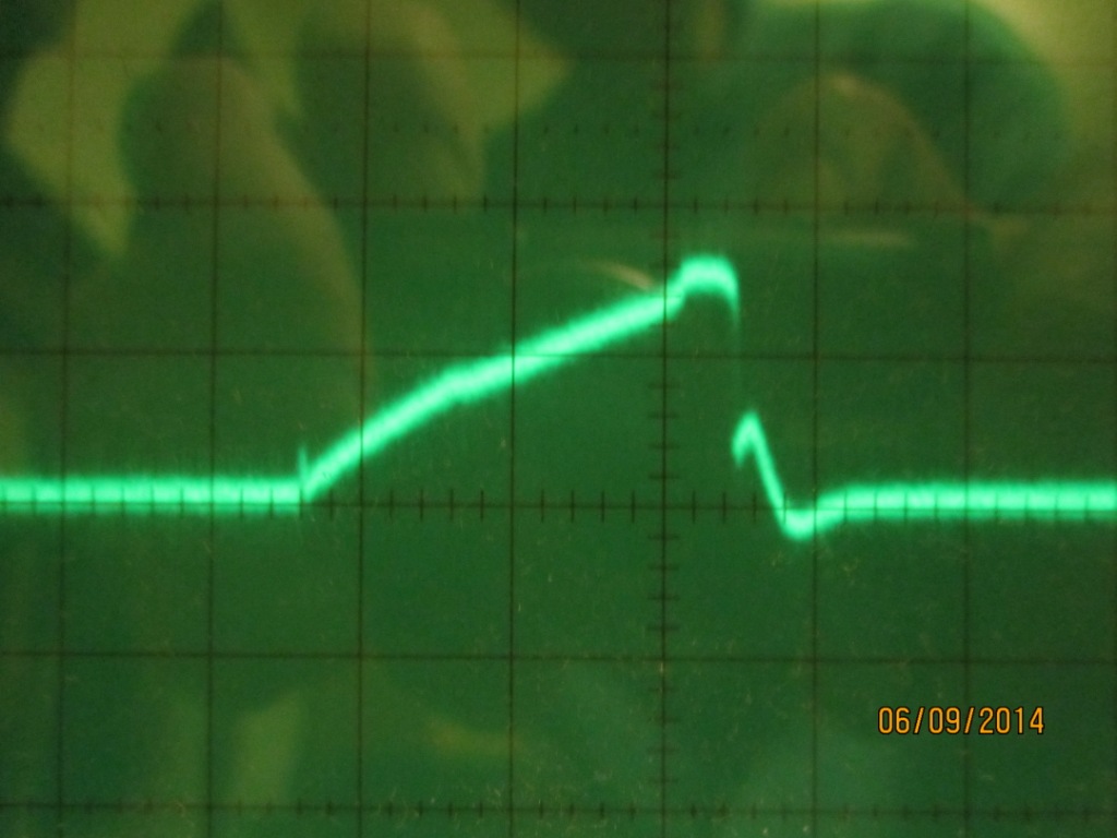

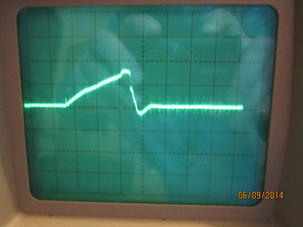

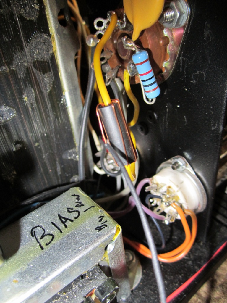

I made and fitted a sniffer coil, and measured the attached. It looks not far off critically damped to me with 2n2 ceramic (2kV) + 10kR (0.1 mV/div). I may try lowering R a bit, and make it a carbon comp

very good Paul.
See how the current ramps nicely (compare SS with cap-input!)
For best results, choose a toroidal ferrite made from a coupling-grade ferrite (will have a AL value in the data sheet).
Suppression grade ferrites (data sheets show losses versus frequency) may cause a loss of high frequency information. I suspect the sleeve you have there is a suppressor.
Nice toroidal core, costs only pennies:
B64290P37X830 - EPCOS - FERRITE CORE, TOROID, N30 | Farnell UK
ideal for snubber caibration.
Hi Rod
Yes it is a supression type, all I had to hand. But it was good enough to have a look at the primary oscillation of interest.

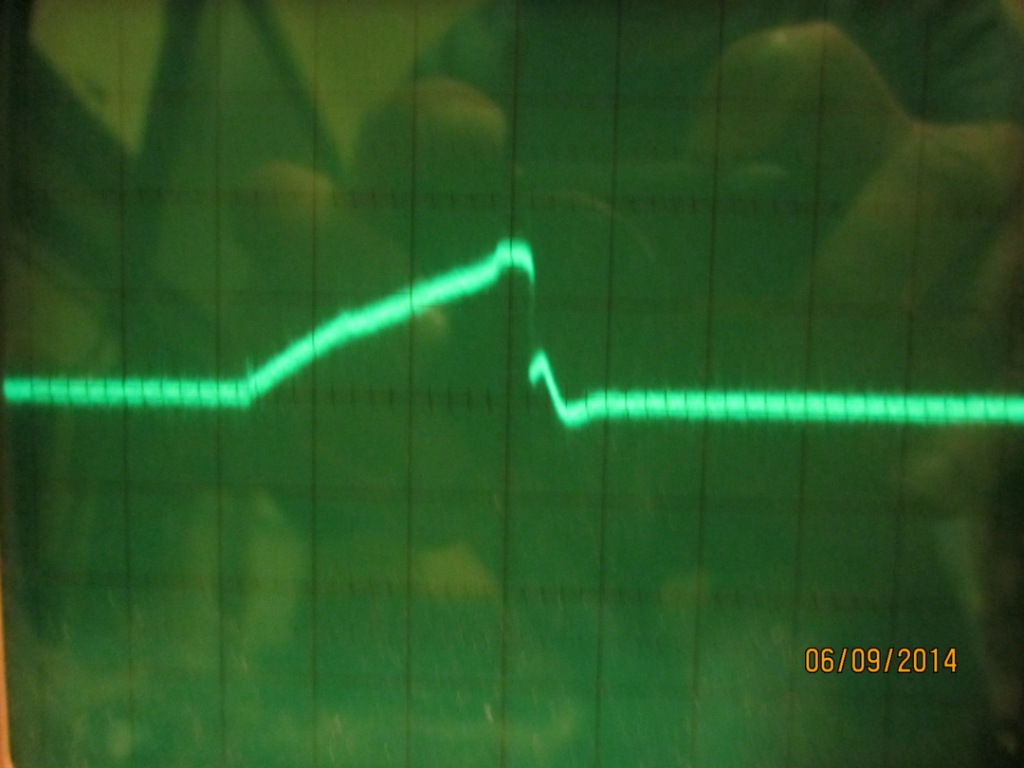

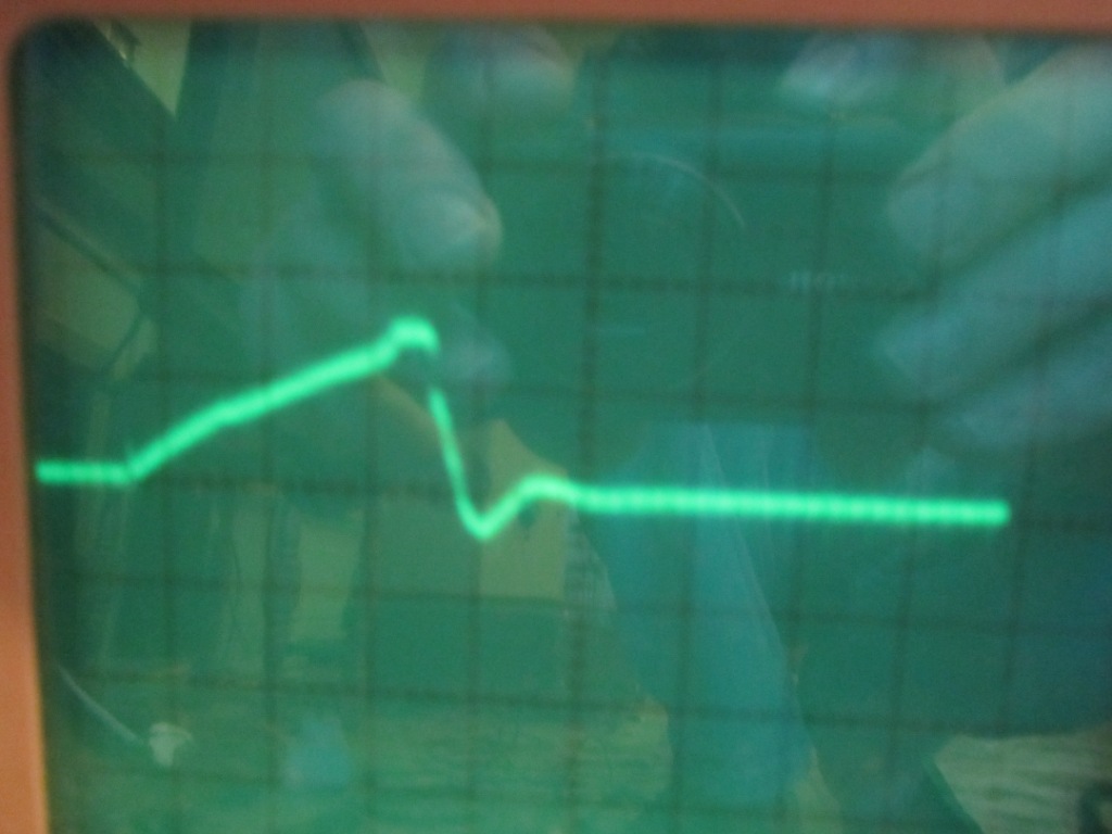

I soldered a 20k trimmer across the 10k, set initially to full value. The damping was inferior at 6k6. Went I went lower, oscillation became more and more extended. I then removed the 10k, and tried again. 10k does seem about as good as it gets. Going higher just introduces another peak, just before the overshoot. 15k was about the best compromise between keeping both peaks small. Attached are in order, left to right, of increasing R- 6k6, 10k, 15k, 20k
The supply was under it normal load, supplying 420 V @ 110 mA. I'm surprised that rectifier only seems to be conducting for 2 x 3mS per s! I thought choke input supplies conduct for a much longer part of the cycle, or am, as I suspect, missing something? 🙂

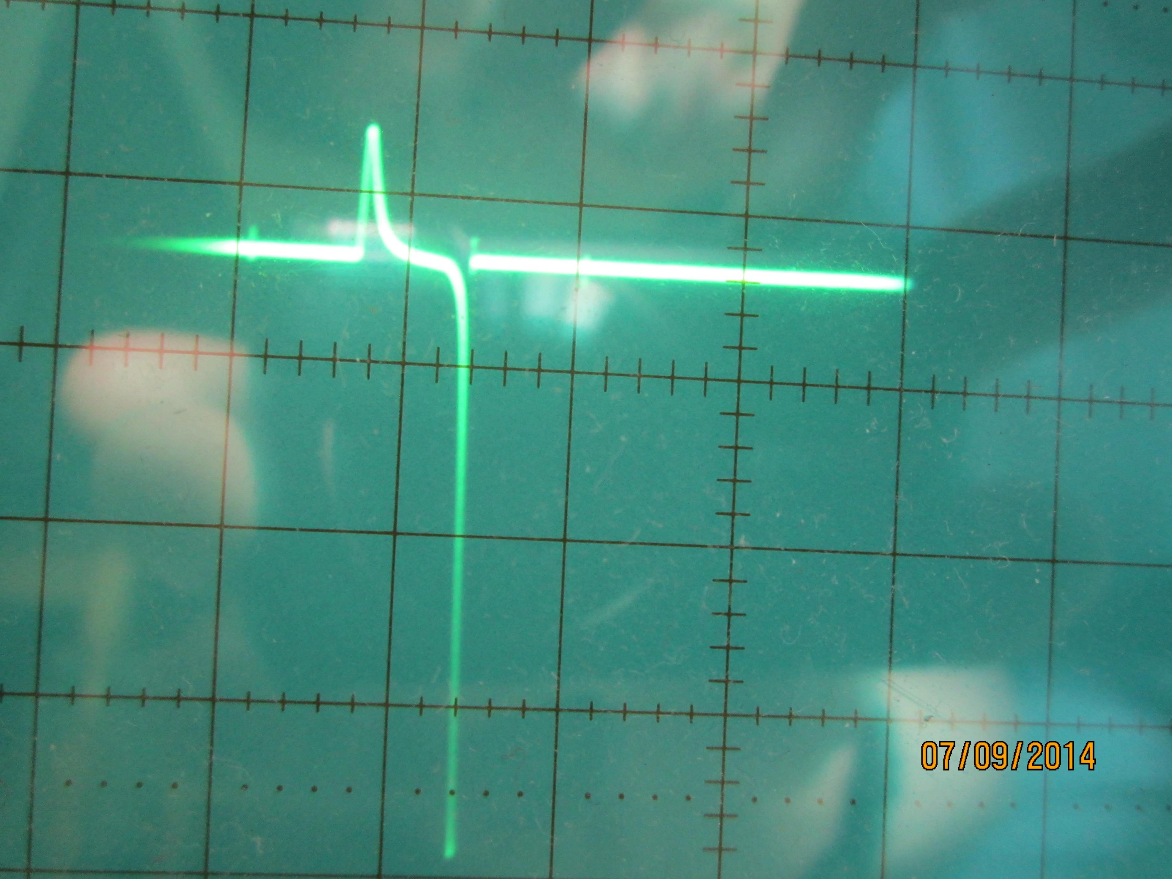

Hi
for comparison- and to see how good was the damping- I scoped one of the 10-0-10V phases feeding the 2 x 1N5822 rectifiers in my 300B filament supply. There's a 100n + 47R snubber on each phase.
Paul

Time to optimise!
I'd prefer to use a transformer core, rather than a suppression ferrite, though - you may miss some HF nasties.
As for the choke-input filter, the conduction-angle depends on the L-value, the dc current, and the parasitic resistances. PSUD2 experimentation will show what to do, if longer conduction angles are desired.
