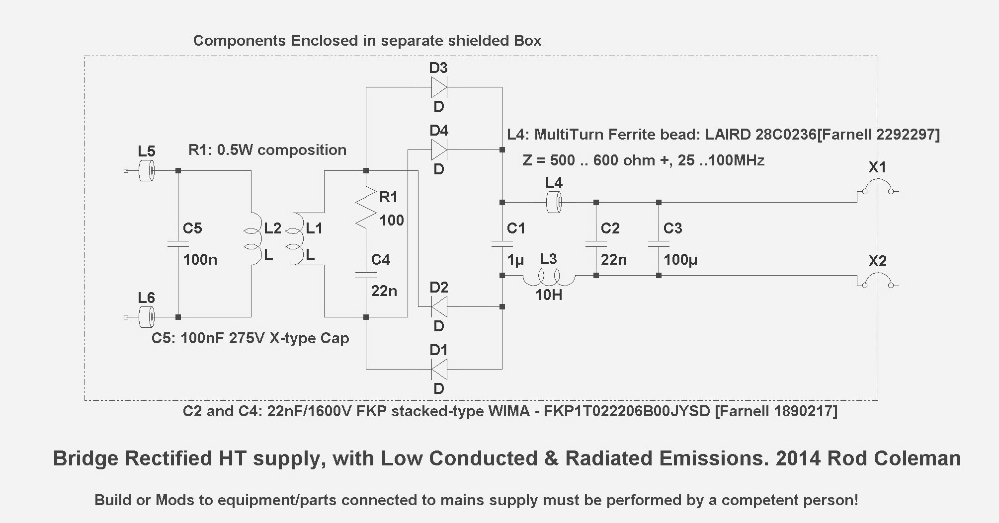

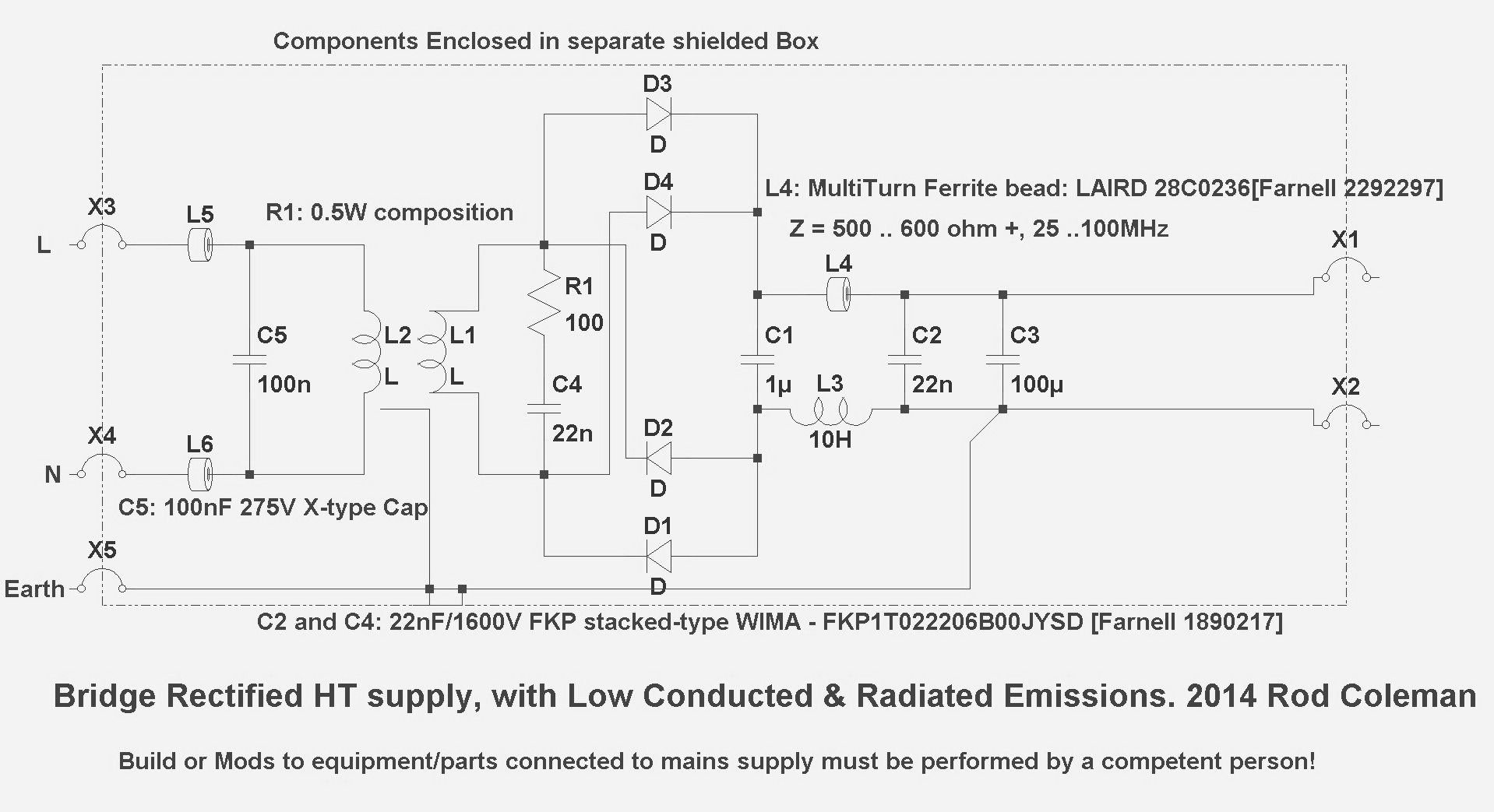

O, perhaps I better add a drawing:

Hi Andrew,
L3 is the high-value choke that allows current to be drawn from the supply almost continuously (high conduction-angle filter). Otherwise known as choke-input filter.
The chokes must have sufficient energy storage:
1/2 L I^2
to maintain the near-continuous current, so L must be higher for low load currents.
In HT supplies, specially rated "choke-input" chokes are desirable, as they have extra insulation to prevent problems from the high end-to-end voltage:
Like these :
CHOKE INPUT FILTER CHOKES
1/2 L I^2
Like these :
C1 is not large enough to hold the output voltage at a continuous level. Instead, it is dimensioned to slightly reduce the voltage swing across the choke, and at the same time, suppress (HF) noise coming in from the rectifiers.
Stacked construction in this part is also desirable, for low parasitic inductance.
Wima MKP4 will suffice:
MKP4O141007E00KSSD - WIMA - CAP, FILM, PP, 1UF, 1KV, RAD | Farnell UK
neither does it achieve that in an rCLR, nor in an rCRC.C1 is not large enough to hold the output voltage at a continuous level.
The first smoothing cap stores some charge.
The transformer sees a capacitor input filter.
It does not see a "pure" choke input filter.
It seems to me that making the cap deliberately smaller just reduces the stored charge.
In an rCRC and in an rCLC one often sees the first cap smaller than the second cap.
No one then draws the conclusion that the first cap does not exist.
In this case the ratio is extreme 1:100
So what I am asking is:
what effect does the first cap have on the way the choke operates?
Or what does L3 do in the presence of C1?
