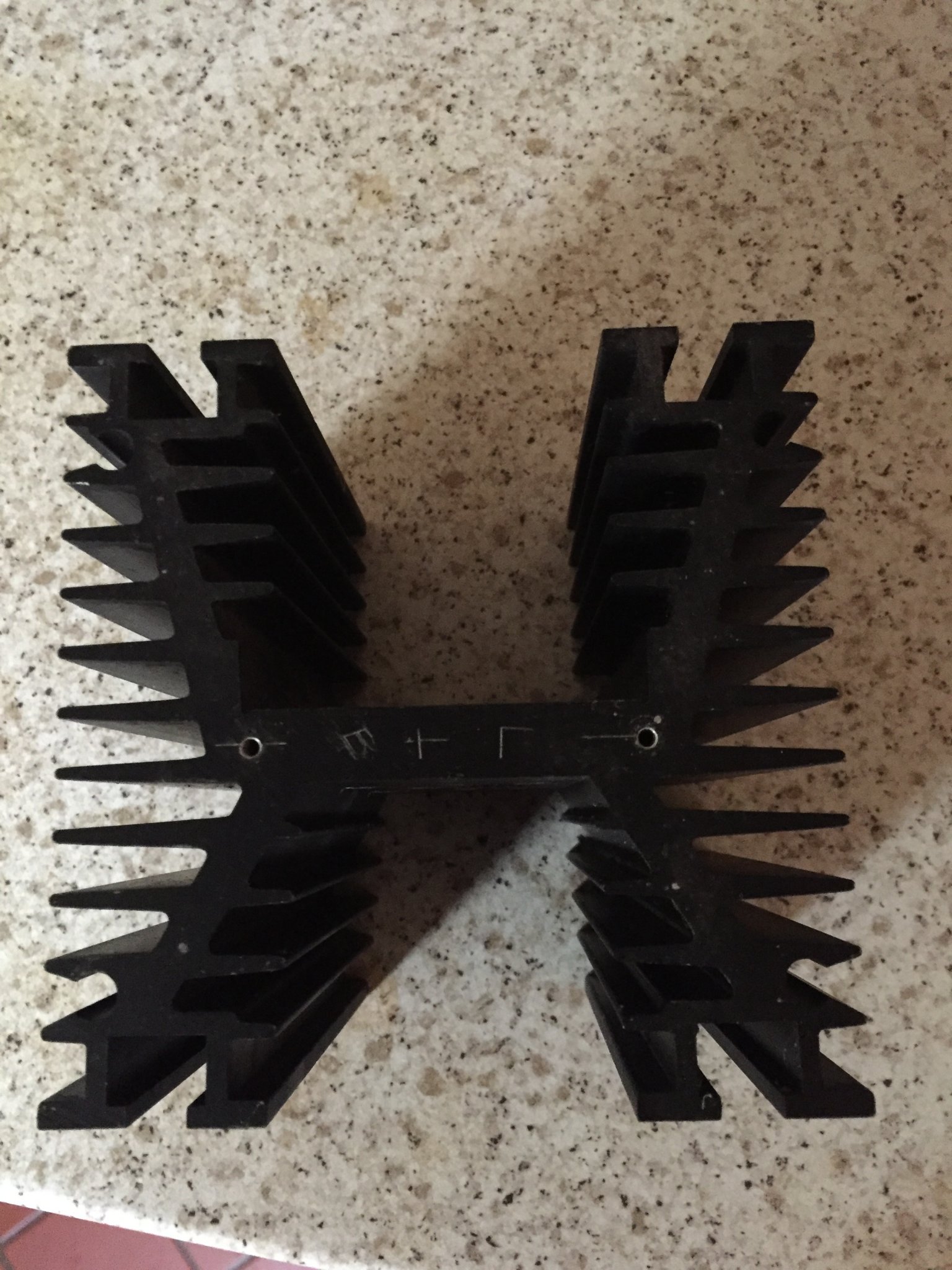

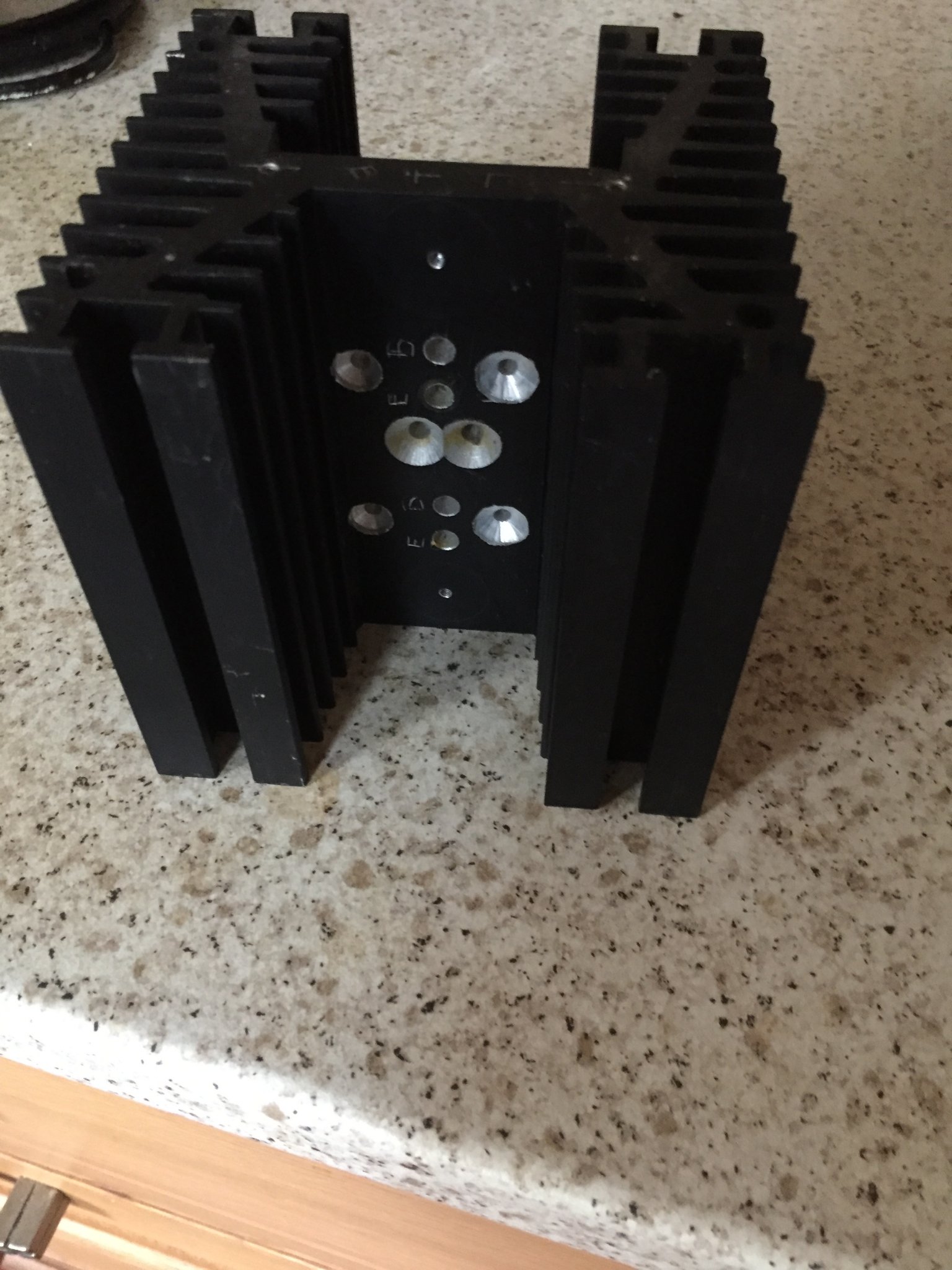

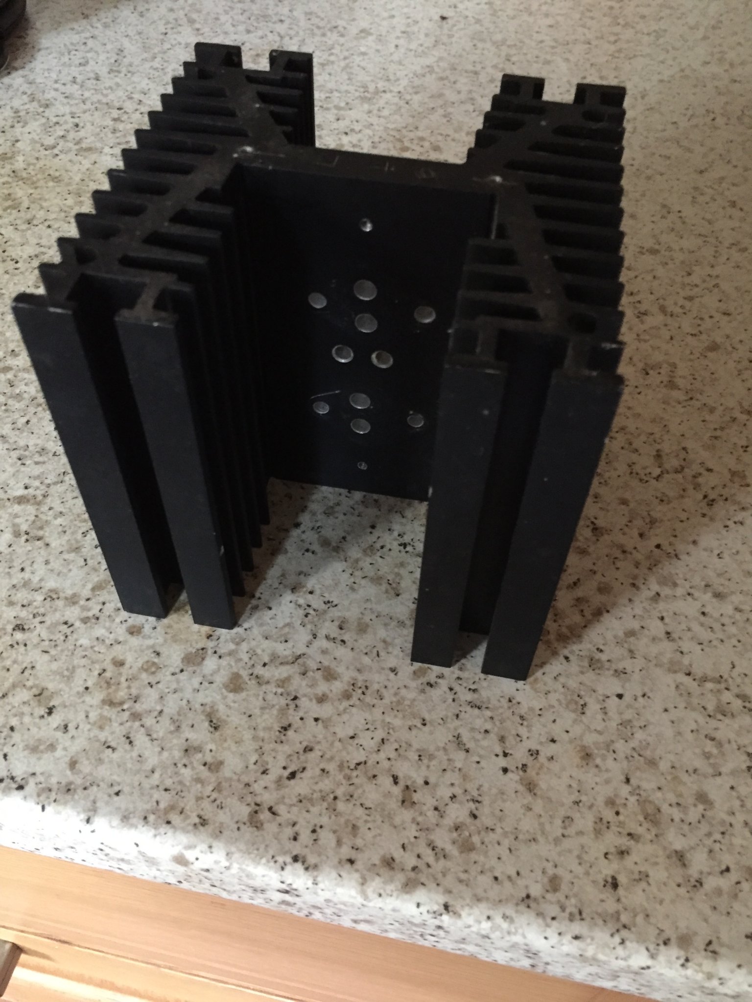

I have two pairs of 802 and 4502 output transistors which you are welcome to.
Rereading the thread I realise that we talked back in 2018 and I never did get back to you regarding things for which I apologise.
There are 12 heatsinks gathering dust in a shed measuring 120x120x115 long if of any use to you. no idea on price though.
