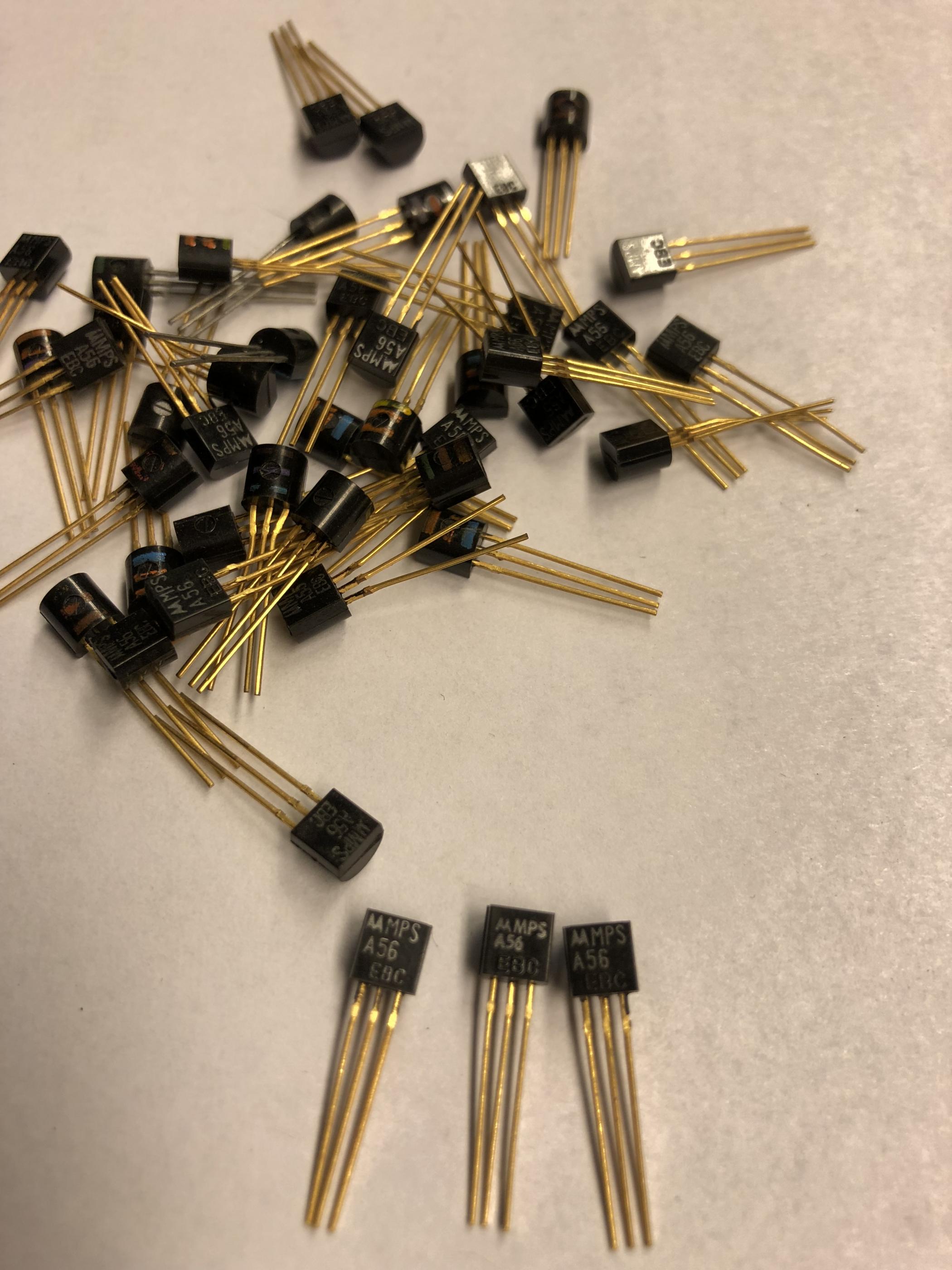

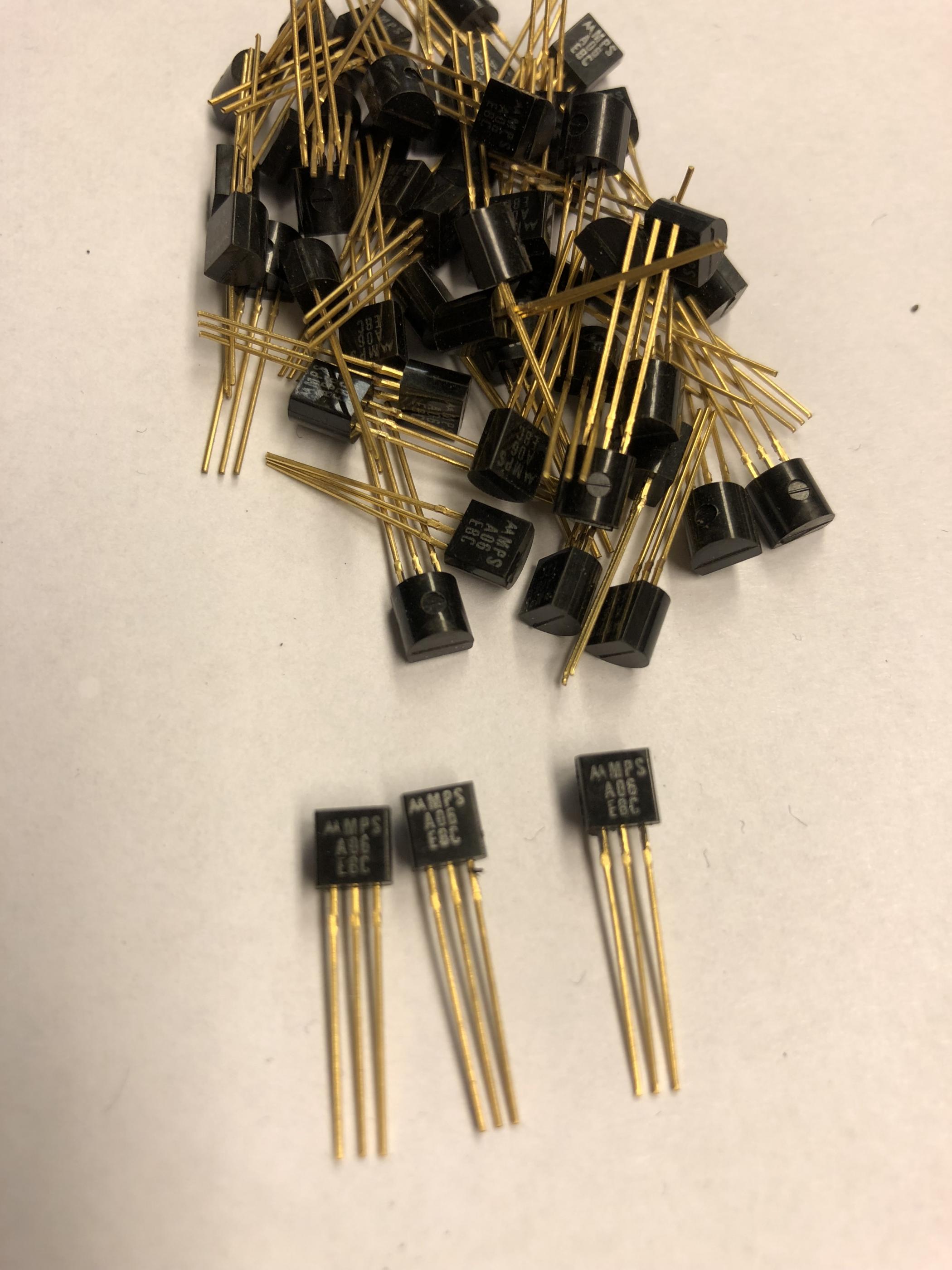

For those aficionados who just need to have the originals.
I bought these a couple of months after the article came out. I think it must have been -86. Never got around to build one myself. As can be seen they are the "good" ones with golden feet.
If there are any interest I could make up a package for a two amps.

Do you still have the transistors for sale ?.
