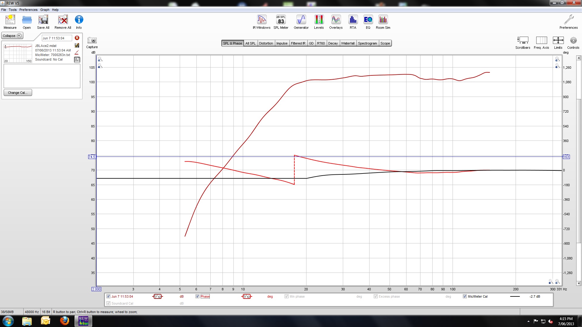

JBL K140 response in REW
Did a recap today of my subwoofer amp of post 38 , PSU caps were 30 years old and had some hum and was not so happy with the bass performance anymore .
Caps were only 20% of new value around 2000uF. Repaced them by 20.000uF per side . After replacing the caps hum was gone and as I had it in my workshop I did a nearfield measurement with REW and my modded Umik-1 and a Behringer UCA 202 .
I'm Very happy with the result !!

Rew curve
Can't understand the no replys on this perfect flat response from about 17 Hz to 150 Hz with this simple K140 driver and a couple of op Amps .

High pass is missing
I read the links , Thanks ! very interesting . Good way to recover from Queens Birthday 🙂 The Stahl design is based on a 6th order BR box and a 6th order design needs a high pass filter with fc = fbox ( and f-3dB in this design) with a Q of 2 . I made the calculations based on a 20 Hz tuning , I measured the filters and there on the spot , so I'm a little surprised that my Rew measurements are down to 17 Hz . ( But who cares and the UMIK-1 has no calibration below 20 Hz ) Baldin's design does not include the highpass filter and it should ! My schematic in post 37 has the filter included, it's the first opamp . I also added a phase inverter with a 2X gain , the last opamp , because my power amp was not inverting as needed in the design . You can select either inverting or non inverting power amps with the jumper. I added the 2X gain for my low sensitive power amp . If the jumper is placed wrongly , YOU WILL HEAR !!!
