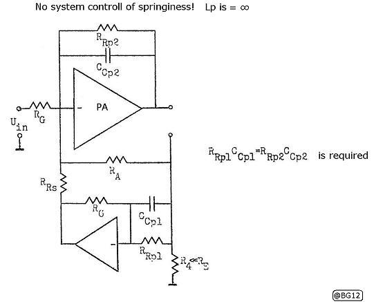

Pheonix,
Hope you enjoying reading the patent Now the patent is not about how to reduce the distortion, rather it is about how to implement a stable servo system. Someone with good engineering background can see what else can be achieved with such arrangement. For a long time, I haven't shared with anyone on how to explain the distortion reduction in such scheme. I do think it is time now as I am working on a servo midrange system and the initial result is quite good. The advantage of servo is not just on subwoofer. However, we do seem to have different of thoughts in terms of what can be qualified as "servo". Some even say a servo for vented box is not servo. I hope through the following explanation, we can find a better common ground in that regard.
If we look at the equivalent circuit of a woofer, the voltage drop across it is the sum of IR drop across voice coil resistance and the back EMF which is B*L*v and v is the velocity of the voice coil. This B*L is also called BL profile of the motor. In other words Vsp = I*Rdc + B*L*v, where Vsp is the voltage cross the speaker terminals and Rdc is the voice coil resistance, and I is the voice coil current. Let us ignore voice coil inductance for now.
Most people misunderstand that as long as B*L is perfectly linear, there will be no distortion. That is far from truth. This is because the IR drop component is still in the equation. While Vsp is distortion free, but unless I*Rdc is also distortion free, we cannot ensure B*L can guarantee any distortion free operation. To see how that happens, let us assume the B*L value is perfectly linear. But the spider compliance is not. There are all sorts of other source of distortions: hysteresis and nonlinearity in surround, enclosure internal reflection, ..etc. In order to maintain linear velocity, that means the speaker current cannot be disortion free in that it needs a distortion component in the current to counteract these distortion source. However, Vsp is distortion free, that means the disortion component in I*R will cause an opposite sign but equal in magnitude in B*L*v. That is where the nonlinear component slips into the system. That additional nonlinear velocity will cause a reduction of the distortion current iteratively until the iterative feedback of these components is stabilized. But the source of distortion is from I*R. A smaller I*R is good. In addition Rdc is not a constant value, it is a resistor made of copper or aluminum with very high temperature coefficient (0.3%/C).
If you read the patent, you will realize the servo system's equivalent circuit is very similar to the above picture, except:
1) The B*L is not from driver coil, it is from sensing coil, so we can improve the linearity of sensing coil (for instance, using longer winding length, and based on that I can say all experiments based on off-the-shelf dual voice coil drivers would see very little improvement).
2) The new Rdc value is only 1/3 of normal voice coil resistance.
3) The temperature coefficient of the new Rdc is same as the current sensing resistor. That is, if we use a 50ppm/C resistor, the new Rdc would have the same temperature coefficient. That is far better than a 0.3%=3000ppm/C that regular voice coil has.
In particular, the fact of 2) is that it can reduce all sorts of distortion in the system by approximately 1/3x based on our discussion. This includes linear distortion, nonlinear distortion, static and dynamic distortion.
Now accelerometer based approach does have a very small Rdc in the servo equivalent circuit. But that actually provides very little damping to the system and the stability is very marginal. So all scheme that will remove the temperature coefficient of voice coil resistance, and give rise to a smaller Rdc is servo even though one can see the smaller the Rdc, the lower the distortion. It is a balance of how much distortion we'd like and how much stability we'd like to sacrifice. Lastly, the above analysis can apply to all frequency range. Servo should never be limited to just subwoofer.

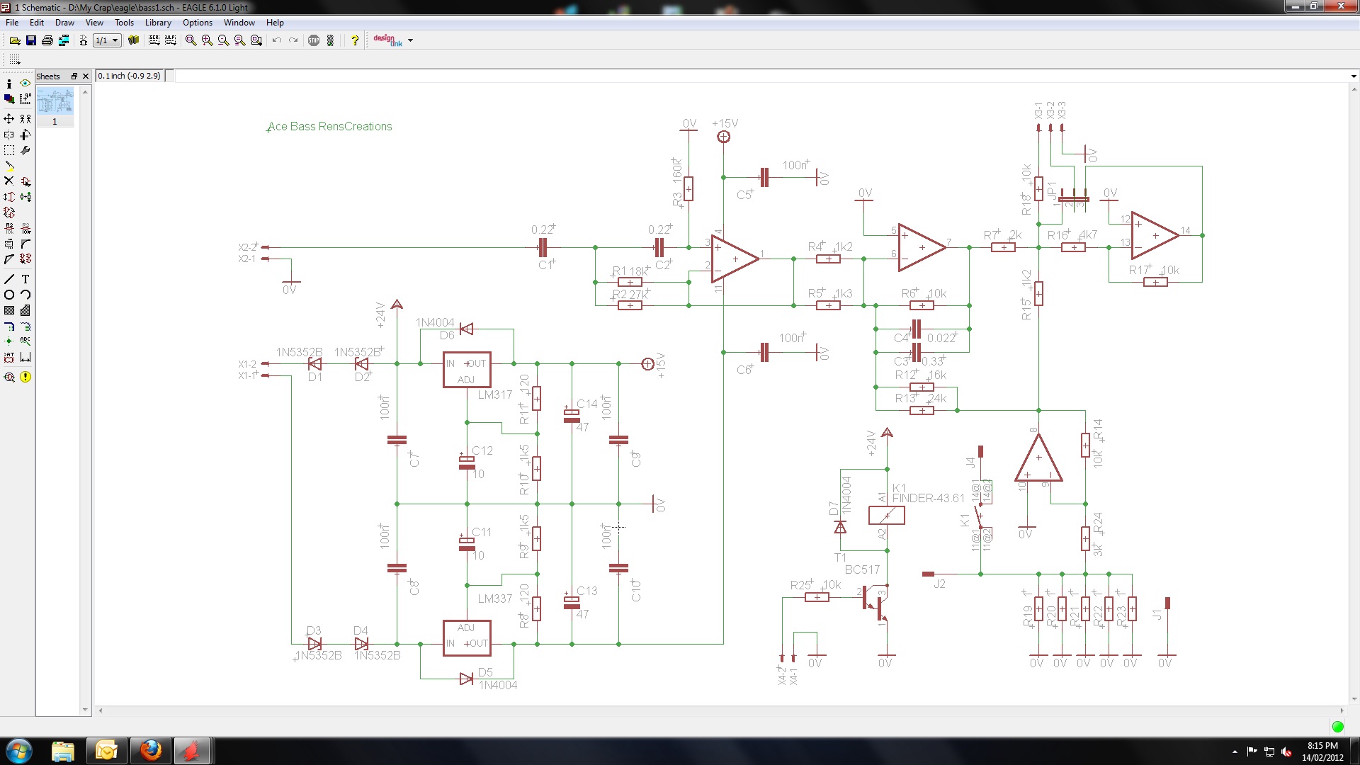

K140 Subwoofer
The schematic and board are designed in Eagle , you can download it for free at CadSoft - Home of CadSoft EAGLE PCB Design Software- Best PCB Design Software . I'll try to add some screenshots .
The Opamp used is a quad opamp OPA 4227p .I have to look in the schematics , I build it about 10 years ago or so . I changed the Amp from 150 watts to 400 watts in the recent years . The external connectors are connected to a PIC for DC protection , delayed on and quick off and infrared remote control . I look up that scematic tomorrow and take some photos . I must have some measurements files somewhere as well .

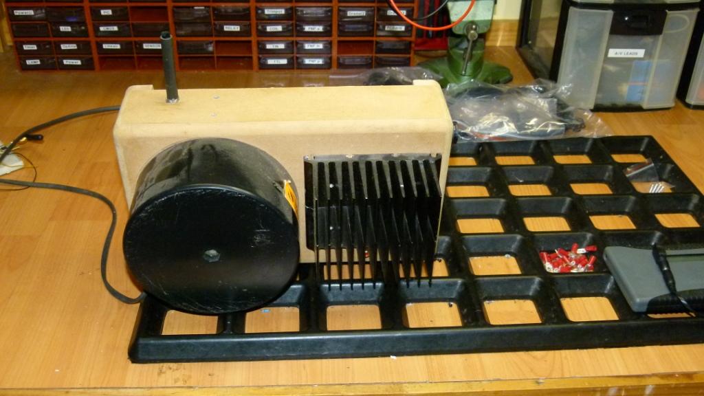

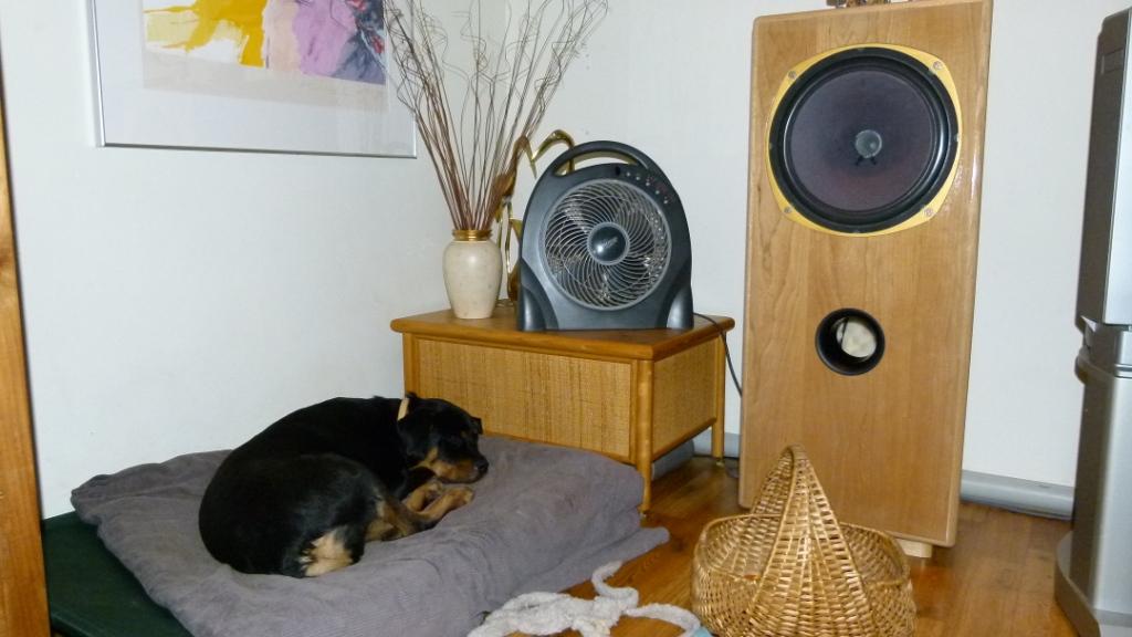

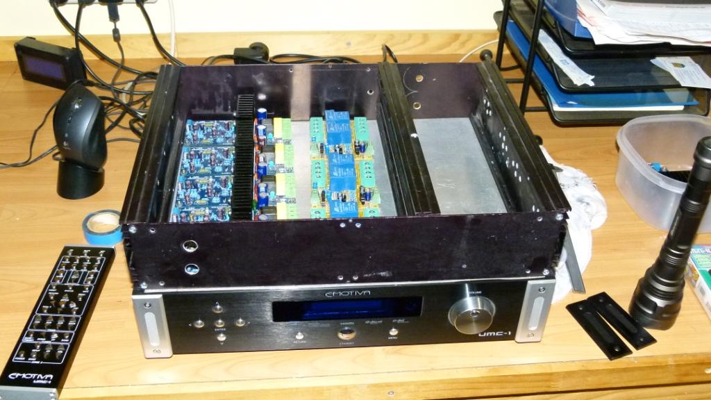

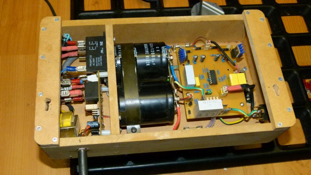

Just made some pictures of the sub and its amp .
The Rottie pup is not very happy when we play a DVD or Blueray
The reflex tube is folded externaly under the sub and made of 11 cm PVC tubing , tuned to 20Hz . The amp is mounted on the back of the sub with the IR "eye" just above the subs surface .
If I remember well , the Zeners in the schematic in the previous post are the wrong way around .
The transformer in the pics is a 500 VA 45-0-45 V AC .
Cheers ,
Rens
Ps Last Pic is my new project , 5 L15D classD , Emotiva UMC-1 and waiting for Christi's SMPS 1000
