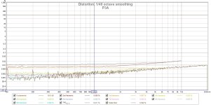

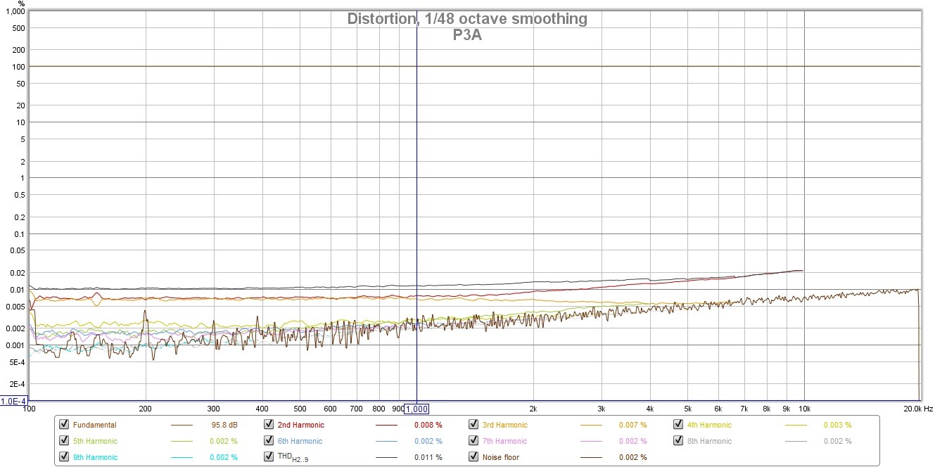

Just to throw my hat in the ring here, I have A P3A built using Rod’s boards. Like all the stuff I bought from him it worked first time and a quick listen on some old speakers sounded fine. I don’t actually have any passive speakers that are good enough to give me a real measure of how good it is.
It will however compete with TDA7293, LM3886, Doug Self compact Blameless, LM1875 and an MX50SE for a spot in my next active speaker!
My gut feeling is that the Blameless is the best of the bunch but is oddly the largest too!
I haven’t done any serious distortion measurement on any of these other than looking at the FFT on the scope at fairly high output and high frequency.
I was very hesitant about buying the P3A as I had read the Self and Cordell books both of whom were in complete agreement about the design flaws, but I read many complementary things on this forum so decided to give it a go.
Using Rod’s boards and recommended component values it worked first time and showed no sign of oscillation, even without an output inductor. My only variation in spec was that I used Toshiba output transistors as I already had them and felt that they were similar enough to the current recommended devices.
All that said, looking at the circuit does give you a strong urge to “improve” it 🙂, but it seems that might be slightly harder than it looks!
