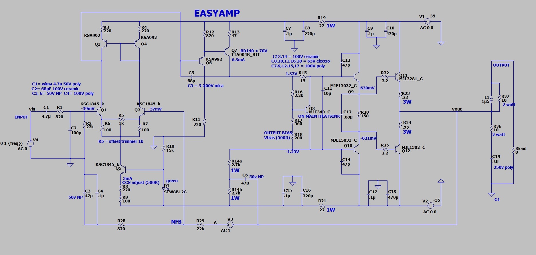

Does it matter what kind of 100nf cap?Because the Vbe is not bypassed. 100nF added and the oscillations stop. I advised this on post 5. The CFP is stable, see the step responses

Add 100nF across the C_E of Q9.

C6 is in the feedback loop of a common emitter stage Q6 and the level of capacitance of 100pf will be multiplied by the gain of the stage. I see no local discharge route for this as the carriers in n material are electrons and the negative supply is rich in electrons -so nothing doing there. There is an alternative route through the bootstrap circuit. connecting to the Vbe where it runs into more electrons in Q9 emitter and can cannot pass.Is this 100nF cap a better solution than the 100pF C6 in the P3a, and if so, why?
Hey presto behold the 100n bypass cap connecting to the opposite circuit half.
Without this Q6 is a laggard.
Setting the Vbe still seems to be a problem if high levels of output standing current have to be used. In an earlier post I suggested reducing R11 and R12 from 220R to 100R which has been taken up however the suggest of adding 100R resistors in the emitters of Q5 and Q6 passed without notice. I believe this would make Vbe biasing easier to set.
Another change I would try would be to replace Q4 with BF469 which is still available in Austrralian and New Zealand over the counter outlets.

Is putting the 100nF cap across q9 going to effect the current bias setting if I do this to the working channel?
Same question regarding changing r11/r12 to 100r

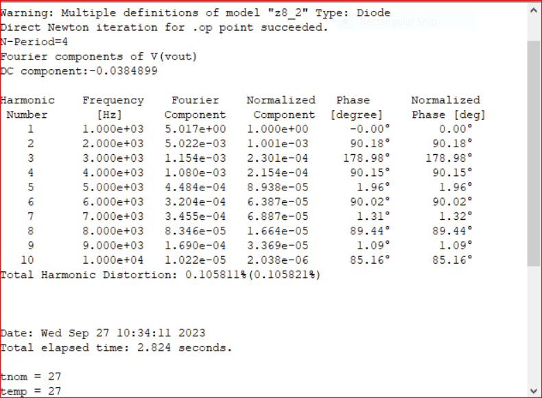

There has been some less than complementary comment from some members who prefer EF2 or EF3 output stages. In fairness to these views I have simulated an EF2 output stage for supporting evidence such as shown below.
The test results below are for 5Vrms into 10R at 1kHz with no nfb.
