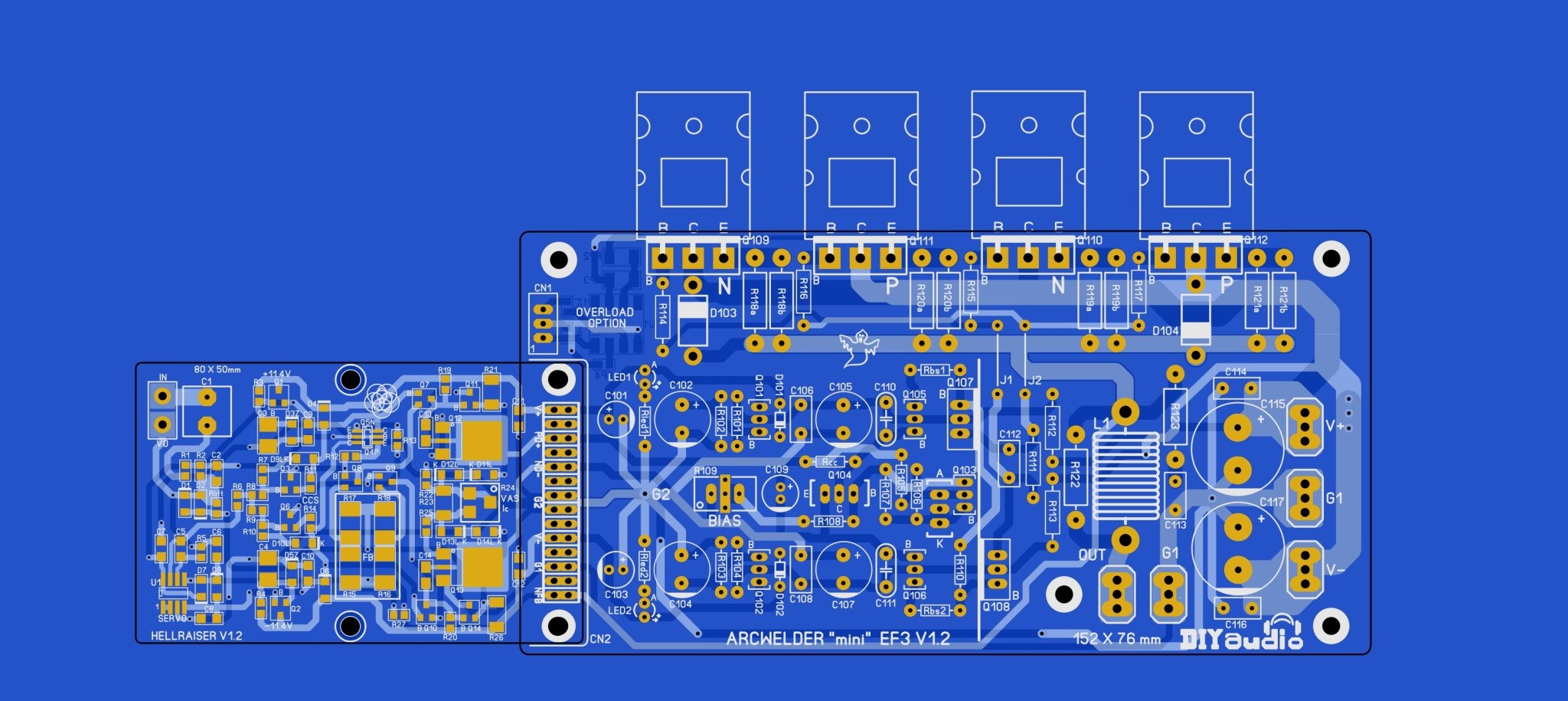

Go modular - crazy stable (EF3) output stage (below) , add any design on the forum to it.Perhaps a better approach might be to state what I wanted out of this build.

But you could win the "distortion Olympics " with it , if you wanted to.
And .... I have through-hole input stages that also plug in to it...
