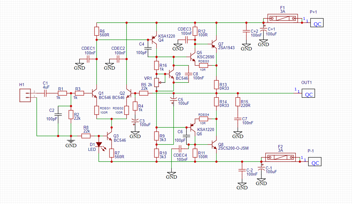

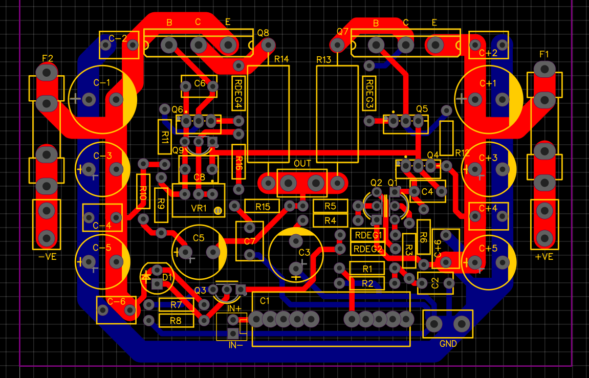

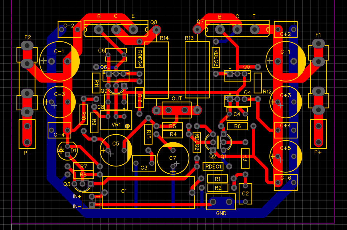

G'day Guys,
Here is my first draft of a pcb layout to accommodate the stability improvements etc.
Schematic: I'm not sure if C-5/C-6 are of much importance so I haven't yet put them in the pcb.
From what I can work out the positive rail is more important here.
This is just a first draft, things like labeling, trace width, pad sizes, extra pad options etc are not yet optimised.
At this stage I am concerned with trace routing and parts placement.
This is loosely copied from Rod's part placement for Q4-Q9, VR1 and R13/R14. The rest is just where it made sense to me to put it.

Not sure building a new PCB makes any sense. If the basic design on Rods PCB is not working.
I would not change the design till each change was verified. In the sim and a bread board.

Here is the next version.
I moved a few things around to get the feedback path as short as possible.
I squeezed a few things up to generally shorten paths and fill empty space.
I added the extra decoupling caps on the negative rail since there was plenty of space on that side of the board.

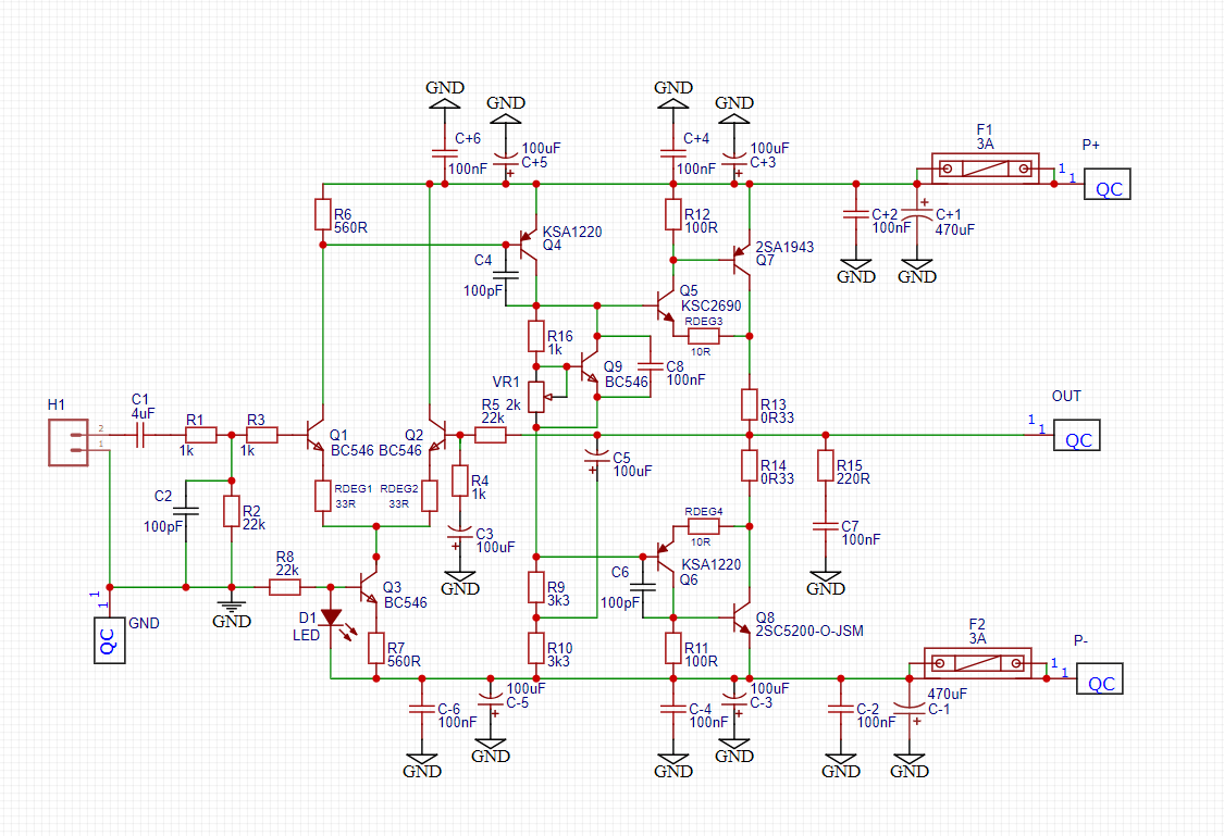

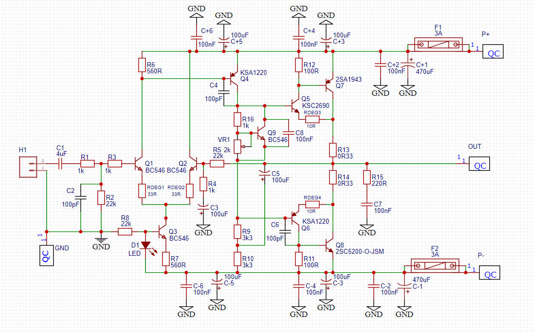

Schematic for reference:

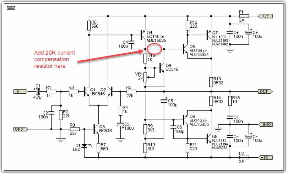

Sims also suggest that you can add a 100n cap across on the bias transistor Q9 and remove C6 (as previously discussed)
In many other threads, builders have dropped C4 from 100p to 68p with success. Simulation loop gain and square wave analysis backs this up.

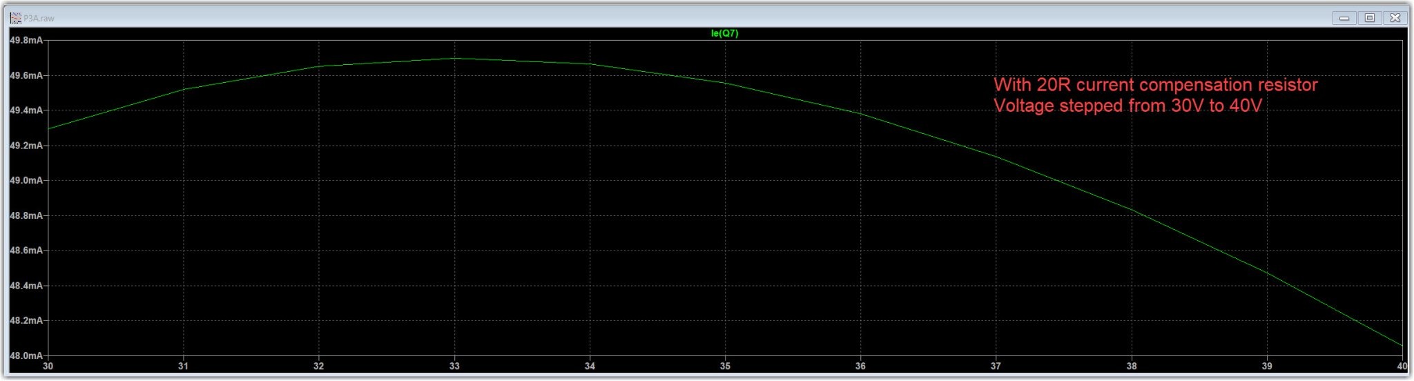

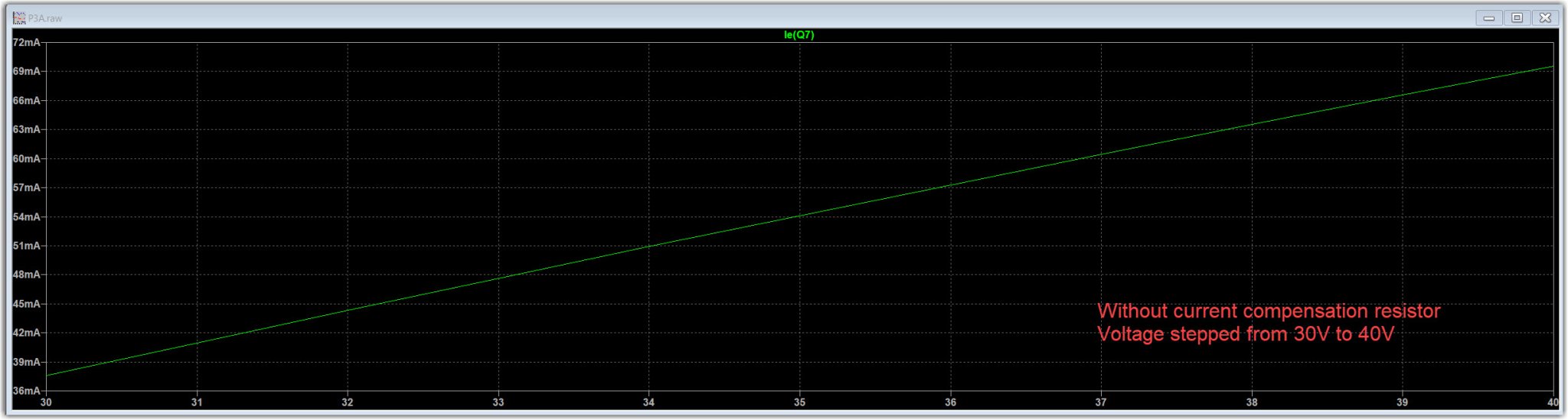

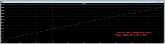

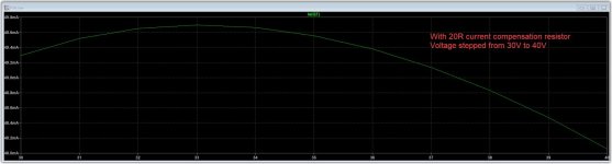

I've also previously mentioned the benefits of a current compensation resistor for the bias generator. Here are some graphs to illustrate its impact on bias stability as supply voltage changes. However, this one is tricky to implement without PCB changes.
