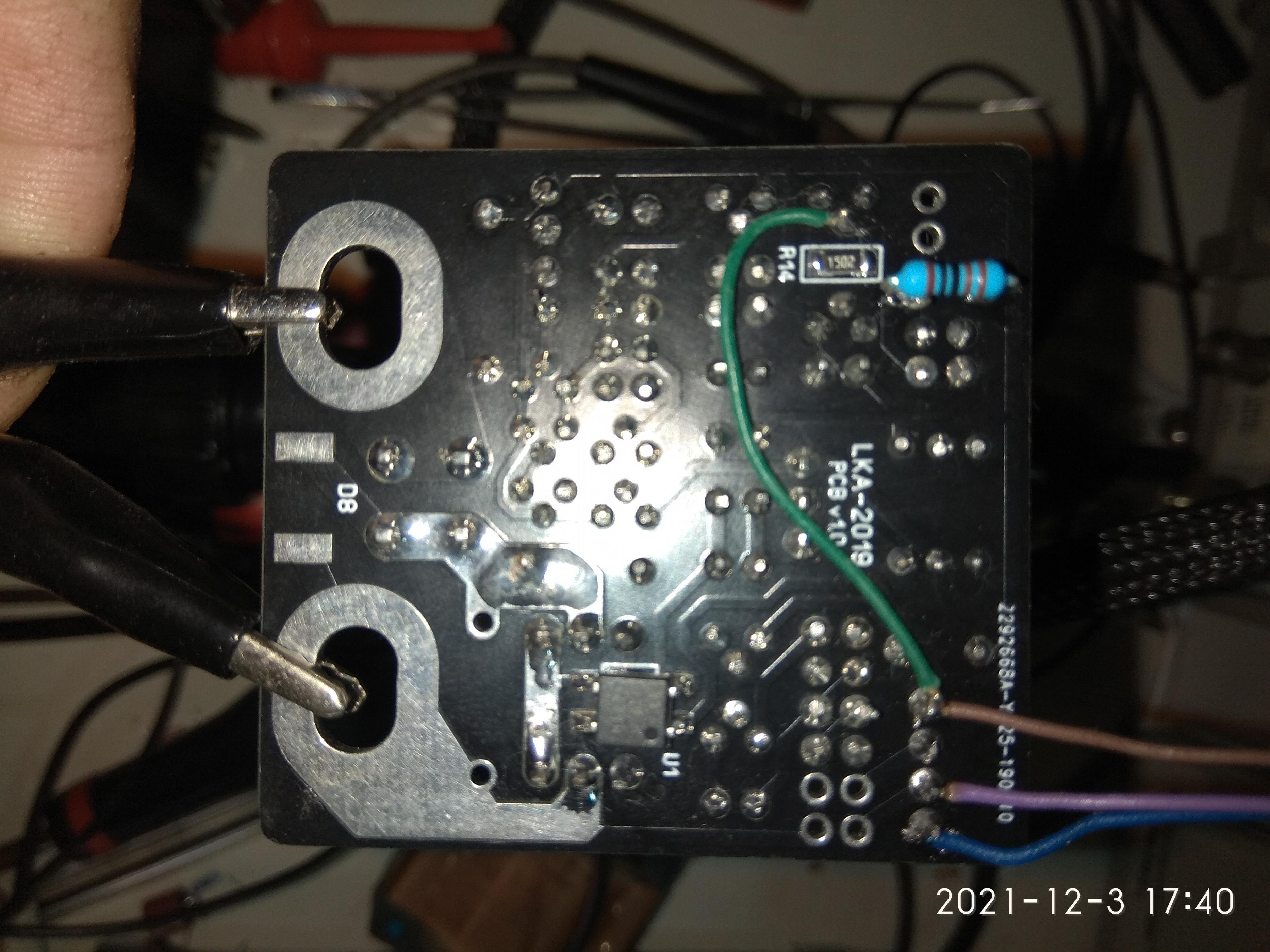

If it works, then no, but we can try to reduce some resistances. Did you use my PCB design ?
On this case no.

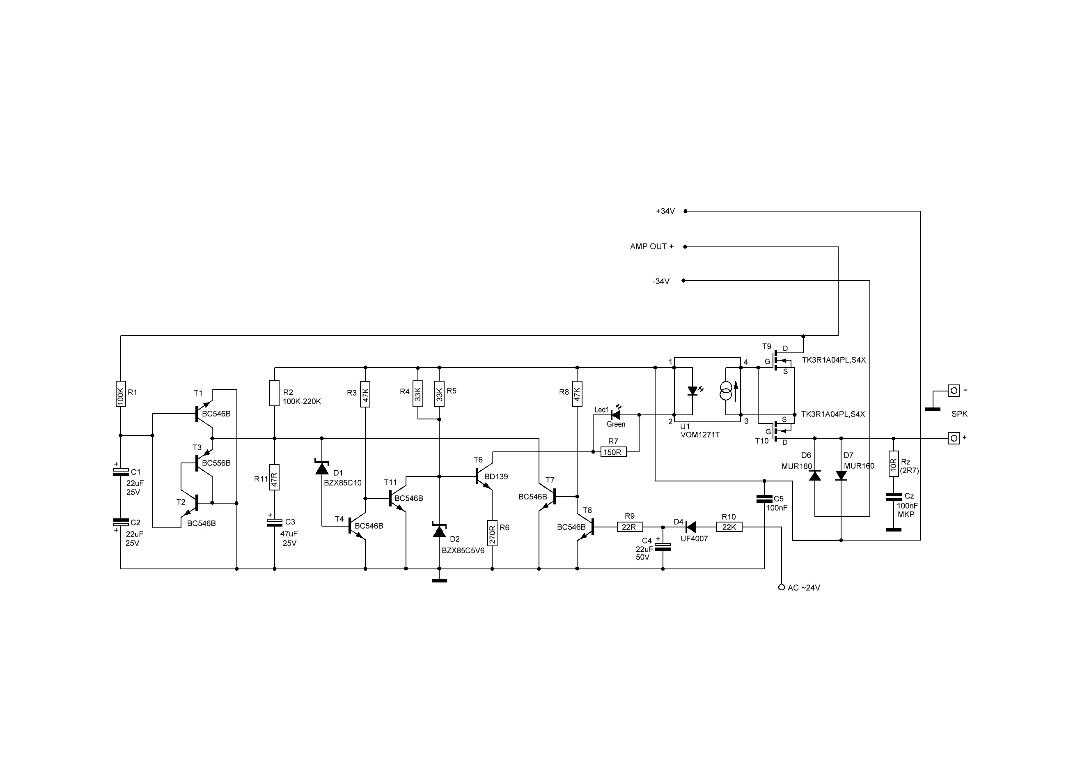

I use my own pcb according to this schematic.

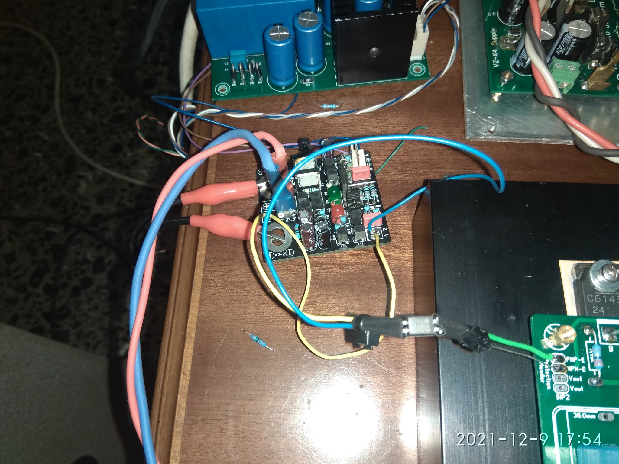

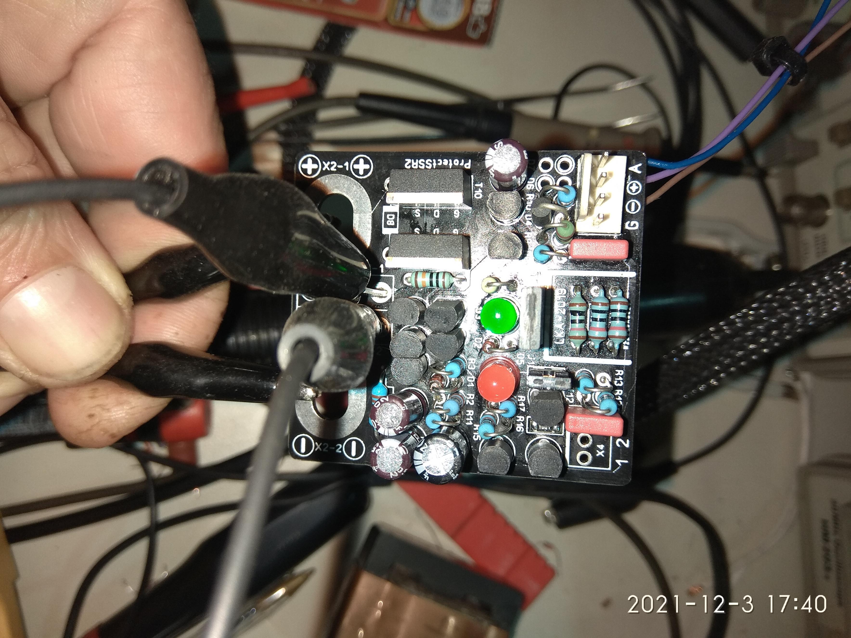

Here is the overload detection circuit connected.
Amplifier power supply is +/-50v
Power transistors are 3xA2223,3xC6145.
Emitter resistors are 0,22ohm.
What is the recommended,RS1 value?
I have choose 22ohm .
This is the value that activate the overload protection when amplifier go into hard clip for a long time.
""Choose RS1=100R (current limiter for IR led)
PC817 has forward voltage approx 1V. If RE=0.22R then Ith=1V/0.22R=4.5Ap
If you need higher current threshold, add RS2 (voltage divider).
RS2=100R Ith=9Ap, etc""
