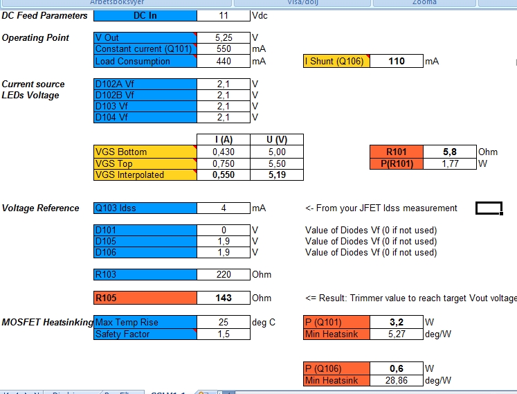

Have used to excel sheet to get component values for my two regs. One for Buffalo III (5.25V 440mA) and one for Ian's FIFO (6V 600mA). I posted screenshots from excel below. It would be great if someone could double check to see if it looks ok?
I think they are logical. But do confirm that you get 2.1V and 1.9V from your greens and reds at say 3mA so to be nearer on target. If you will join gate and source on a K117GR and take that node to (-) of a 9V battery, put a led between drain and B(+). Measure the drop across it as it lights up.
P.S. If you don't get 2.1 or 1.9 don't go looking for leds, just feed the real @ working current vf values in the calc.😉
Thanks Salas, I will do so.
