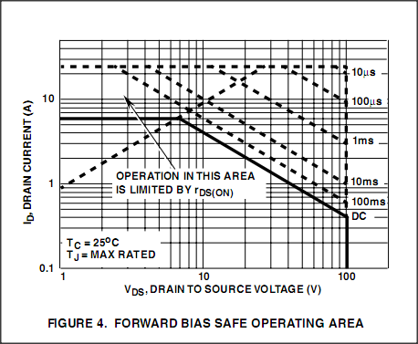

You need change the 9610 with a slower but tougher IRF9520.
How much A can give IRF9520?
3A+ at 10Vin-out CCS by its safe operating area spec. This is 30W+ and I would avoid using that 40W part like that constantly, but at 2A to 2.5A it should be living longer given the sinking is good.
