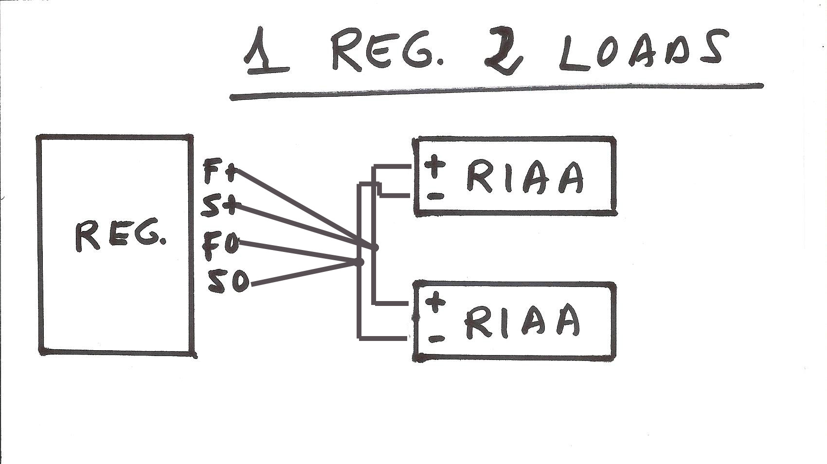

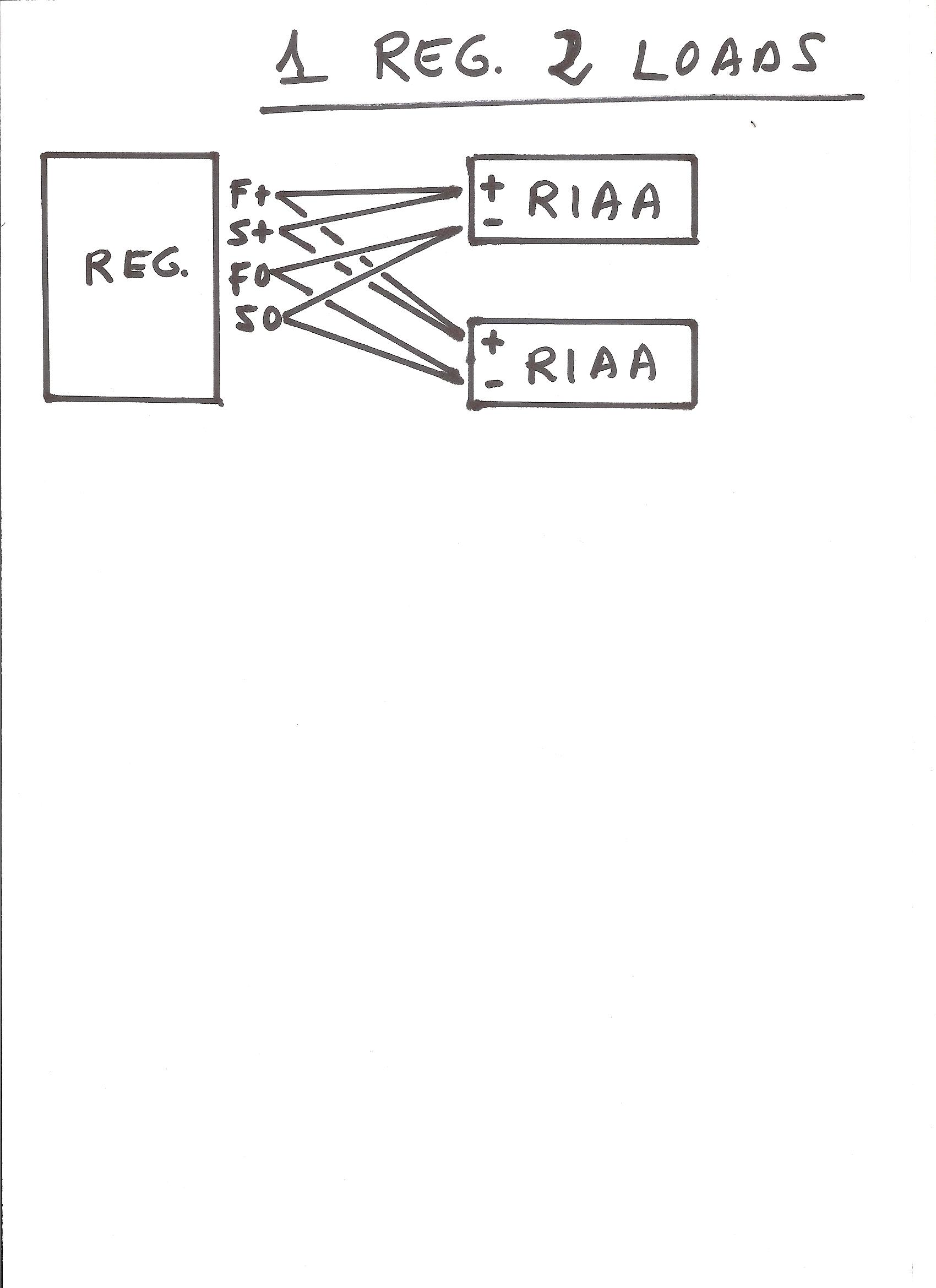

I want to connect one reg for two loads, it's correct the attached schematic?
No. Like this is better. Use short thick links between channels power receiving points.
