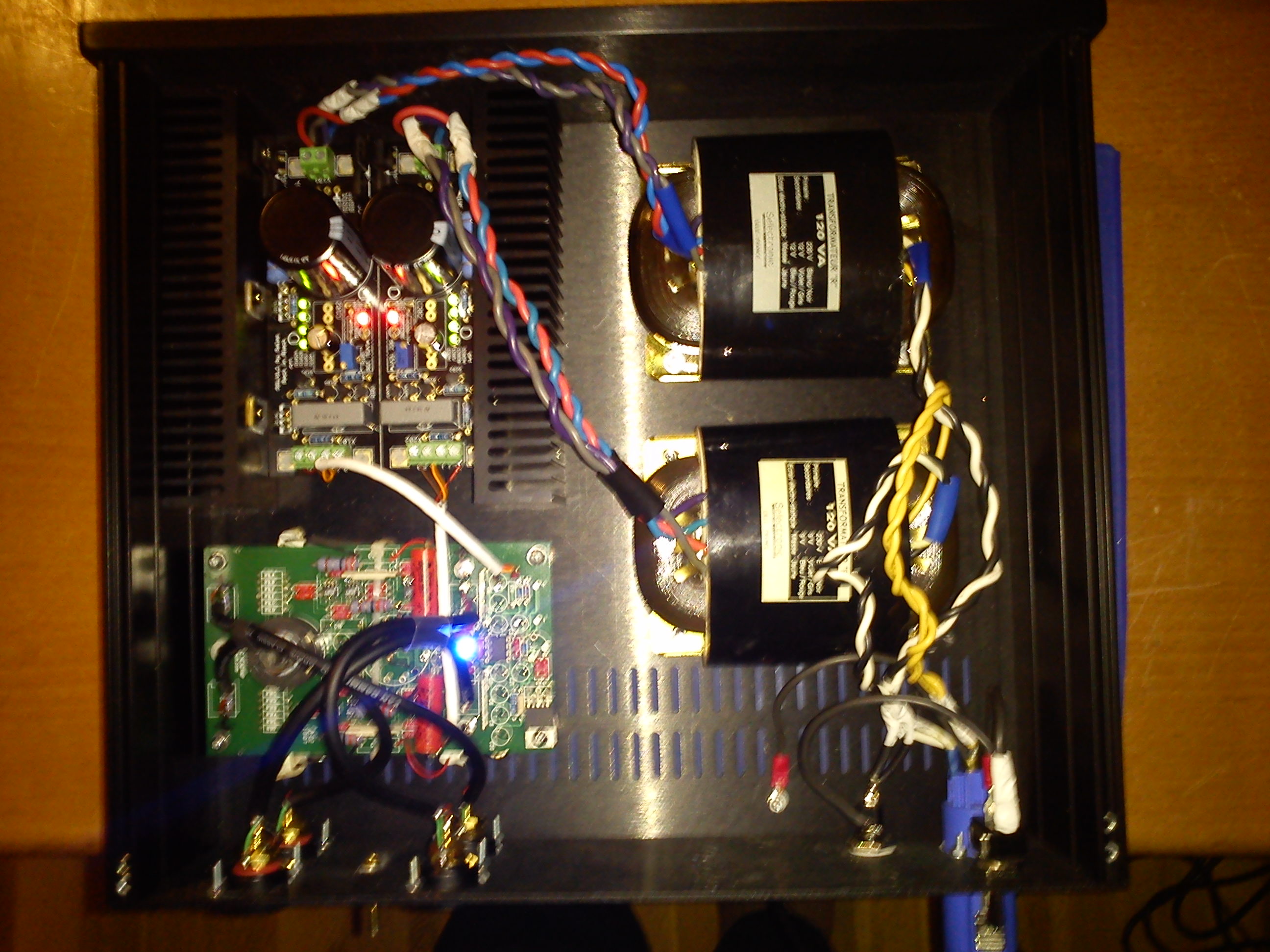

Will be good to know if george hear the same differences.
1.2R psu with Pana THA 15.000uF 63V 105ºC (two tx + two psu + two regs)
1.1 psu with Nippon Chemi-Con 10.000uF 63V 85ºC (one tx + one psu + one reg)

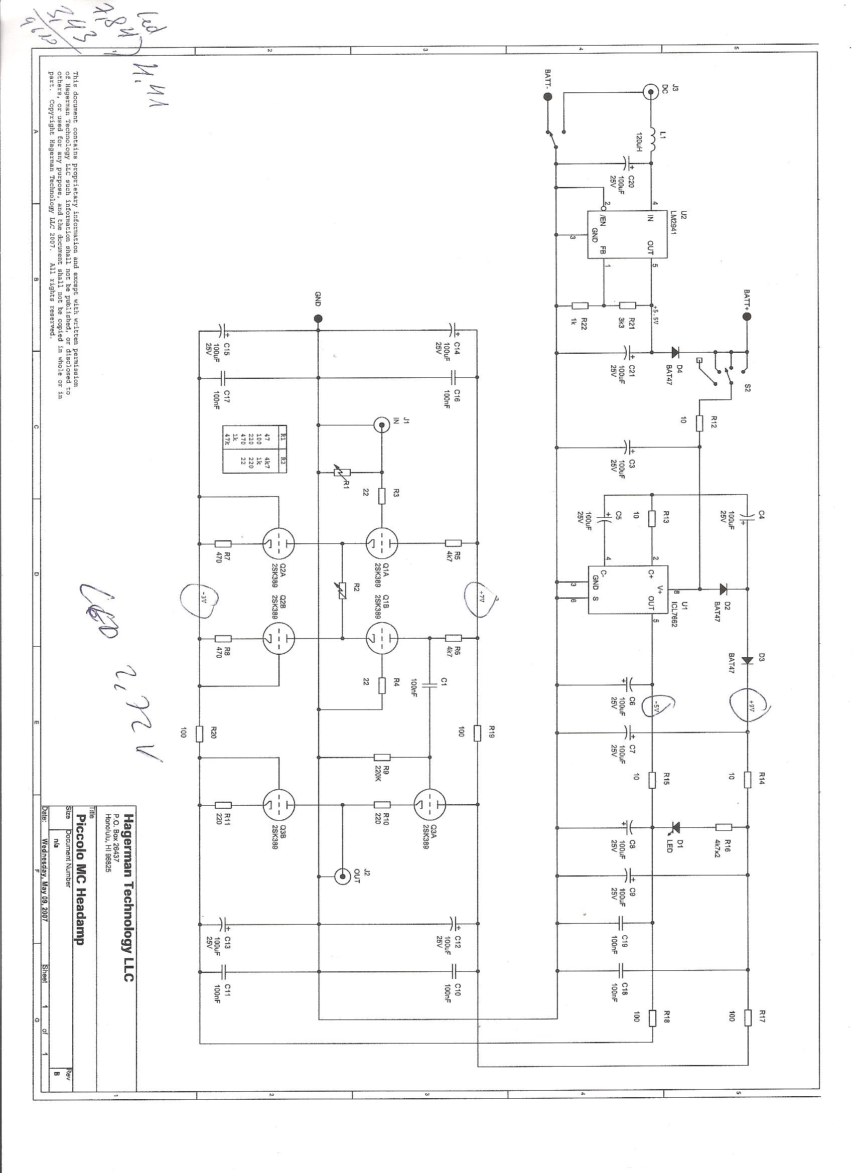

Piccolo MC pre-pre
I want to power the Piccolo MC pre-pre and I woul like to know where can connect the +- SSLV1.1 regs in the attached schematic? between D1 & R14 for +9V, between C6 & R15 for -5V? between C12 & Q3A for +7V aprox., between C13 & R11 for -3V aprox.?
I would try left to R14 and gnd OUT point. Cutting at D3. If I would get a problem like that maybe it would need defeating some connections.
If needing to replace -5V also, probably at the left of R18 cutting there too. GND OUT for S0+F0 again.
Yes it works OK as we planned for connection points.🙂 Now it's time to break-in but first impression is very good.😉
