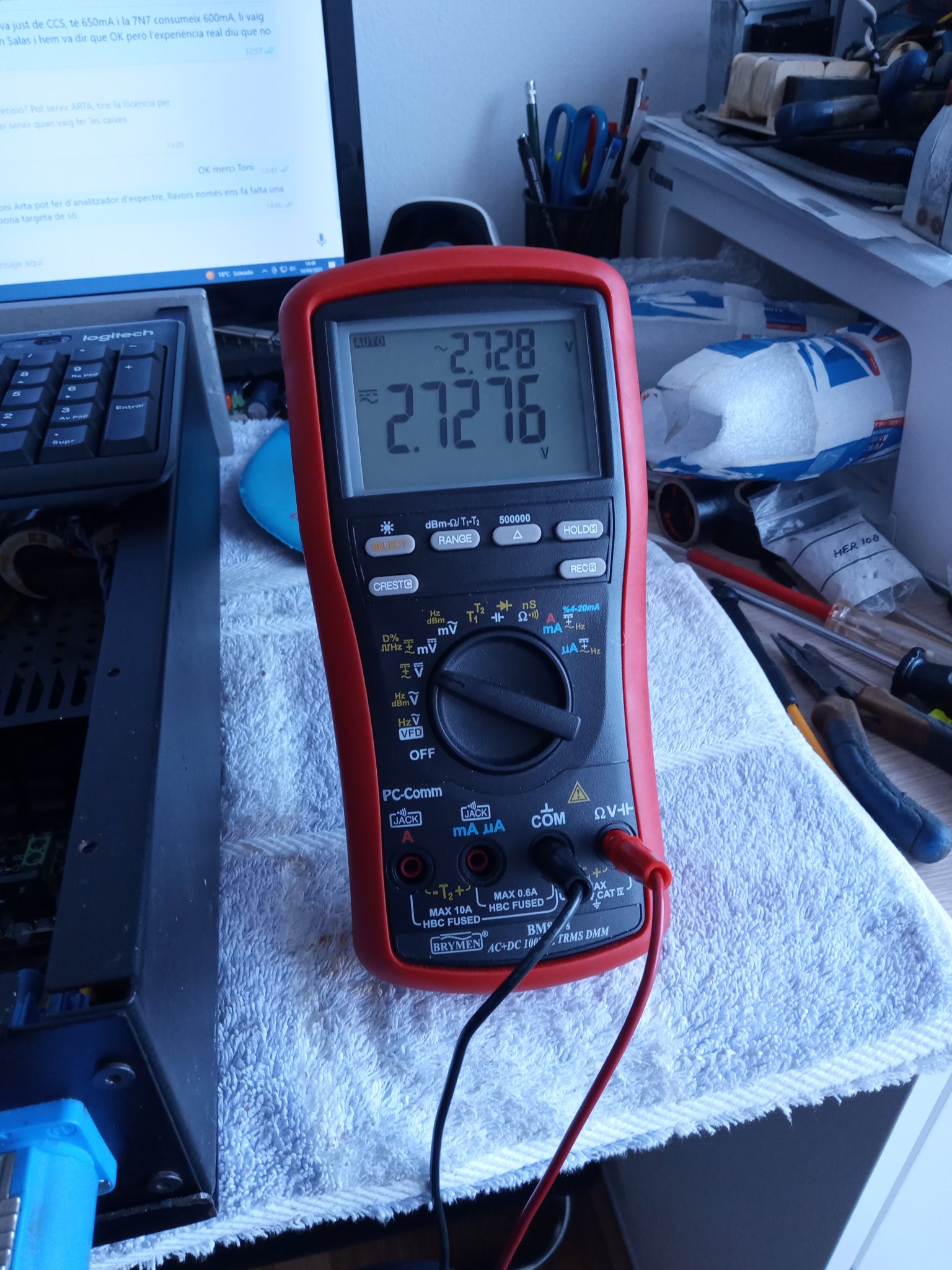

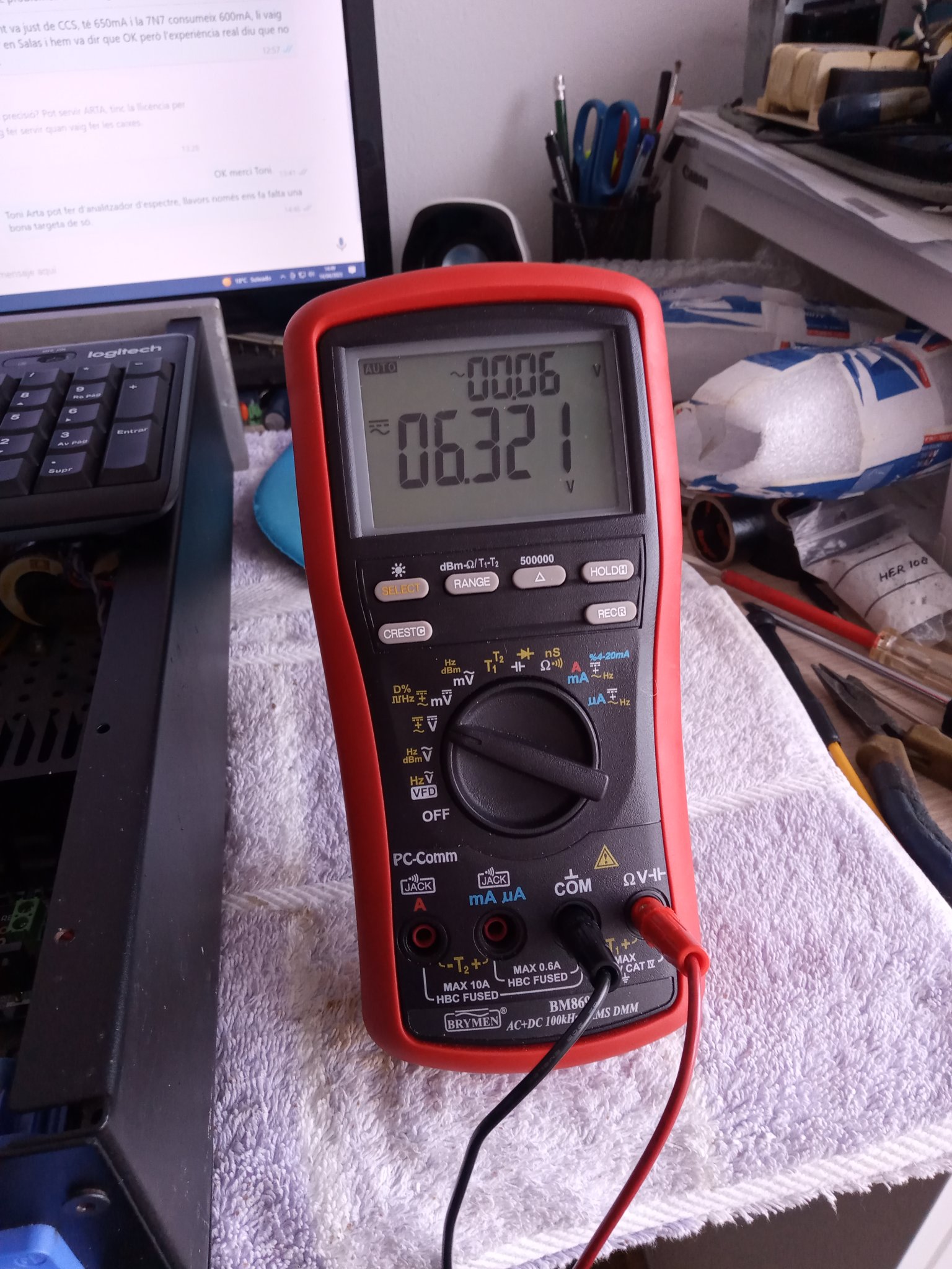

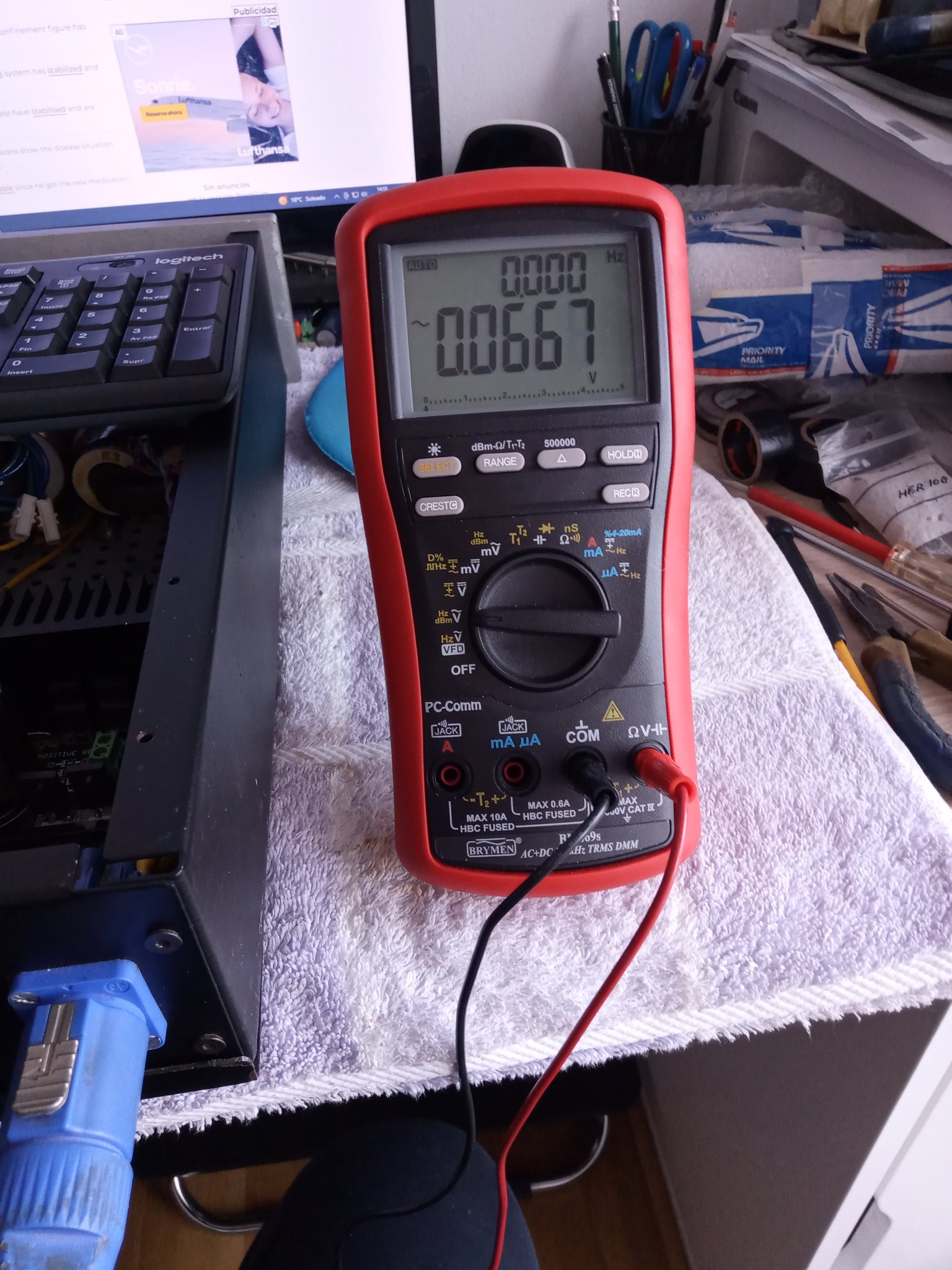

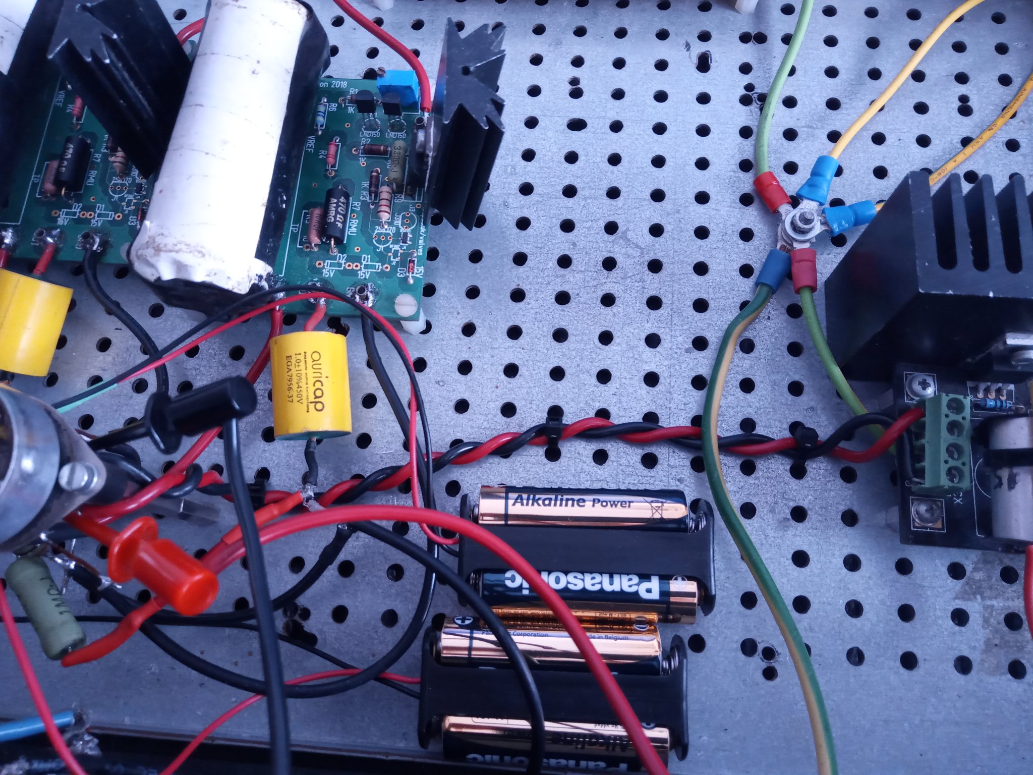

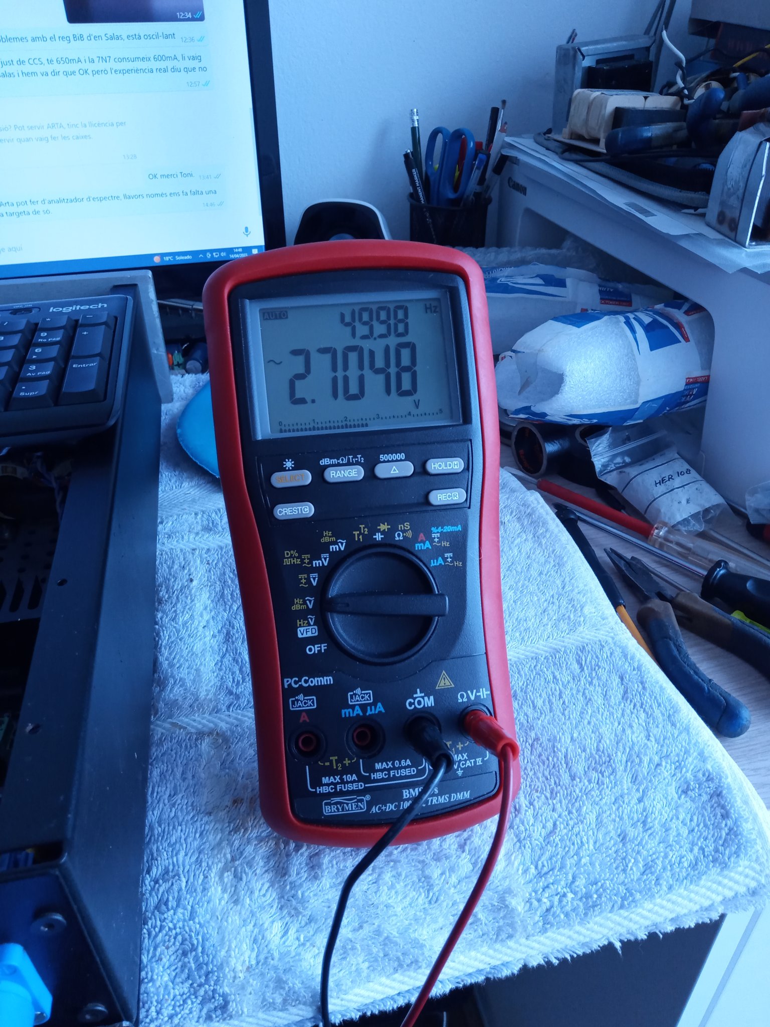

Near 800mA still oscillates, could be the issue Zobel network related, because several times the tester reads 1 or 3 volts: I said because the zobel used is 4.7uF in place of 10uF?
C305 negative capacitor is chassis grounded.Maybe the heater negative is not grounded ?
See what happens when start power 1st pic left side measuring DC, 2nd pic measuring AC: 50Hz near 3V, 3rd pic once stabilized measuring DC, 4th pic measuring AC once stabilized.
