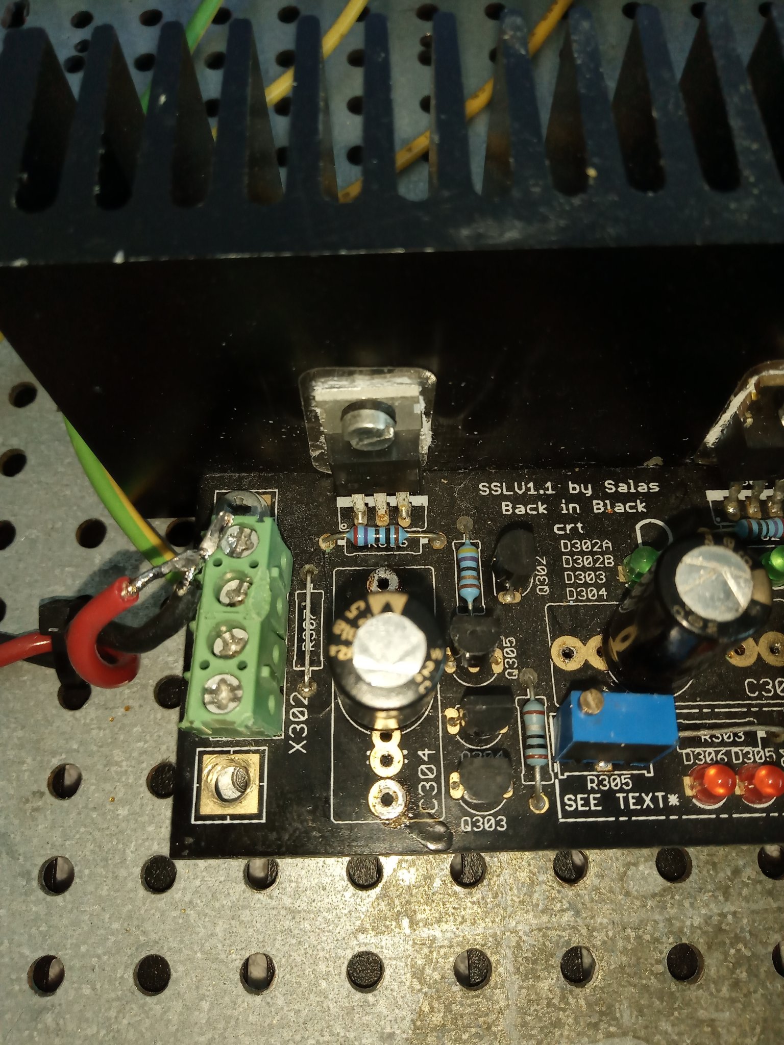

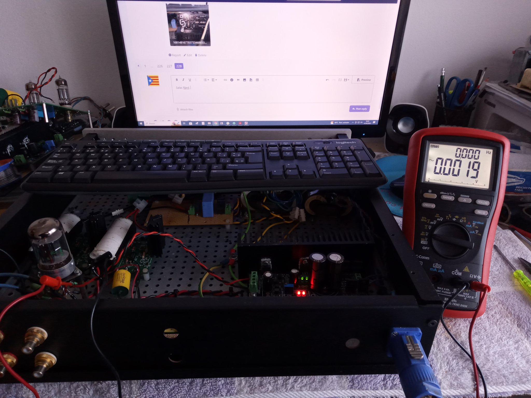

Heaters is a special case, I know L-Adapter is being used for heaters, don't know about 1.1 shunt, not usually. What I would do is skip Zobel and use 100uF output and no remote sensing for heaters. Useless in a steady load as heater. Maybe it gets noise interference when Zobel for heaters.
Looks enough for 6.3VDCout. Not plenty but just enough.Loaded 10,7VAC, it's a nominal 9VAC 30VA.
Remember there's a resistor position in the Zobel that the electrolytic termination option needs to bypass. Watch the pads configuration.I don't use remote sense, I will try to change the zobel network as suggested, thanks.

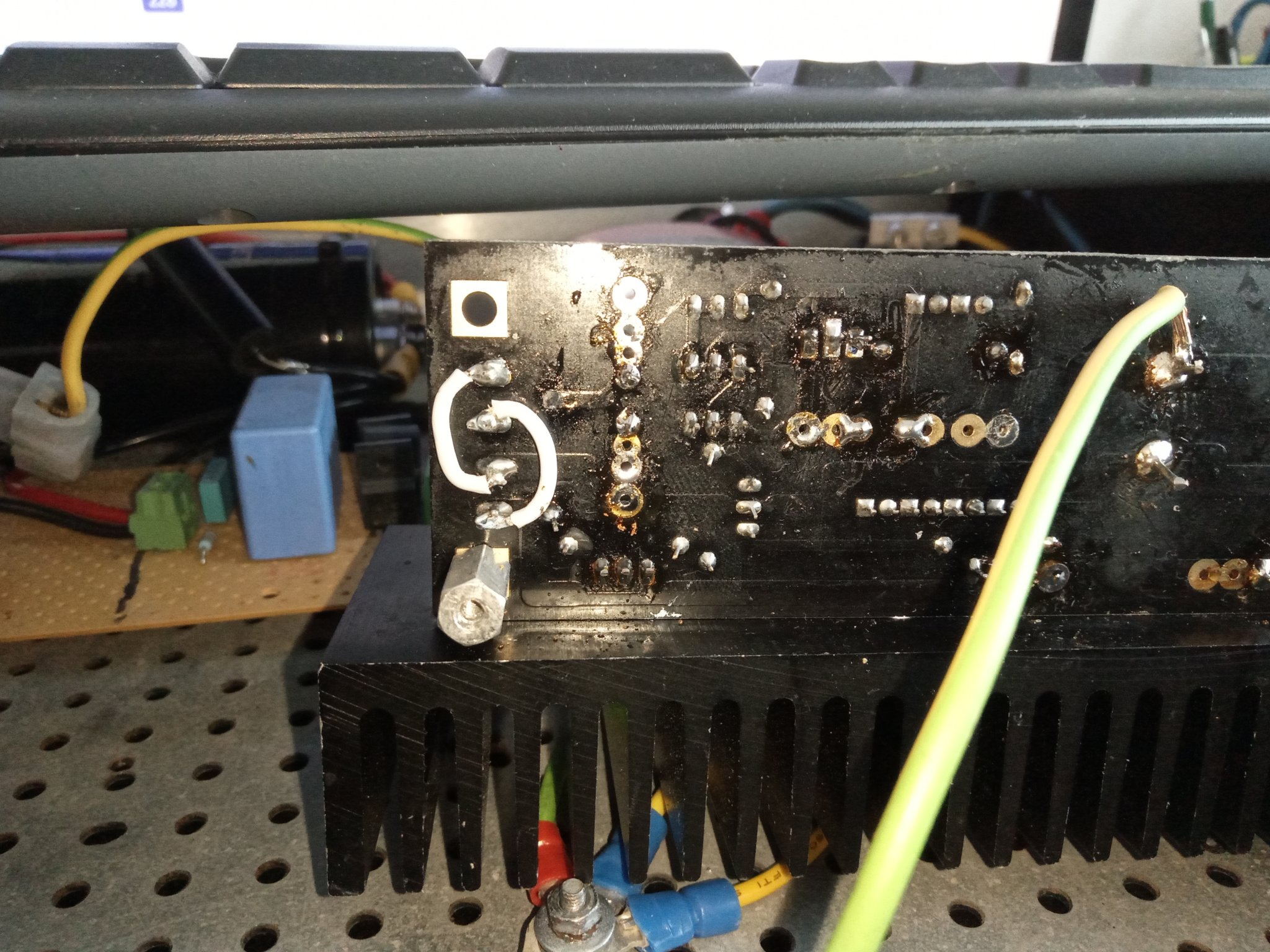

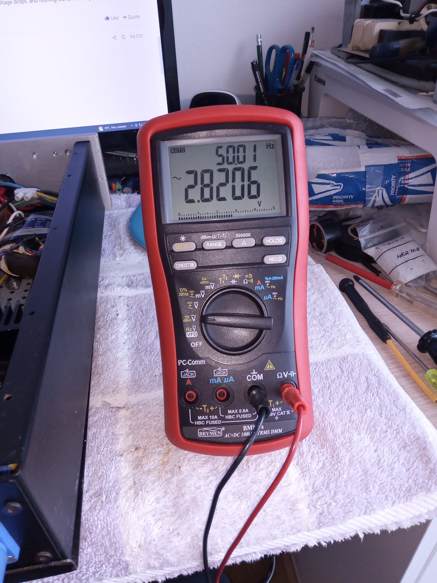

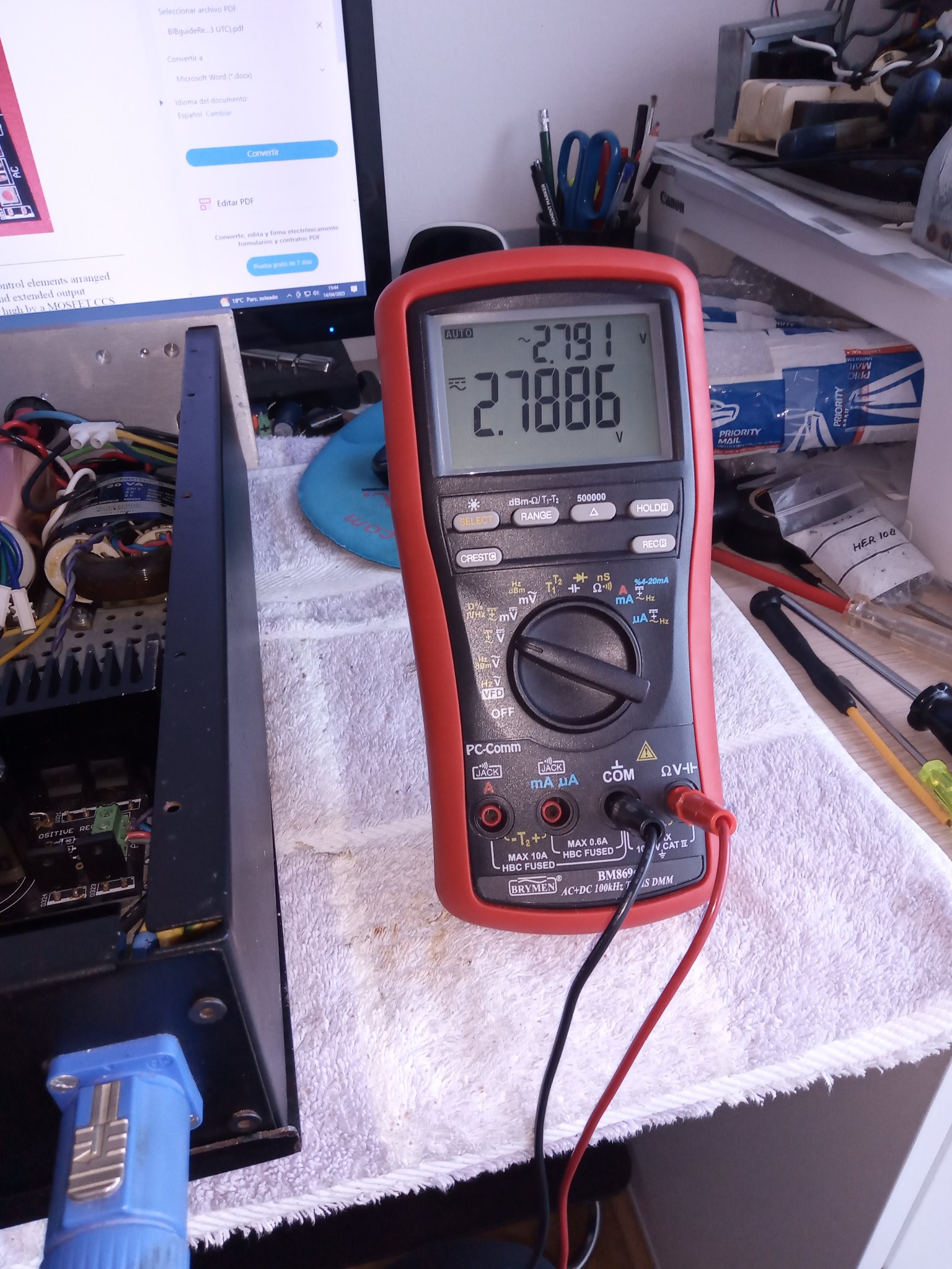

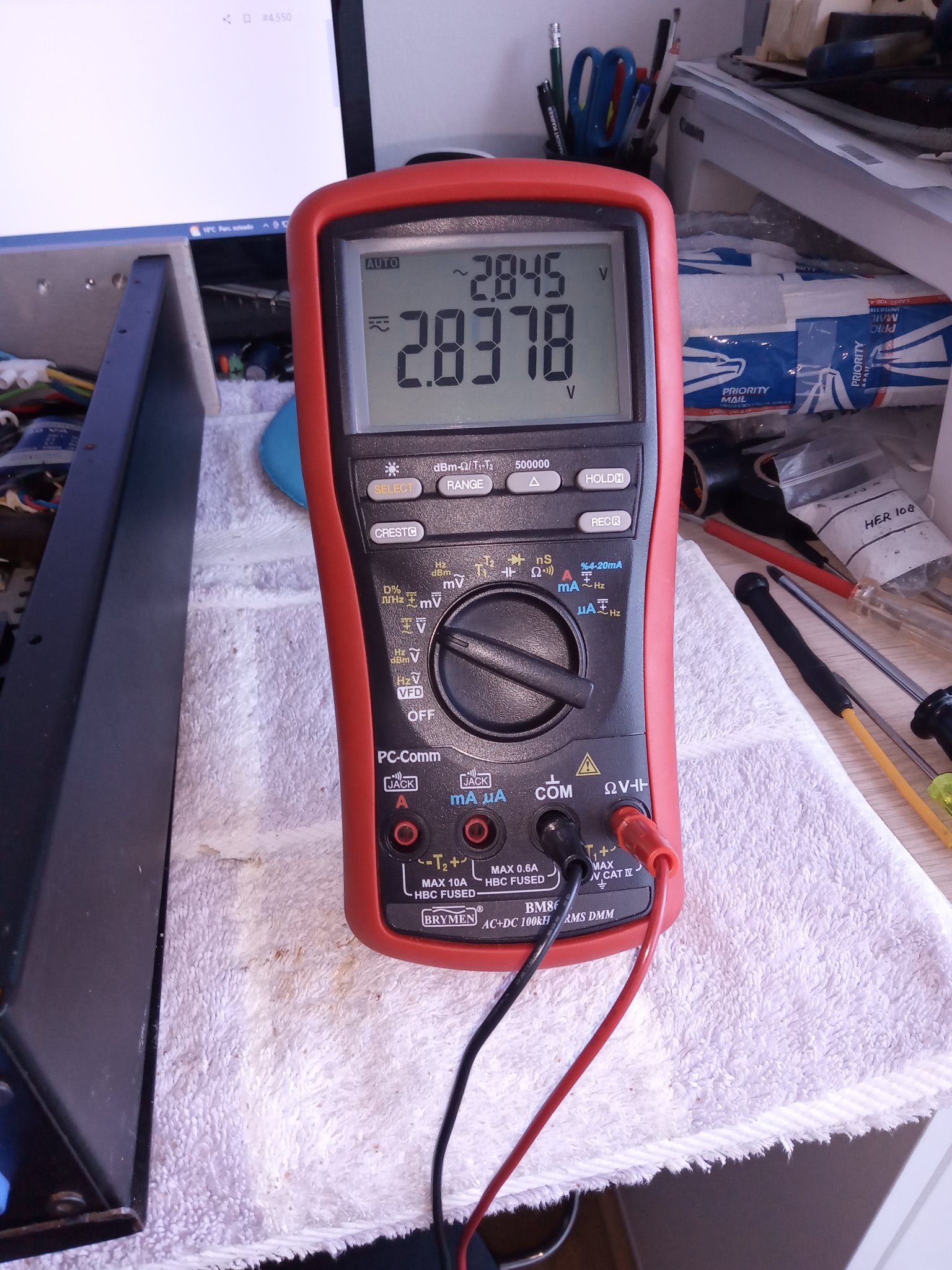

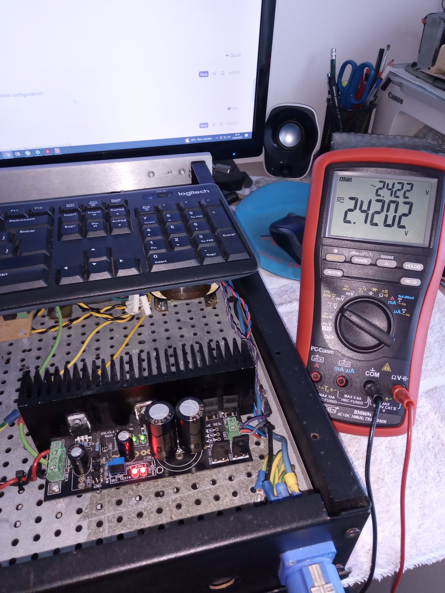

Could be the heater because it has inrush at startup overshoots the current limiter, output voltage drops, and nothing works normally for a little while until its mA current demand goes to spec.Near 800mA still oscillates, could be the issue Zobel network related, because several times the tester reads 1 or 3 volts:
“An electrolytic can be used also as per BOM, in that case the R107,207,307
position MUST be shorted with a jumper"
Did you do that?
Did you do that?
When remote sensing is defeated there must be permanent jumpers configuration for that mode. Not allowed to be powered with sense nodes not closed to force nodes.
Salas fixed, I'm sorry was the wire with enough section. Trusted the seller as tester silicon wire up to 1000V 1x0,50mm2 (20AWG) so 2.5A. Is this one https://emelec.es/wp-content/uploads/2015/01/Q2-205.pdf
