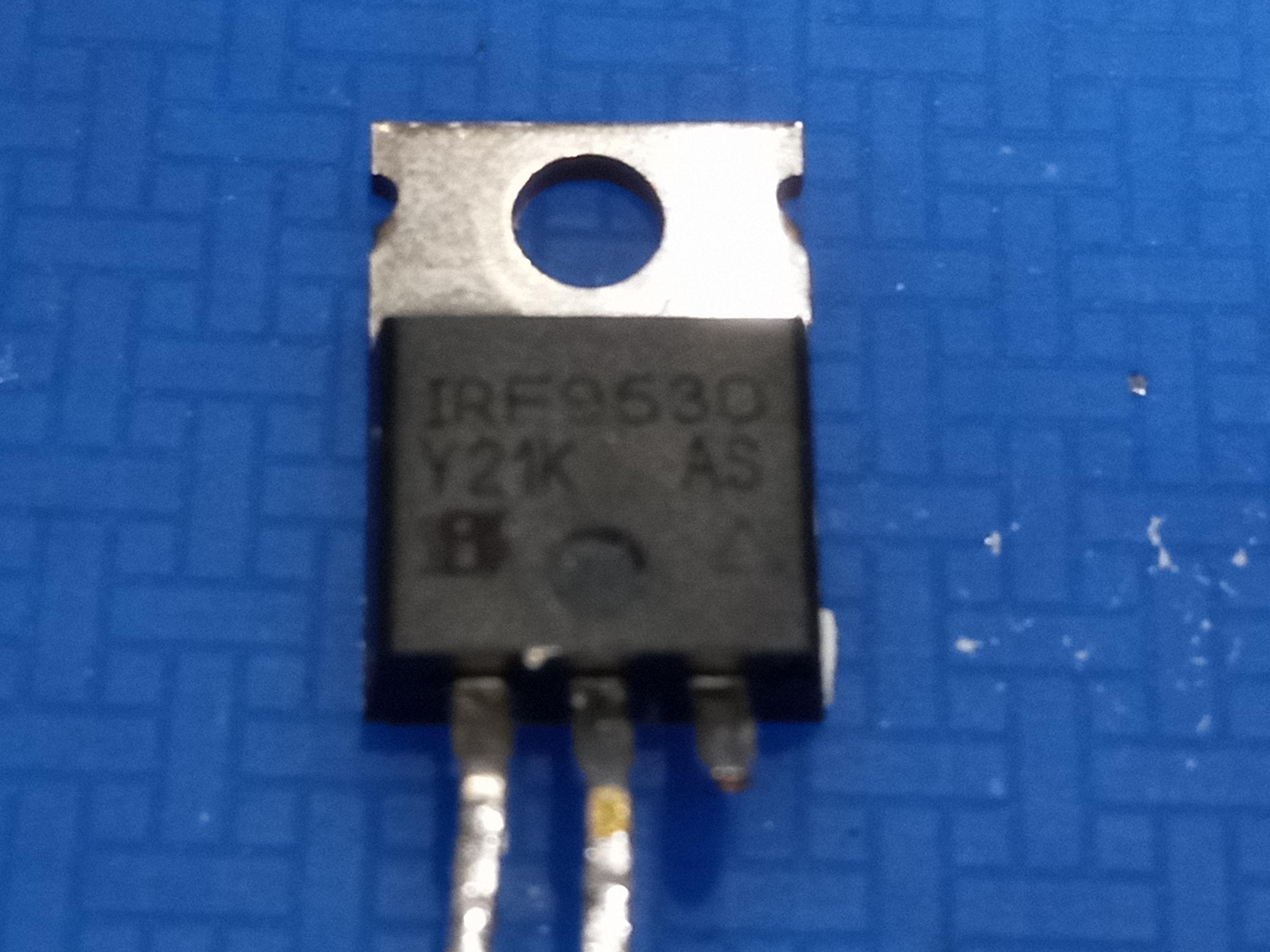

Load draws 900mA, it's enough 89mA as spare for the reg.?
Enough if 900mA is not overshot by practical load tolerance
There could be some tolerance as in all active parts. Anyway, see if replacing Q306 does any good first.
Bingo Salas🙂, replaced & now is working OK, thanks. When I was desoldering immediatly noted the broken leg.
