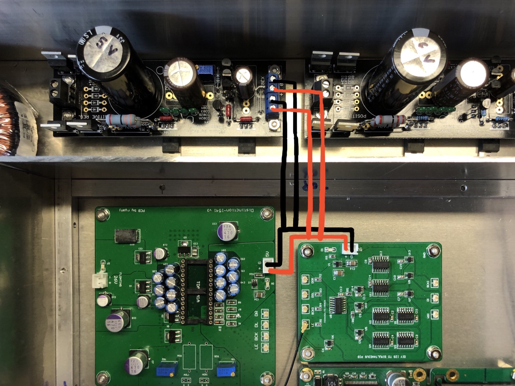

I’m in the process of repurposing a SSLV Bib V1.1 that I assembled with your help recently.
I want to use the SSLV power supply that is set to produce 5V to power two different boards in my DAC project. The D3 DAC board requires a +5V supply as does the I2S to Simultaneous board.
I’m pretty sure this SSLV is already set to produce enough current for both boards. I will be re-checking my notes and measuring it before use.
My question is how should I wire the SSLV to the power inputs on both boards if I want to maintain the 4 wire sensing feature (assuming that is possible and I’m not required to use a 2 wire connection).
Do I have to run 4 wires to each board in parallel back to the SSLV board?...or can I jump from one board to the next in series?
Thanks in advance for any guidance.

You could bridge the + and 0 power input nodes across the two boards with thick copper bars or thick wires and solder the incoming force and sense wires at the middle of the power sharing bars.
