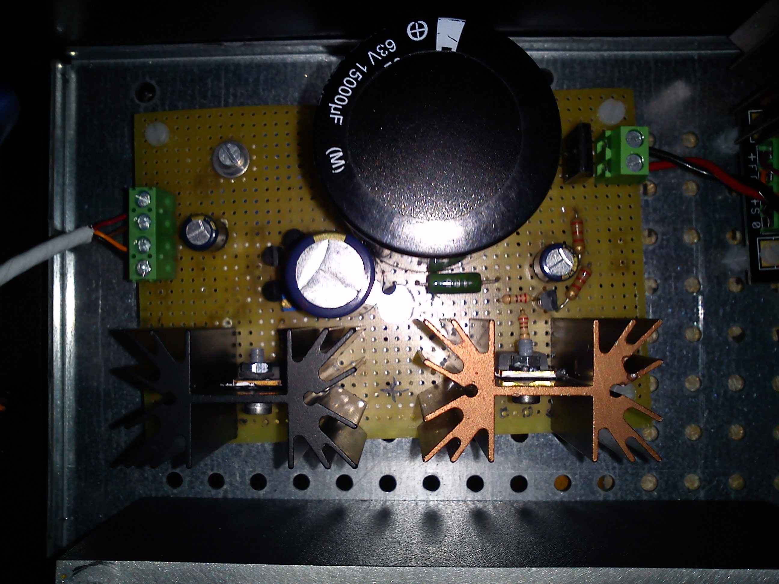

A pic of my Salas SSlv1S regulator 1.2V Vout 360mA as per Disco's schematic just for fun

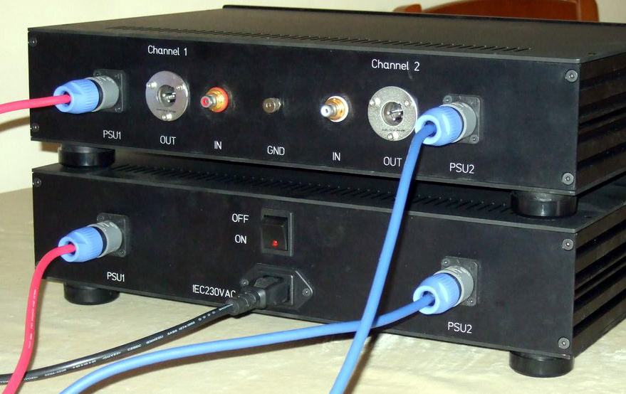

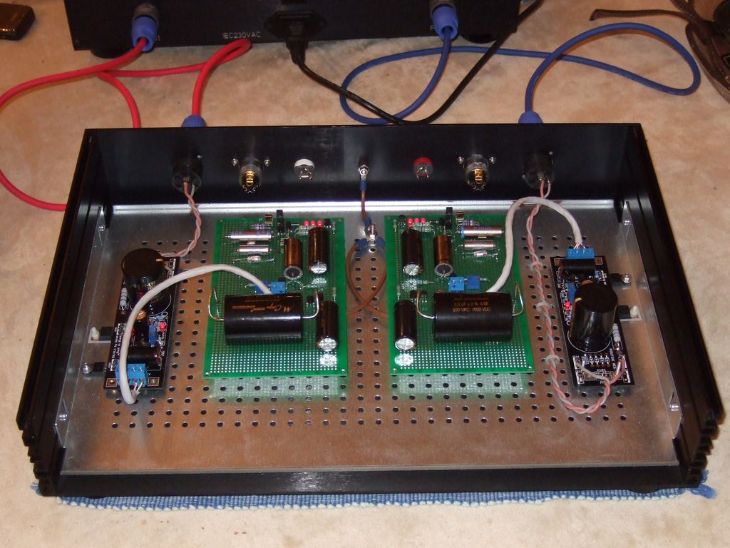

My 37V double mono Bibs just for fun.
P.S. How do I set the correct current?😀
Haven't you read post #1! jeez....😀

Congrats Nick very neat & professional work😉
Wich main filter caps are you using, Mundorfs, wich model capacitance & voltage?
I see you are using some Mark teflon caps in RIAA paralleled with polysterenes😉
Zobel caps are Solen?
The output caps are Mundorfs silver?

Nice build Salas
A new riaa Build ?
I like the two PSU lines 🙂

Its the Mlytics the black with gold accent (more of those in the psu box too and 2x120VA Rcore), the output is the silver/gold/oil. Its a double mono for an audiophile friend. And he bought expensive stuff to make it. Full of Z-Foils etc.
Heavy duty, they can power stage monitors.

I suspected that you use more psu caps because I see in your pic that you don't use rectifier diodes in the BiBs, are you using a MOX resistor to set the current? as you know there is a sensitive position for sound my 1st option Mills & my 2nd option Welwyn or Vishay / SFernice both vitreous enameled, a lot of better sound using them: checked lately in my Disco's 1.2V Vout & my Bib 3.3V Vout vs ceramic, MOX, Kiwame. What caps are you using for lytic Vref & for film Zobel? are them bypassed with teflons? The cable used between regs. & mm/mc RIAA is CAT5?
About mm/mc RIAA:
Wich is the gain?
Wich cart use your friend?
The other resistors are all Shinkoh?
