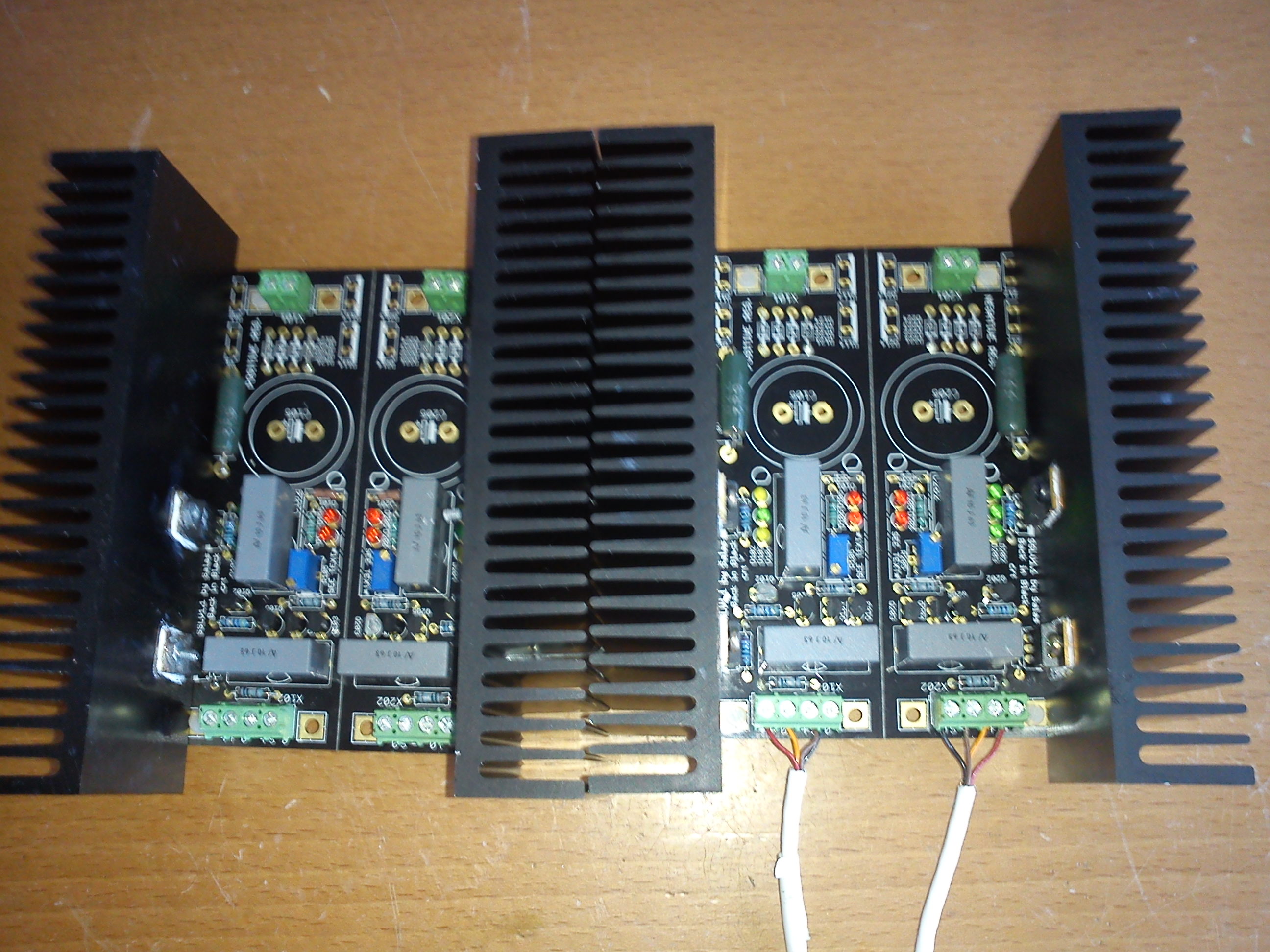

Well, new current set resistors are in. Good and bad news. Legato supply current is almost exactly where I want it. Positive side is +14.9V@334mA (Rset=5r). Negative side is -13.9V@296mA (Rset=3.3r). These rail voltages put my Legato in the "sweet spot" (VCC/2)-1V . It all looks quite sinister on my chassis, Darth Vader would probably use these regs in his projects. Tried a 2r for Buffalo supply (5.3V), ....runs 650mA, so I plan to back that off. Probably needs about a 2.5r I would guess.

Just for fun
One pic with new heatsinks mounted, just for fun. Will be nice to have R101, 201 & 301 with a small space to fit Caddock or other precision power resistors also can be sinked to the heatsink.
