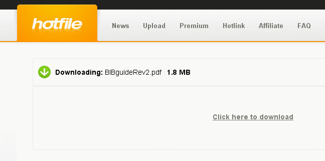

How do we download this pdf?download is: BIBguideRev2. Good luck!![]()
I clicked on it and waited the 30seconds for free download.
I tried to open using acrobat and it says " Can't, does not recognise file type".
So I tried to open in another window. Now it's asking me to wait for 30 minutes because I have exceeded my hourly download limit.
You just save it after you press download. Don't click open, click save. I just got one down for test. Saves OK.

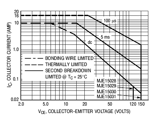

-When 5-5.5 Vout wich is the best reg BJT or IRF or depends of application: clocks, DACs, analog, etc.?

Depends on the application. The specific BJT configuration gives less open loop gain extension, so I would use it on digital chips mainly. Also if someone tests the BJT for higher voltages, must look at its SOA before.
