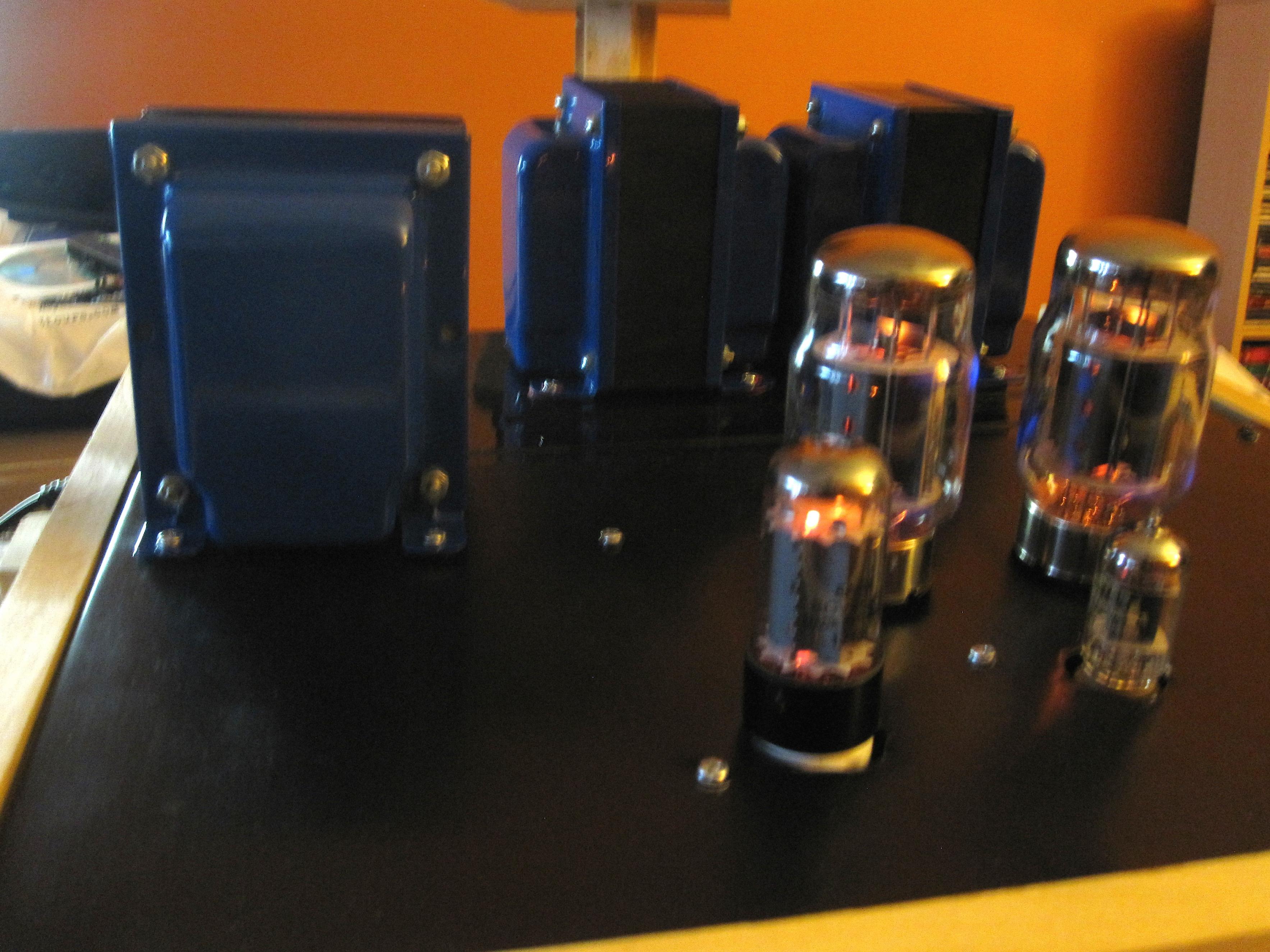

Made some dummy load using resistors, and a wet towels ready if any fire should start.
Did all continuity testing for the primary power, then the ground testing for all metal, touchable points.
After that, I did all the steps in Ty's instructions, and got a full ok.
The only thing that bugged me after this was one input jack not staying put. I got very flimsy and cheap input jacks, so had to unsolder and re=solder those and they still don't fit well - had to use a DIY rubber part to try and keep it in place.
After that, my DAC was misbehaving, but I hadn't noticed, so I thought we had distortion and hiss.
After DAC power cycle, it's alive and well!
Worked first time, huge sound, much, much better than I expected, even at the higher frequencies. Looking forward to adding the motor run cap.

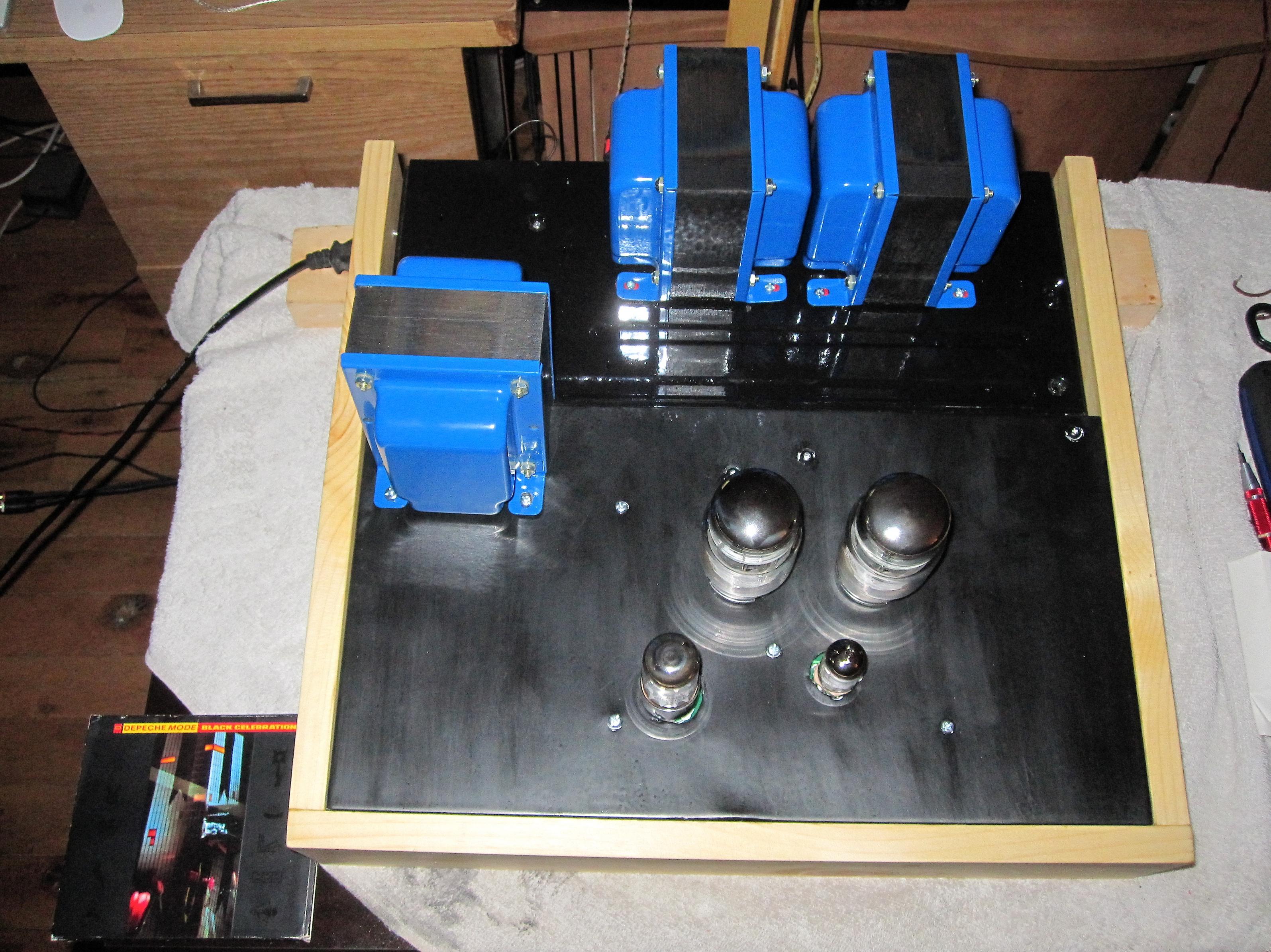

Pics, with a Depeche Mode Black Celebration CD for scale:

Had a good listening session yesterday, and the full range sounds sweet. No bass nor treble lacking, mid-range is detailed - vocals appear more forward.
I was very impressed with the resolution of fast attack transients - this amp is going to be awesome with percussion and strings (thinking guitars and the like here).
It seems the sound is more room-filling, as if there were sources between the speakers and the listener.
I have some low-pitched hum which appears after a few seconds on powering up, but other than that, the sound is amazing as is, even with my affordable Solen caps and affordable Russian tubes. The only thing I have not restrained myself with are the big Edcors. Perhaps a choke is needed here. Maybe I will add the motor run cap.
Mechanically, I'll perhaps add the convection holes as the amp heats up a lot and I am also thinking of the feet to help with heat dissipation and stability/vibration.
Additionally, the IEC plug isn't secure in its opening, it seems the screws are resting on empty, and I am disappointed with the input jacks and speaker terminals (that's what you get when you hunt for lowest cost) so that I will probably replace them with more durable and solid ones. This morning for instance, I probably have some short internally as the left output isn't working (the left KT-88 seems fine).
Feature-wise, I think I'll enjoy the amp as it is for a good while, until I try the UL mode implementation, a subwoofer out, micro-processor monitoring and power-up sequence and so on, with tube-rolling and cap-rolling and other tweaks much further down the line if at all.
A friend of mine who is big in audio DIY mentioned using an interstage transformer instead of resistor + cap, and hence maybe one day I'll experiment with that, but this would require some PCB or wire hacks, so it's not for now.

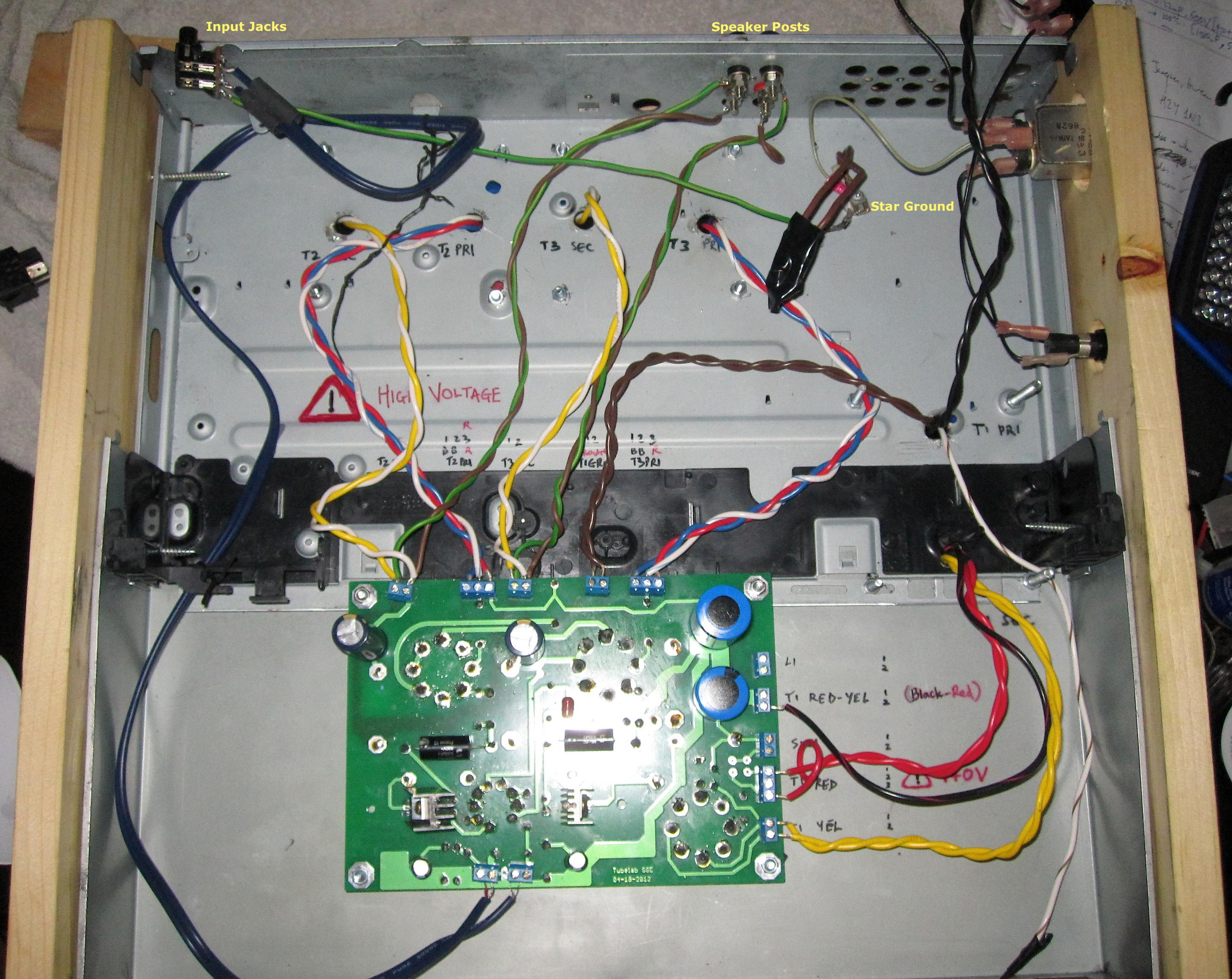

Circuit pics from today:

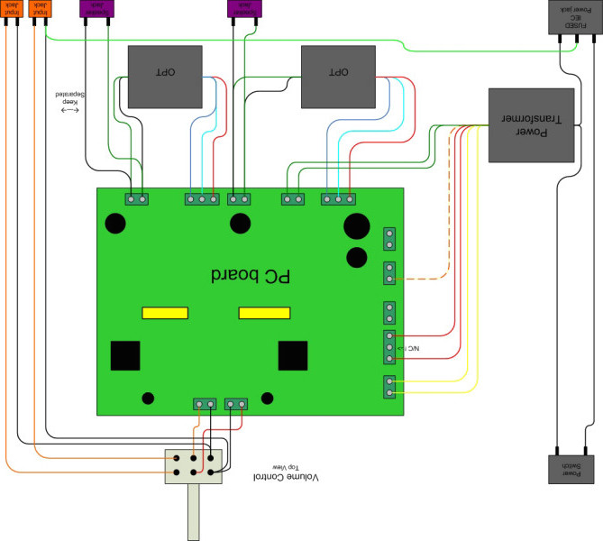

Edcor CXSE Cathode Feedback wiring.
Planning to wire the Edcor CXSEs for Cathode Feedback, since I don't have a choke. I don't know if the wires should be inverted or not for the Edcors.
I think I should go for UL mode first before CFB, but the thing is, I wired my OPT as in the configuration with choke, so I have to check that as well and I probably thus have a ground loop which explains the hum.
So for today, I already installed new salvaged RCA inputs jacks, and will need to do the wiring to them, then I am going to check that Ultra-Linear implementation.
It's not too easy to follow on the wiring page, I would have preferred some text description of what to disconnect from the terminals and what to connect when going from normal triode to UL, but I believe I should manage.
From what I gather, going from triode to UL mode necessitates that the jumper for the OPT primaries be removed from the PCB, and instead, the Edcor CXSE OPT primary White/Blue (Screen), corresponding to the Tubelab cyan wire in the wiring diagram is wired in the middle of the 3-prong terminal for each.

Looks like the circuit pic I tried to post last time didn't go through. We needed a new one so here it is below.
I have rewired new input jacks on the upper left so that there's no possibility of shorting between the output at the speaker terminals and the input, unwired the grounds to the speaker terminals, made the OPT go to the PCB for CFB (my girlfriend would have laughed at me right now with this 'acronymese', but she loves what I'm doing - she's cool like that), and also removed the little jumpers to implement ultra-linear mode (the Edcors are tapped at 40% based on the docs). Had a lot of fiddling to do with the terminals to accommodate the two wires.
It blew the fuse on power up, so it's either I have a short somewhere or the fuse didn't cut it. Today I'll check for shorts and also try to find an appropriate fuse with about 2A. Of course, if you find anything fishy, let me know, please, thanks.
