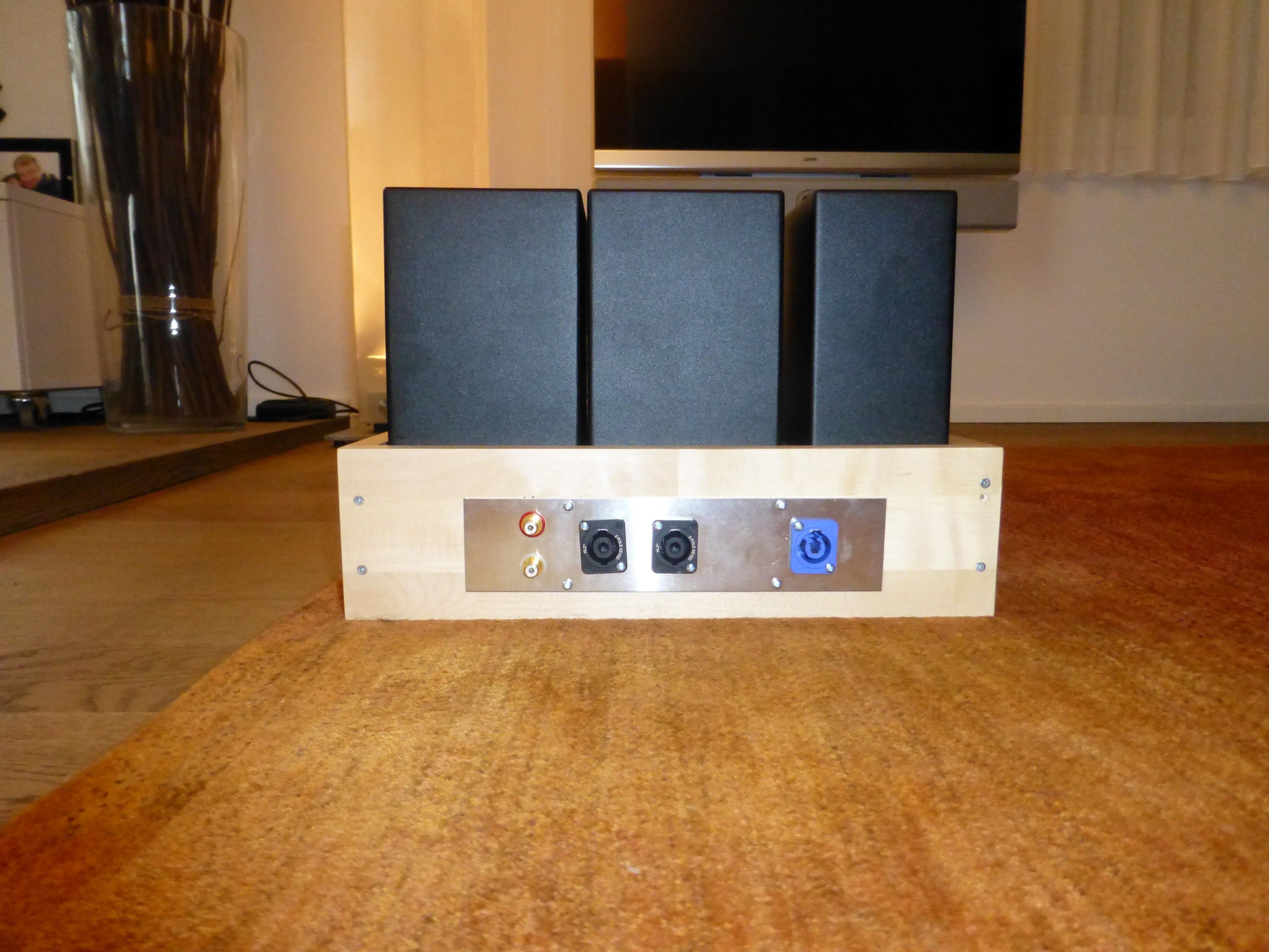

Hi there,
I was fed up cutting out the hole for the IEC and installed a Neutrik powerCON on my SSE powerCON 20 A - Neutrik
Only a round hole to be drilled and a more secure connector, I think.
Best
Michael

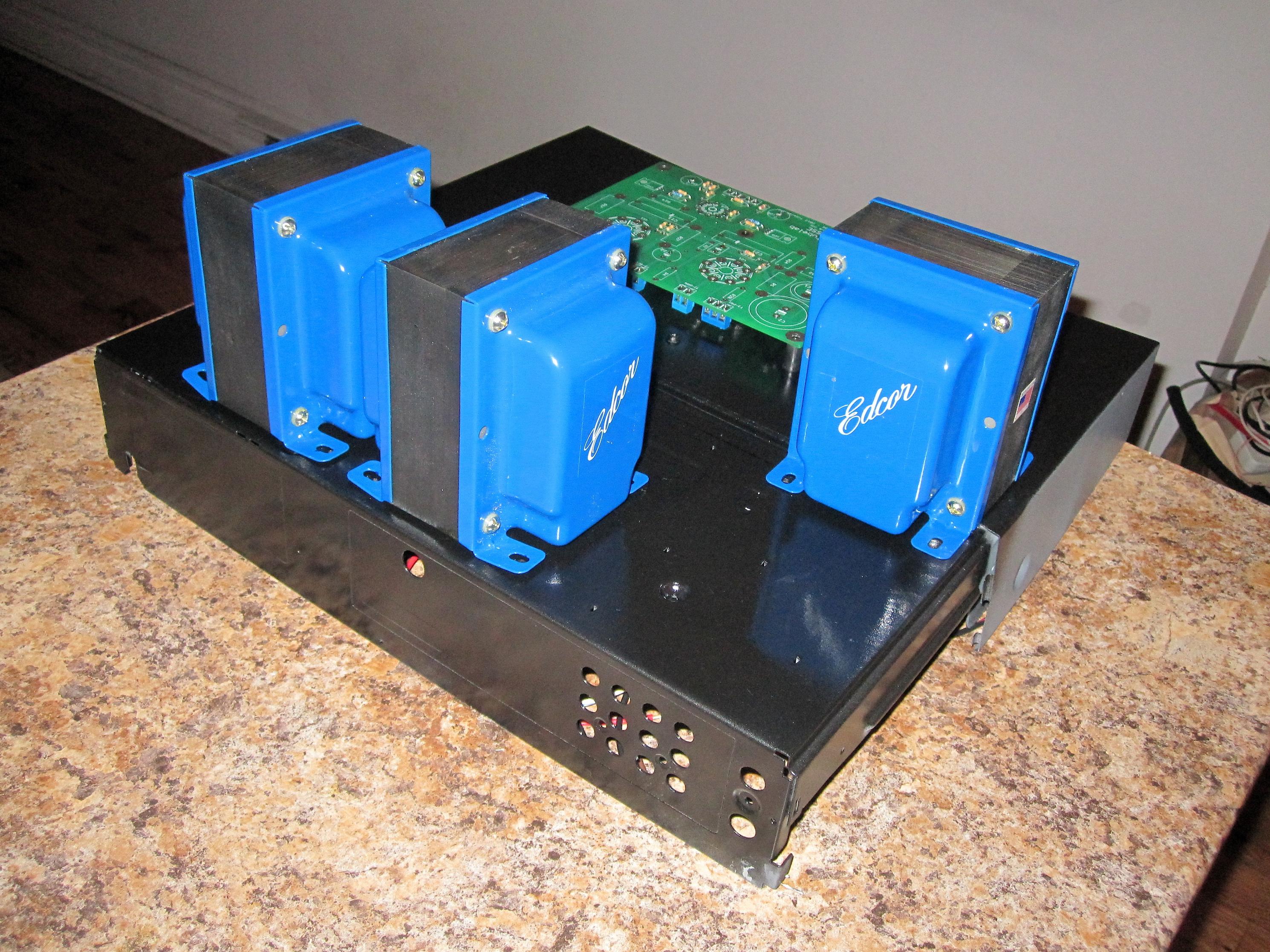

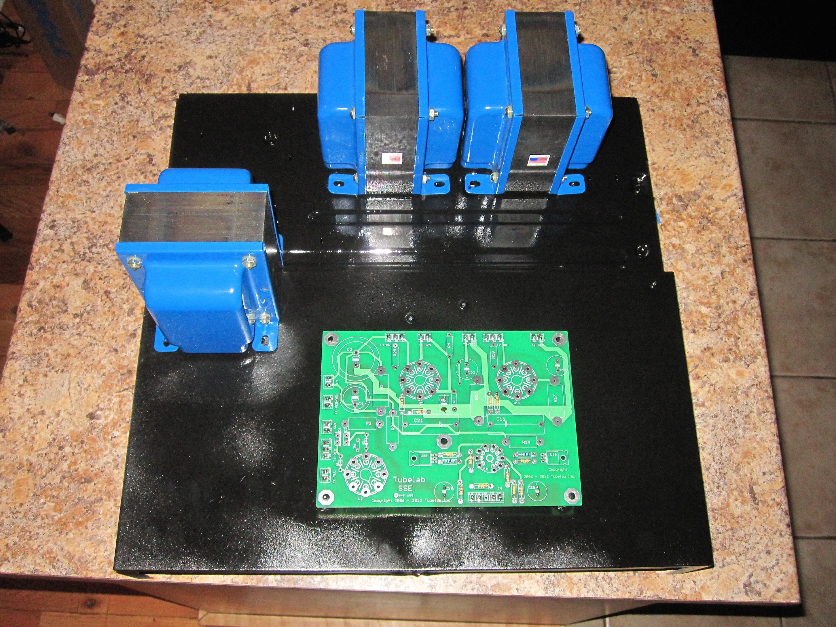

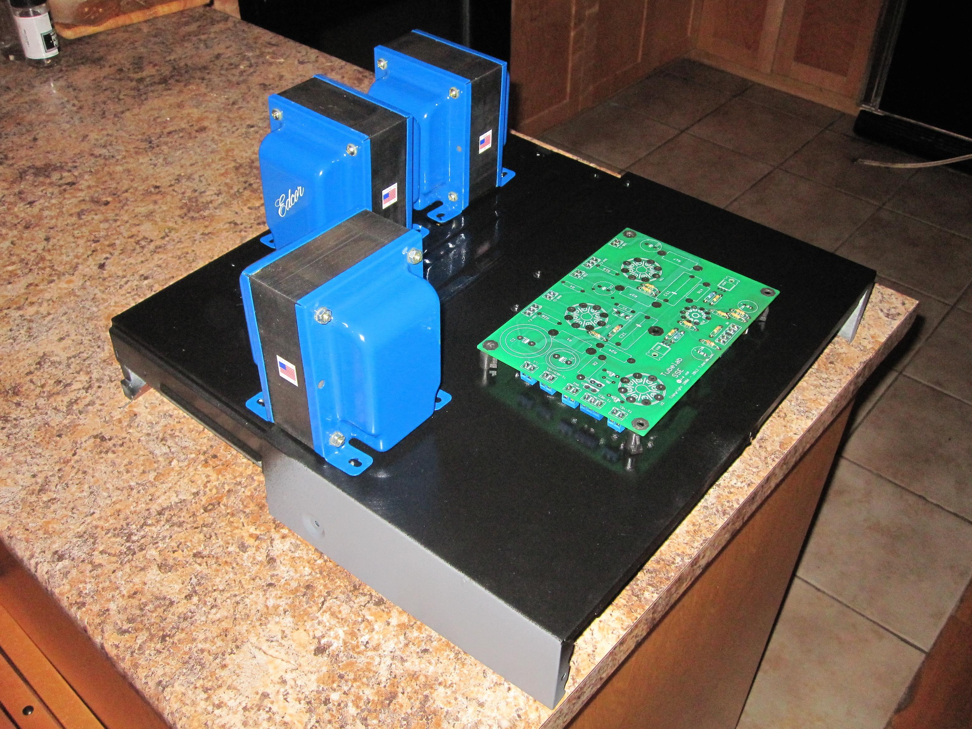

Initial test fit for transformer and PCB holes.
With un-sanded black coats:, checking if the holes are large enough for all transformer wires and not abrasion occurs, if the screw holes are well-placed, and if the PCB holes are well-placed:
3/4 shot:
Back shot:
3/4 shot:
Back shot:
