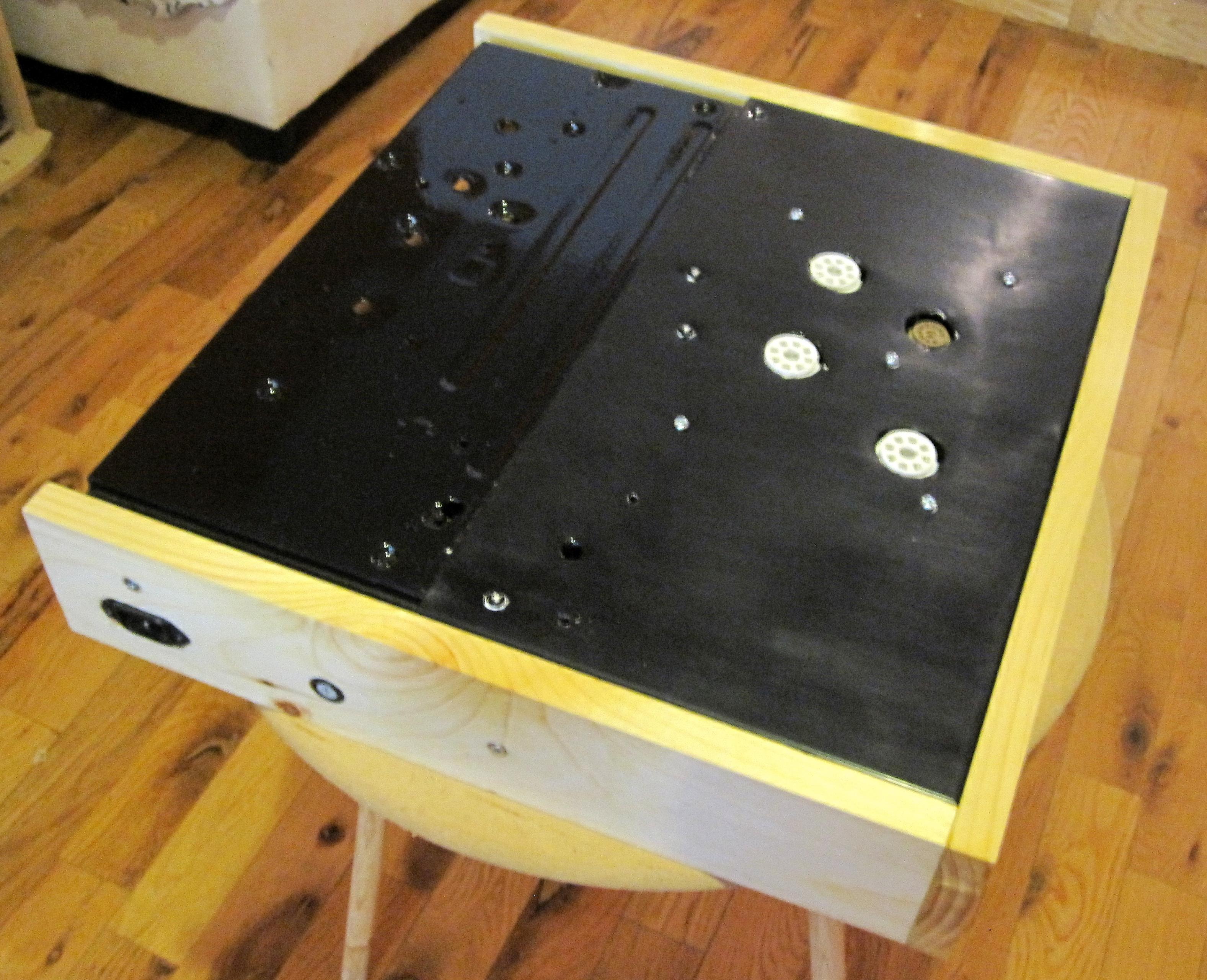

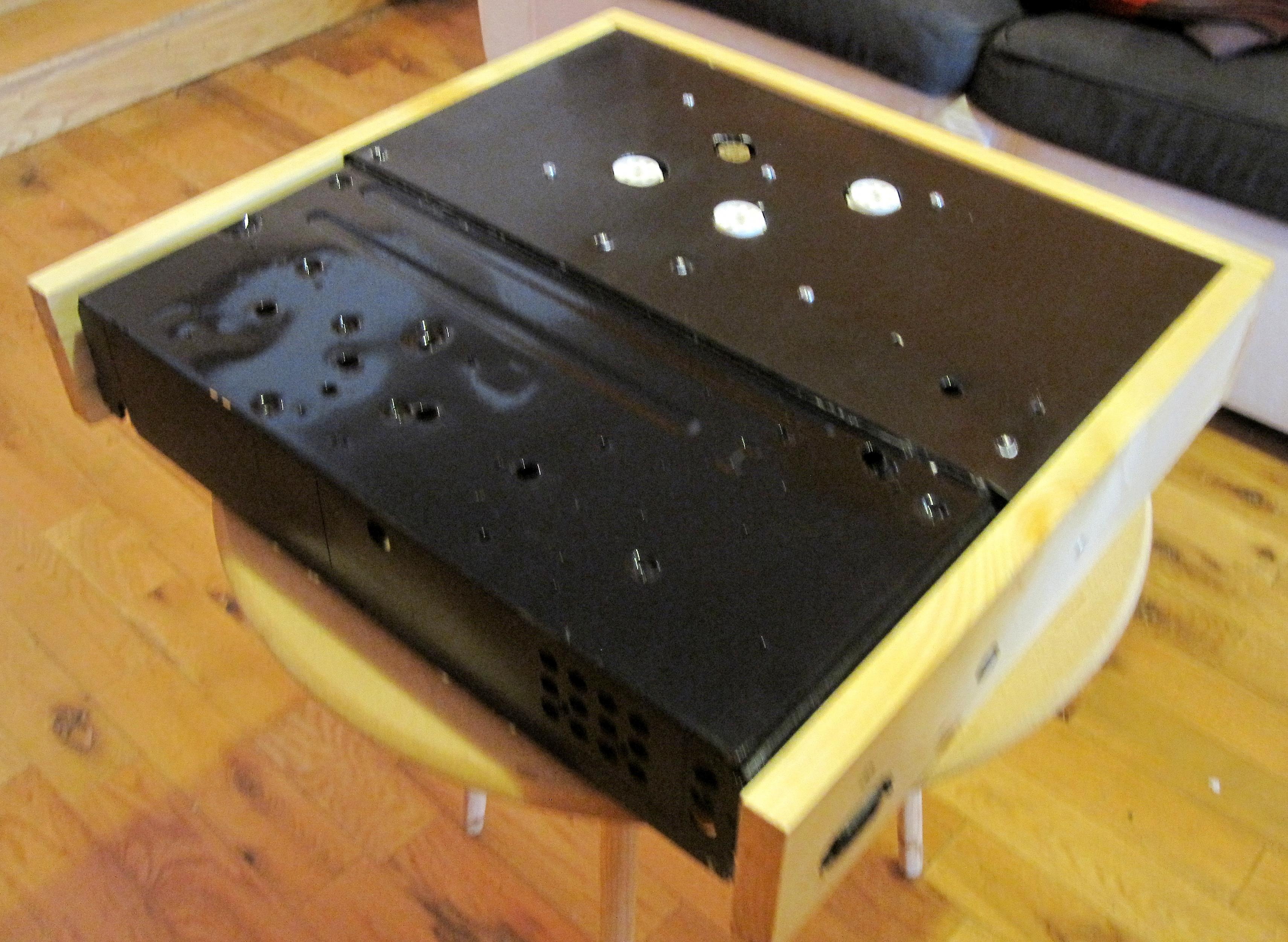

I noticed something while wet sanding the black chassis: of course, the surface does become quite flat and smooth to the touch. However, the black paint becomes greyish.
I am not sure whether I am scraping off too much (doesn't seem like it since I use 800 grit with a sponge, then 1,000 and do not scrub too much after several coats of black paint) and hitting the grey primer underneath, or it's the effect of compacting the black paint granules on the surface(?).
In the end, I want this to have a black glossy look, but until now I only manage a black-grey/striped look...
So, I am probably going to end up just putting in several coats of black and leave it at that if I cannot do it better, but of course, it won't look polished.

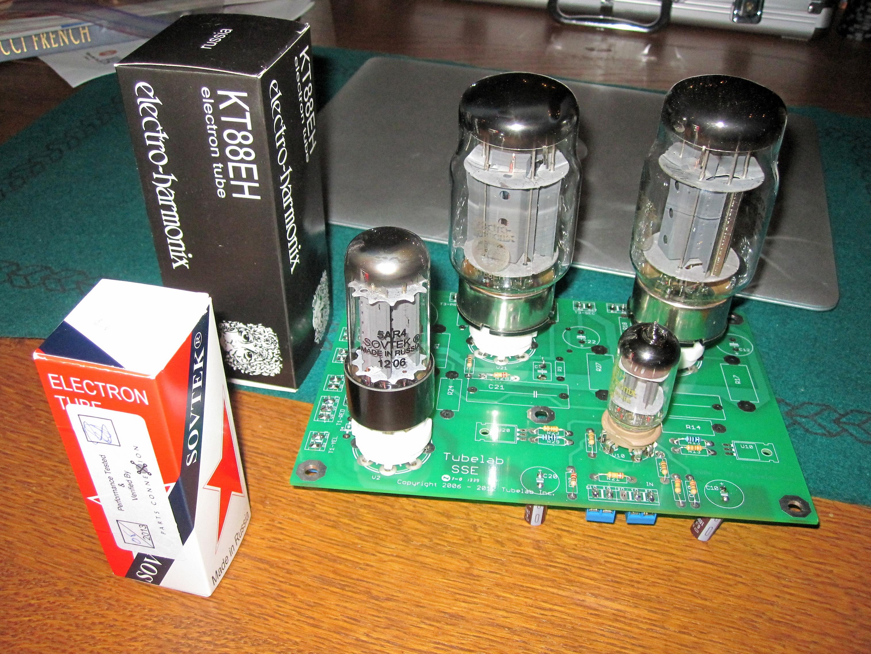

'Toobs, We Got Toobs'
Did you get any spares ? It's good to have some spares on hand, at least a
spare rectifier.
The Sovtek 5AR4 is a pretty decent tube should last a good long while with this amp. (the JJ versions not so much).

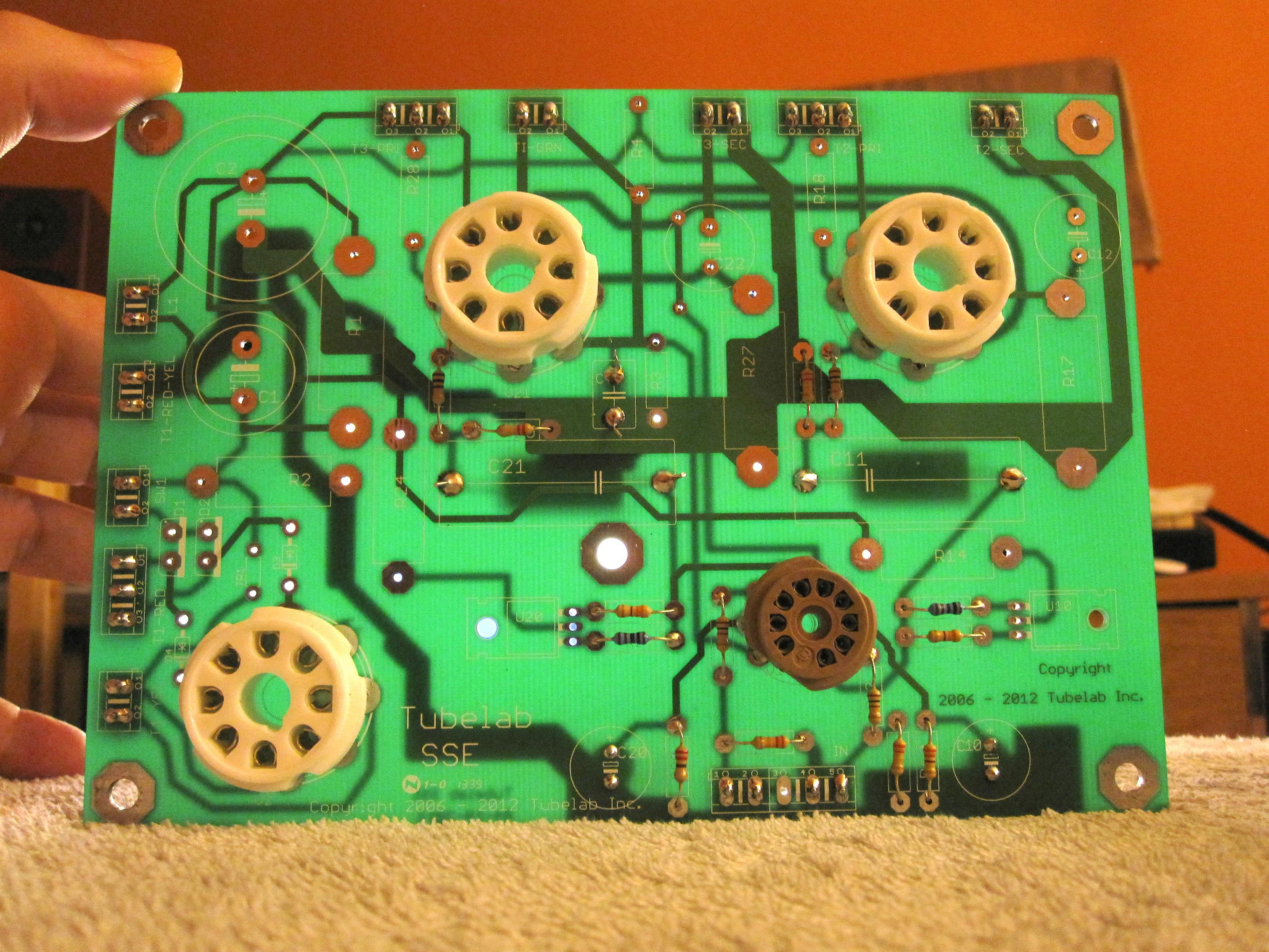

Sockets and Solen cap...
After soldering the sockets and coupling caps, I found out one of the octal sockets was badly placed...
Now, even George says that it's near impossible to remove one without either damaging the socket or the PCB.
It took me a good half hour of painstakingly removing excess solder, heating the end of the pins and pushing the pins out, pushing them towards the centre or making a slight lever effect with the PCB and socket to be able to extract it. (I have a fair amount of experience manually extracting components from old machines to fill my salvage box - these hours came in handy).
So, I managed to remove it and solder it the right way this time, but on doing that I noticed I had burned one of the terminals slightly (no big issue here), but more worrying, I had burned off a little part of one of the Solen cap sheath.
I just hope this will still work. Well, if not I'll have to get another one and fortunately it is affordable.

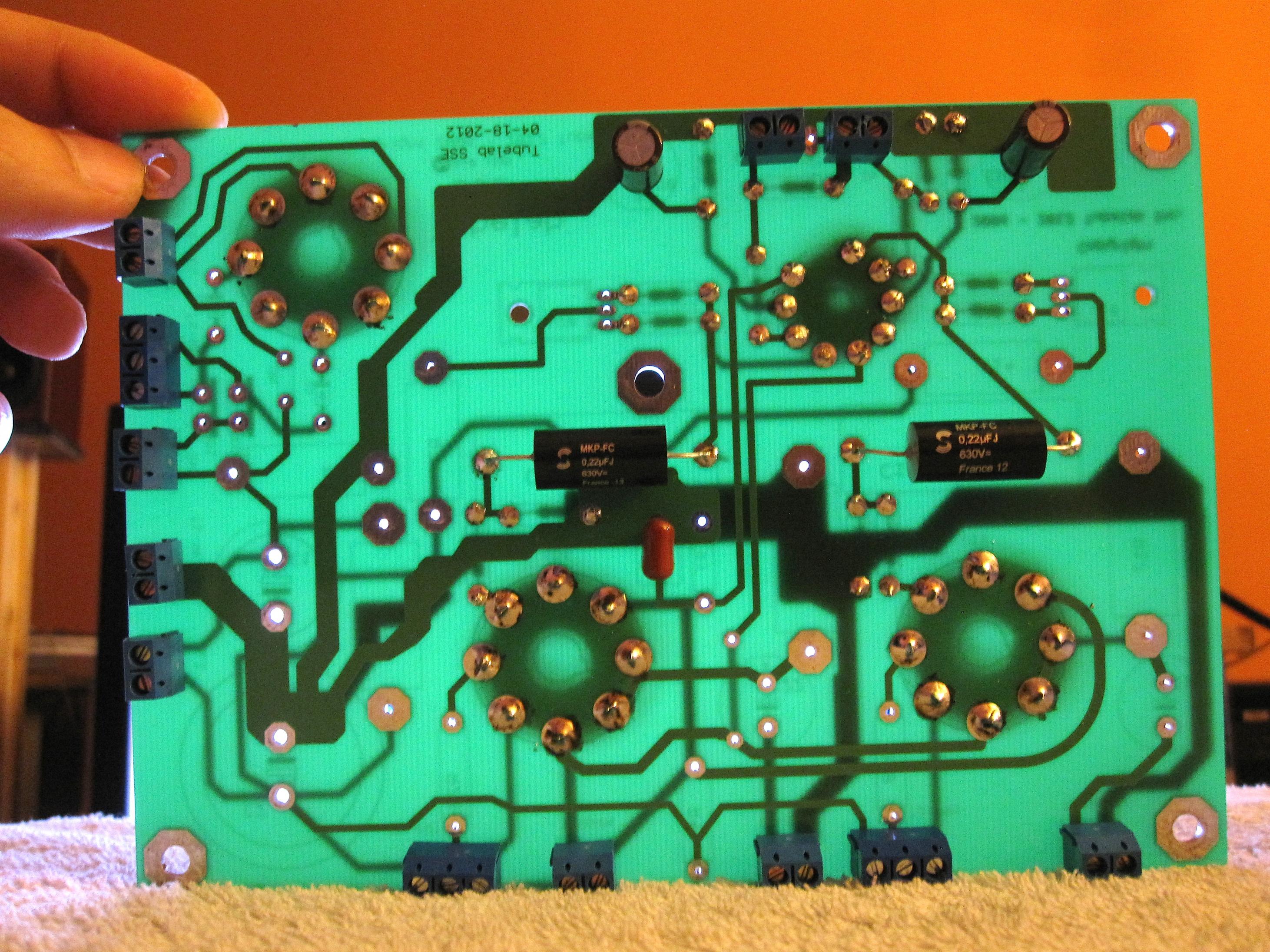

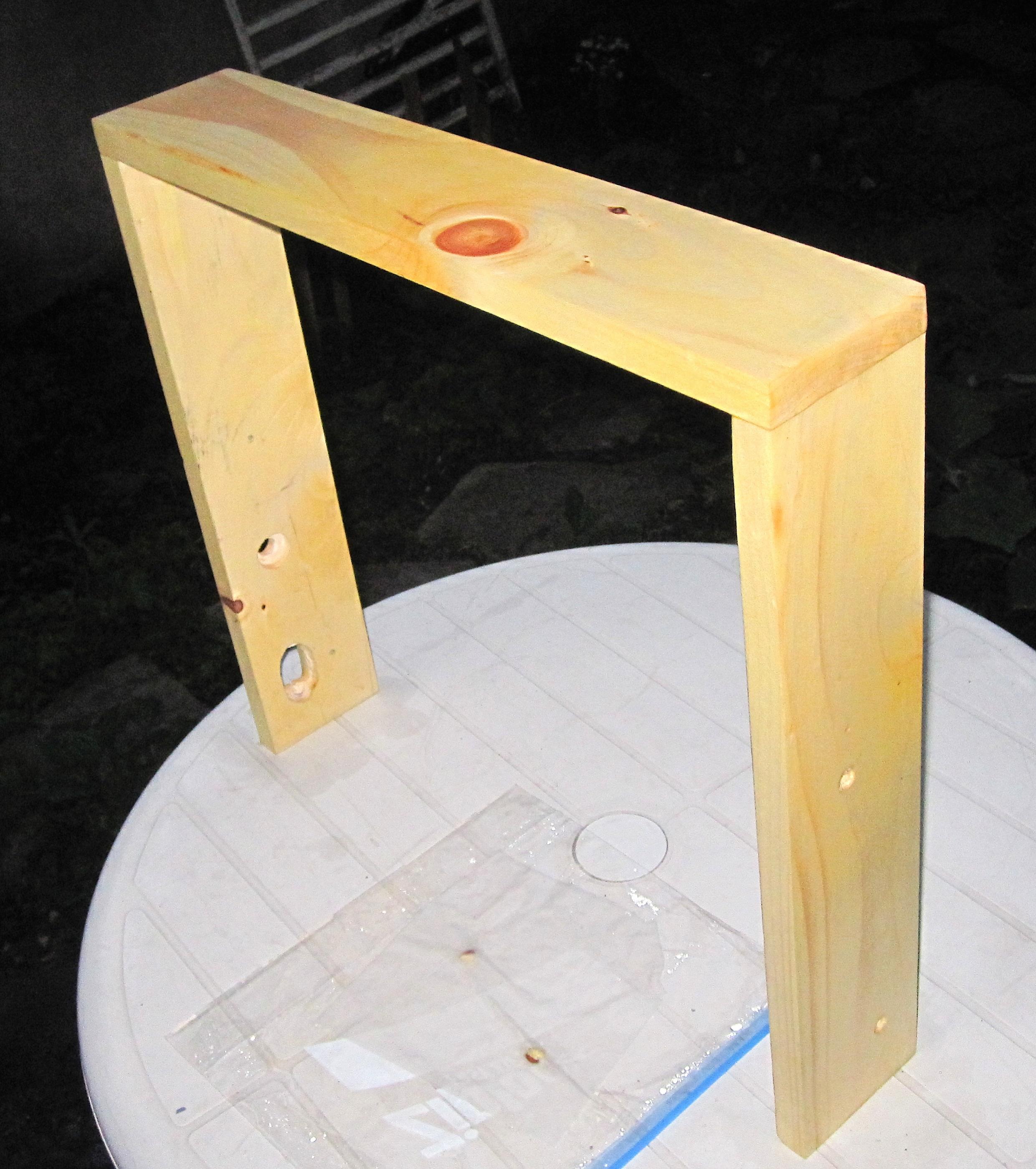

PCB and wood frame pics.
PCB partly filled, with the costly mistake with the badly placed socket on the upper right. Fortunately, I managed to extract it without damaging it or the PCB, but the corresponding Solen cap suffered a little:

White pine frame with a couple of coating of linseed oil, drying in the garden (with IEC and fuse holes):
PCB with Solen caps (before sheath damage):
Looks like I have all the parts for a complete build today. I do not yet have a supplemental motor run cap, no volume knob, and some questions have been left unanswered, but I may get back to them.
After another wet sanding round yesterday, it appears the grayish look is because of scratches. This suggests that I should sand with even finer grit (2000). I tried polishing with Turtle Wax Rx polishing compound but found no difference.
The end result is a gray matte look, far from the glossy black I am looking for.
White pine with several new coats of linseed oil looks great though.

PCB filled up.
I see D3 and D4 on the PCB as well as TR1. I am not sure I've seen any reference of those anywhere else.
[Edit] A quick search brought me to this: http://www.diyaudio.com/forums/tubelab/216689-starting-sse-build.html
Ok, I'll see if I have those and add them or else I'll just add a jumper as George suggests in an older thread.

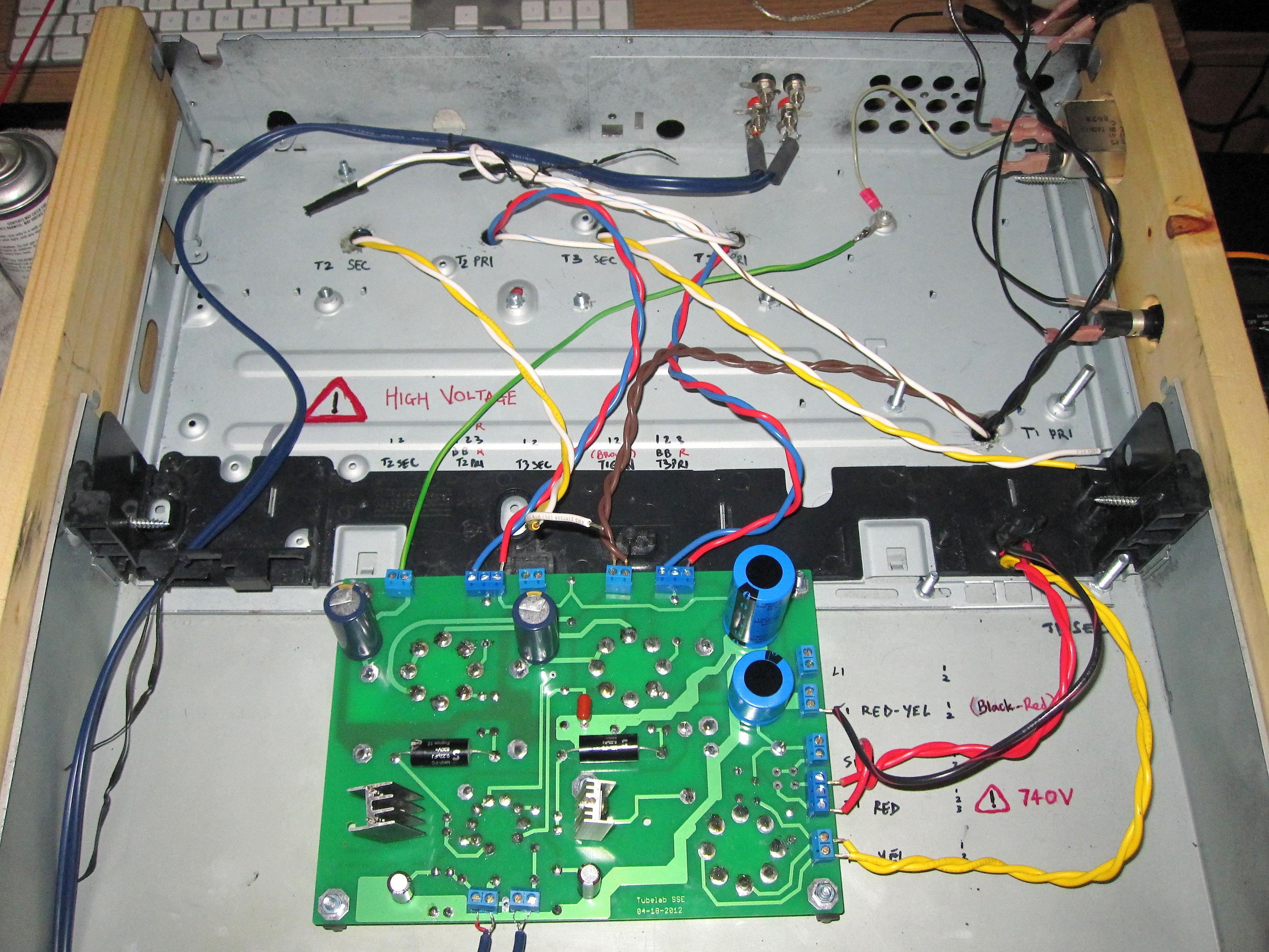

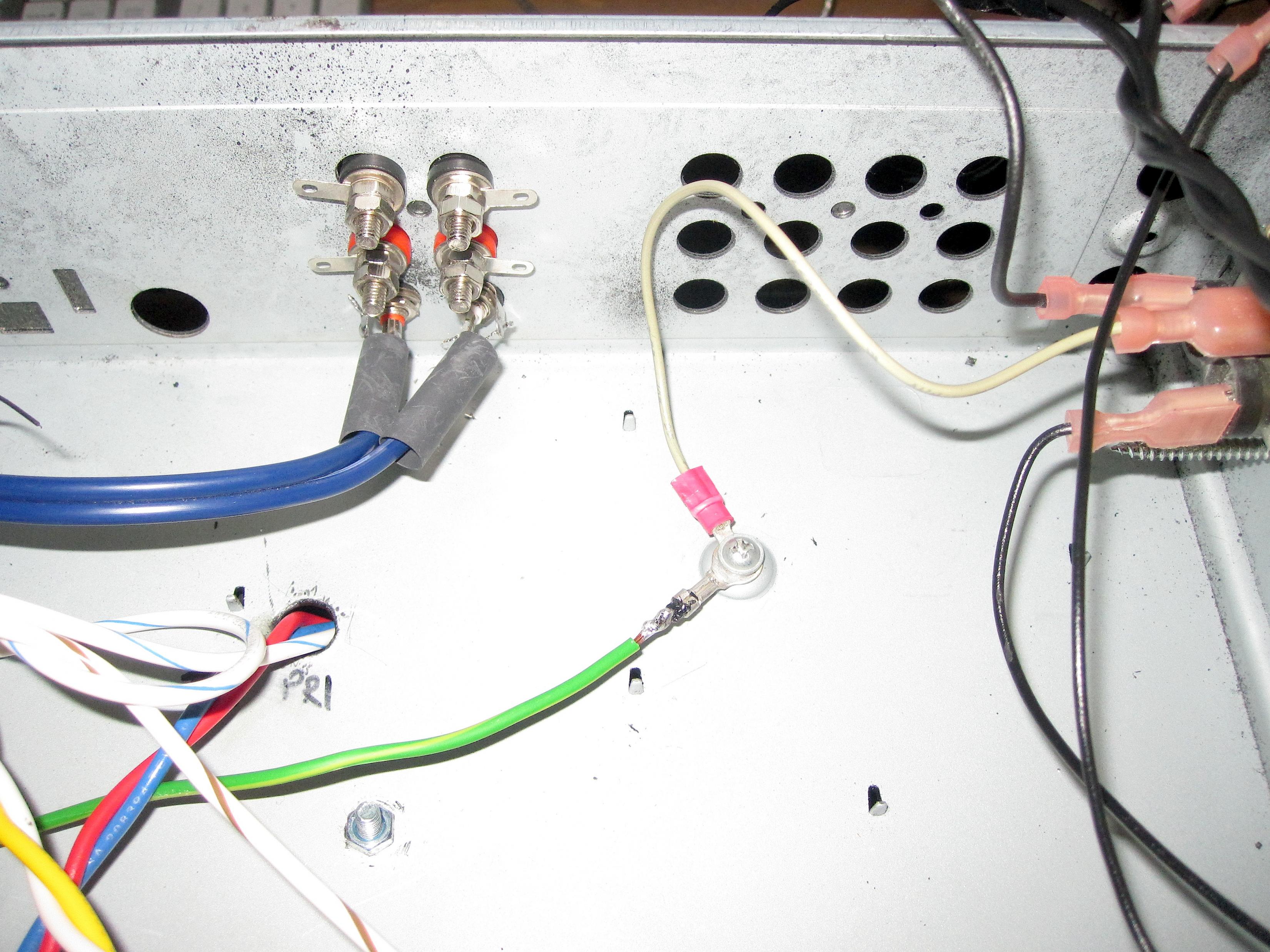

Wiring and grounding question
Installed the transformers today. The amp is very heavy with them, so I ended up working a lot upside-down today for wiring.
Wiring the Power transformer was easy as detailed on the website but transposing with the Edcor description of the OPT wires and making sure the proper Centre-tap is used. For the OPT, I had to search and found an answer by... Bob. So I know that the Edcor OPT 8ohms goes to + for the speaker.
However I am stumped about 'grounding the speaker terminals'. I have a tab on it, but there does not seem to be a separation from the signal to this tab. So I thought that the OPT wires should be soldered to that tab, but then what would be the ground?
Here are some pictures.
Wiring (can someone please double-check the component on the heat-sink on the right (the label is right-facing on this picture, to verify if it's well-oriented? Thanks):
Speaker terminals (no idea how to ground and connect this to the wires as the central shaft is connected to everything including to what looks like a ground tab that you can see horizontal):
