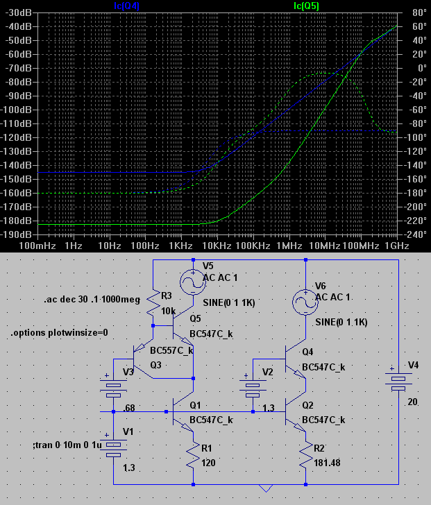

what matters in a CCS is AC impedance

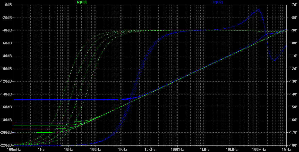

I take this to mean BW, since for any CCS I design DC impedance is the same as say, 1KHz impedance. Well, I've concocted two CCS's and posted the simulated AC response. Which one do you say has better bandwidth? Don't they technically have the same bandwidth, just diffeent impedance? If the blue trace rolled off at 100KHz but had a comparatively inferior PSRR of -117db at DC, would you consider it to be "audio quality"? Although I will mention - were this true the phase would also be flat across the audio spectrum - perhaps it is phase that matters more than DC or AC response? Not suggesting anything, just thinking out loud. [EDIT: I just went back and reread that post, I realize this isn't really an appropriate response but I'll leave it in anyways for your interest/entertainment]
Also, why can't we just add a resistor in series with the CCS? This would help damp ringing/high-Q peaking, and might allow us to use faster, lower voltage devices with low Cob such as the 2N5089 (5210 has higher voltage, same Cob) or company.
For interest I've also attached a PDF about a type of CCS that mitigates the effects of Cob, possibly of interest - and a modification of it to boost performance of a cascode. The PNP buffer before the cascode reroutes any current from Cob back to the cascode's emitter, so it hits a dead end. This also greatly reduces Early affect (as on Hfe and thus Ib, which is also rerouted just as described above), as seen on the DC impedance. The solution is also automatically temperature compensated, so we don't need to worry about using LEDs or diodes for biasing. R3 will decrease PSRR for rails - but we can split in two and tap with a capacitor to ground, filtering out any rail interference. This is especially effective with tube rails, since high voltages allow us to use a very large top resistor.
