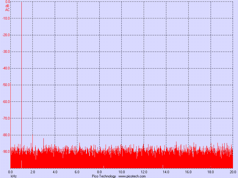

Does anybody have measurements results for SS CCS?
Oh yes I have. Despite all the unscientific claims that it adds upper end thd; not in my case. The opposite. The only caveat; I am using pentodes config as triodes so the effective impedance is reduced when compared to the high Ra of the pentode. So the problematic hidden capacitance of the CCS pass driver is masked to insignifigance when using it for equivalent lowish impedance circuits.
Theme read:-Morgan Jones, book page 138 ++ Valve amps 3rd ed.
Study the fft spectrum. Gen carrier set 0dB 2.5V rms # 1Khz; F2 sits notch under -80dB and F3 more under. I couldn't ask for more.

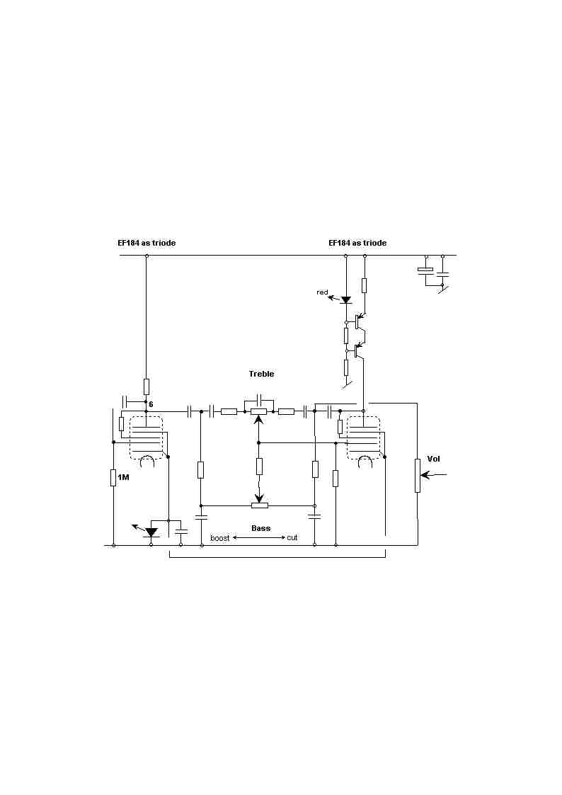

The circuit was a Baxandal tone control using pentodes as a triode. This is the perfect application for a CCS in the anode.
Sometime ago I've tried a CCS for the anode load on a pentode video tube and it gracefully oscillated, (damned obvious, thinking about it, that a tube with such a fantastic Ft with unlimitless anode impedance will bound to oscillate) a bad move as I did the check on an unscreened pentode so CCS on pentodes is not a wise thing, even with a tight layout. The damping from the anode resistor has gone to near infinity, all what remains is the internal electrode capacitance (often a mere 0.2pF) and the several pF of the hidden CCS pass transistor capacitance + layout leads opening up possibilities of instability. So there is a worstcase point that even if a design worked, the CCS would act as a capacitive shunt, increasing thd.
As always I'm open on my theory but I'm avoiding pentodes. My cellar comes first.
