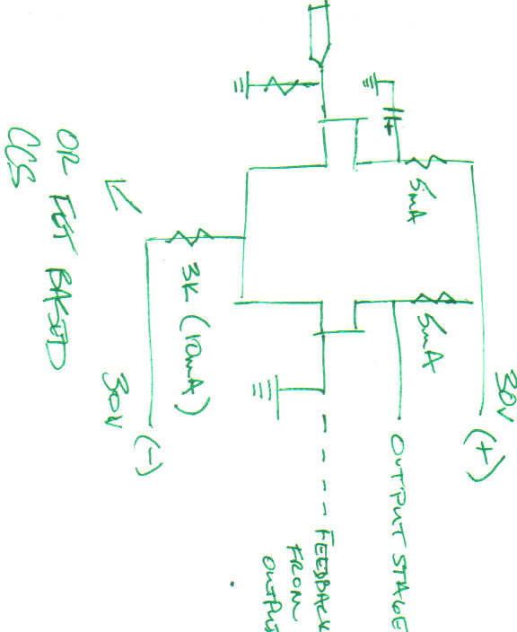

Thank you Nelson. I do not have the fets for the J2, but hope to explore the topology for a higher power SE amp. I want to play with both mu and cascode setup from F3 perhaps combining the two. Hope to get Fets for J2 after exploration of this amp. Interesting how Broskie moves through the possibilities of the mu follower being possibly PP or SE.
Any opinions on this vs the cascode input of F3? It deals with capacitance issues as well as allwoing for convenient place for feedback. unsure of how much tweaking can be done in comparison to cascode.
Limited understanding of F3 cascode benfits include, protection for sensitive device, no Miller effect, increased control of primary transistor (LU Jfet), modulation per Papa's discovery. This schematic provides most of that with exception of protection and control. Possible added benefit is non inverted output which could be taken advantage of in feedback. Protecton is not needed if SS parts used

SRPP. It would be really interesting if there was someway to have a control mechanism that allowed it to be switched from SE w/CS to SRPP P/P. Tube Cad is the best place to read up on it all. If i can get away from the 4 kids, i am eventually goin to try it. Need to get Juli@ card and PC based distrtion software. Nelson has already given us a great deal to work with.

I'm up with a J2 clone. I'm still not happy with the bias and the 6 legged creature. I just don't have enough experience to fiddle with it. I've already blown a FET trying to play - an expensive mistake.
Is there a place to connect the six legged bug with the CCS? I'd welcome reading or a lesson.
Can an input trafo be used in place of a differential pair in a susy application? There is no current sharing at the input of the trafo, so how would the error signal be passed or shared? Would it be possible to use a feedback network to bring opposing signal back to input of transformer and would this work in the same way as the susy concept.
What 6 legged creature are you using?
I ended up with a CNY17-4. I tried a few others, they did not get me where I wanted to go. I have not measured the direct quiescent current, the last time I tired, I blew an output - an expensive mistake. I measured the resistors to the CCS and found the current to the gate of the CCS. I'd like to directly measure the current if anyone can suggest a method that will preserve my outputs.
NYCOne,
How about PM ing me a schematic. I know it is not working, but i would know what you are looking at instead of theorizing. Setting up an PP SRPP or SE Mu follower is easier with depletion mode fets for me because of all the tube circuits out there for help. Using enhancement mode stuff adds certain complexities in the bias area. I have realized this in tryin to come up with schematic with 085 on bottom, with 240 on top. Nelson does call the J2 a Mu follower, and from what little i have read, this is more towards the SE side of things. THis could be all semantics and unimportant, just a thought. He said of his graph earlier, that the r085 did not show any similar device synergy and that using a 240 was feasible, perhaps it is different for the R100's you have.
