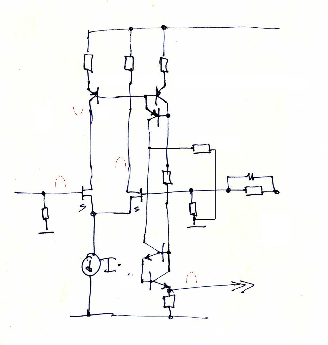

ZM, you mind putting the cute little AC signals in appropriate places so ican get my head around this thing.
same way as in pretty well known Aleph input stage
look at pic .

ZM, I thought we were trying to do a simple Pass like design with all N devices?
don't ask me - I just wrote what I thought , then buzz buzzes me to sketch
besides that - you know that I'm talented only for over-complicating Papa's ideas 😀

So, just like in the aleph cs, the .66V is divided by resistor to set bias. You are just using two bipolars instead of bi/mos combo?
input LTP current is set by CCS ( that one drawn as circle with arrow)
resistors in emiters of bjts are there to set needed ratio of currents through adjacent verticals of Current Mirror
so - that way you can have greater current through right half of current mirror than through left .
me likeee more current

Thanks for the explantion. Missed the cs at bottom of LTP. Too busy looking at all those bipolars.

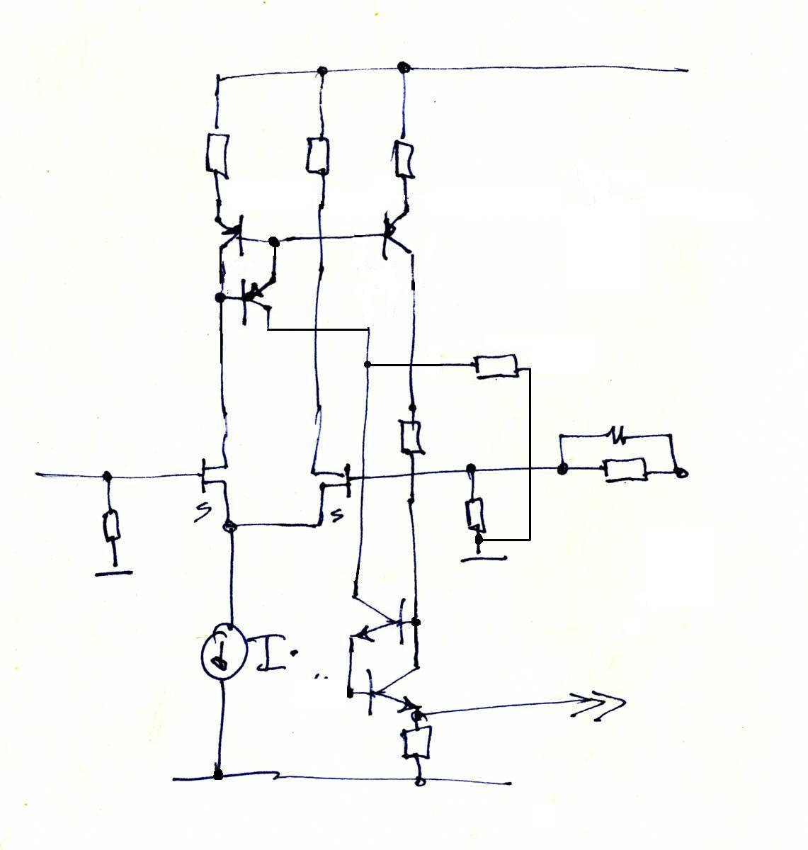

Is bipolar at top of LTP providing only V gain, being common base? Top pair of bipolars in cs to bottom pair which form cascoded source follower. I need to look up current mirrors. My head hurts. Where's my De Lite schematic, I need to rest.😀
well - that's just mishmash - rough sketch
it can be simplified , or complicated further ; it even doesn't contain important part instead that resistor in middle - it needs proper voltage "accordion" for that right part of current mirror .
be aware that I don't have formal education in electronic ;result is that I'm sometimes overenthusiastic ........ at least as long I check things in reality

Is there a disadvatage to having a different transistor type for the ccs? For example, having an IRF240 as cs with SS on the bottom. Are ther thermal issues that would affect performance?
Either? I realize that using R085 as CS is difficult, so whether mu follower or Aleph, I will have to use something else. Just didn't know advantages or disadvantages. As FLG said, Pass suggested in J2 article that Mu follwer was better for use with R100'S over Aleph, but SS with ALeph isn't really new design.
seems that , for serious conversation , one ( or we
) need to decide which part(s) and which concept to use
depletion or enhanced , Aleph CCS or ( as Papa sez ) Mu Follower ......
some of these are mutually exclusive , or just too complicated to realize .
if going for Aleph -like input stage - why using depletion output , and need for additionall small CCS and helper (more) negative leg ....
